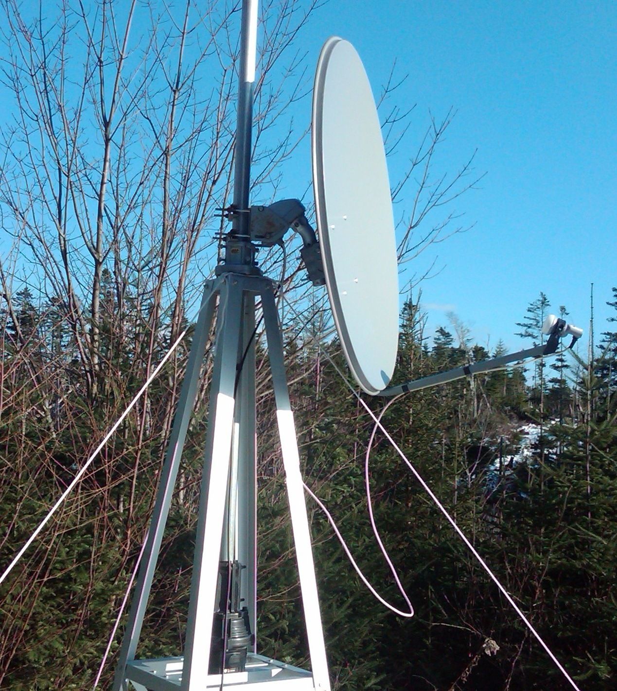

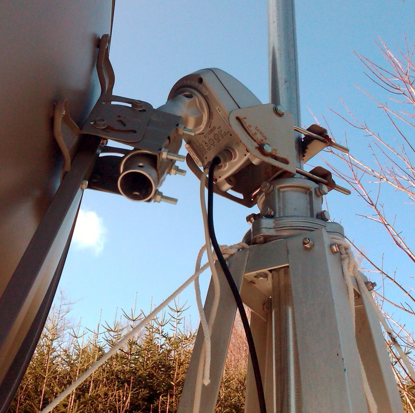

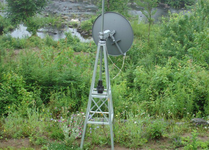

I am still moving my mini-tower around my heavily treed property. Although I can now receive 15W through 121W with my motor, my goal is to have visibility to 15W through 125W. The azimuth rotator inside the tower is not used but, I thought in theory, I could simply move the tower to any new location, touch up the due south azimuth with the azimuth rotator, then do orientation in the normal FTA manner using the H-H rotator on the back of the dish.

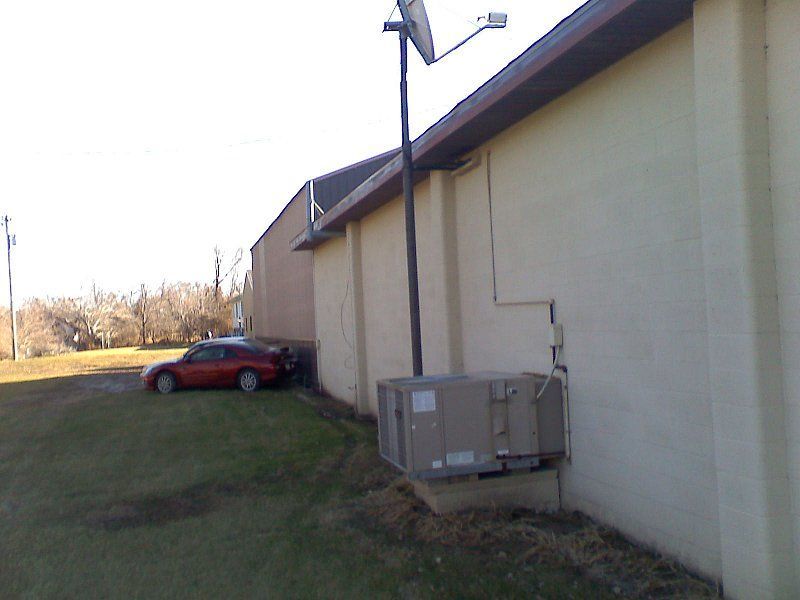

Number 8...Just couldn't resist another dish as I saw another Prodelin dish and decided yesterday that having an odd number of dishes just wasn't going to work so today I went out and talked to the people at an old Ford dealer about removing the dish and pole. I will get it down tomorrow as the weather is supposed to be in the fifties. So now I'll be able to set each Prodelin dish to cover a given section of the arc and with multiple LNBF's and some switches cover all the needed KU satellites

Here's a picture of the dish being removed today. Hopefully the ground where I want to install the dish and pole is dry enough for me to dig the hole.

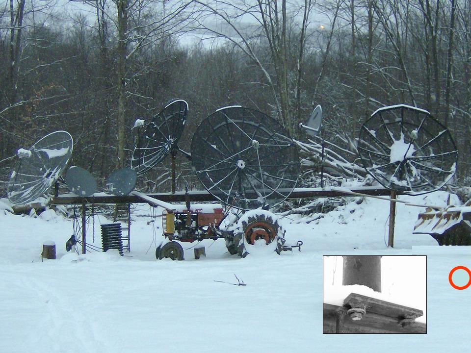

my project
This is the project i have been working on.
I-beam with (3) tripod style lampost mounts. Special bracketing for moving dishes up or down the beam.
The beam is 40 ft long with braces welded and is bolted to the poles by brackets welded to the poles.
Completely disassemble-able in case i hate it later. The weather did not hold so the conduits are not complete.
We are fortunate to have very little wind in this valley/mountain north side hill.
Where the red circle is on the pic is where the permanent BUD will go and it will have the motor hooked up. again, the weather stopped me there but the hole is dug for it.
The rest of the BUDs are on mounts and north oriented so i can change Birds manually (battery) if desired. I did not put all the actuators back on them. at least one has a hand crank. Even the Darkstar is working well. it stringlined as the most True BUD so i gave it a go. Slowly getting it all wired too. 2 of the 3 are ready.
currently full time ku- 30w, 87w, 97w, 125w. Expandable still, just undecided.
and c-band- 40.5w,43w,55w,87w,91w,99w,103w, C-band rules man!
All Bandstacked. Tron, I followed your lead here. works good.
Ku - Crimestars, C-band- 7.5perfect 10, 8ft unimesh, 10ft unimesh, 10 ft darkstar.
i dont have 105w...yet, and 58w is currently winning the argument and not coming in. the DN dish is on the house still as it isnt bothering anybody too much there (wife) yet. But the dishes are out of the front yard and into a special location at the bottom of the back yard which is still under construction also - even the grass hasnt come in yet.
I wasnt going to post this pic but there is a Gas Well flaring in the background about horizon level. The thng lights up the whole valley at night. It is just a point of interest. I also signed a gas lease so i hope to retire soon . The new gas line passes 200 ft from my property line.

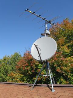

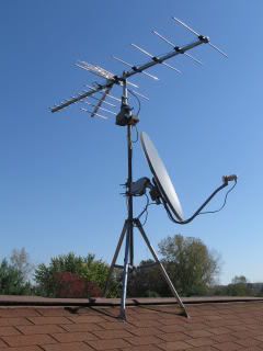

I have one motorized Ku dish with my OTA antenna mounted at the top of the pole. It's worked well since I installed it last summer. The tripod legs are screwed into the roof trusses. I drilled a hole through the pole and threaded a bolt through to prevent rotation. The tripod mast is a bit flimsy though and rotates a bit back and forth when the wind hits the dish.
So far, the dish has withstood about 55 mph winds with no movement. Although It worries me every time the big wind gusts come in.
View attachment 73613View attachment 73614
That's a pretty nifty setup there.. :) I like the all in one setup.
It looks like your OTA antenna has a motor too? I need to get a motor for my OTA antenna too.

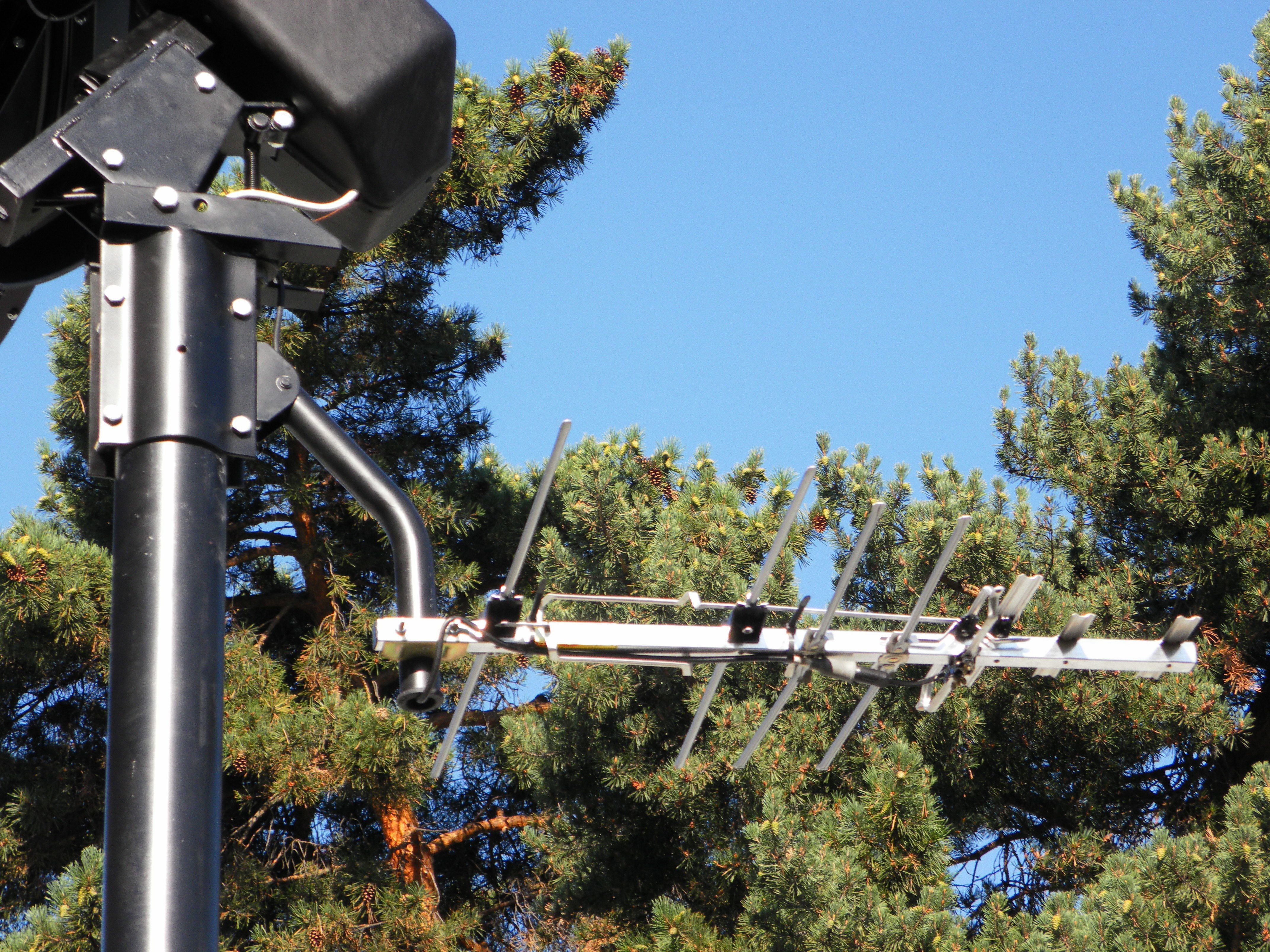

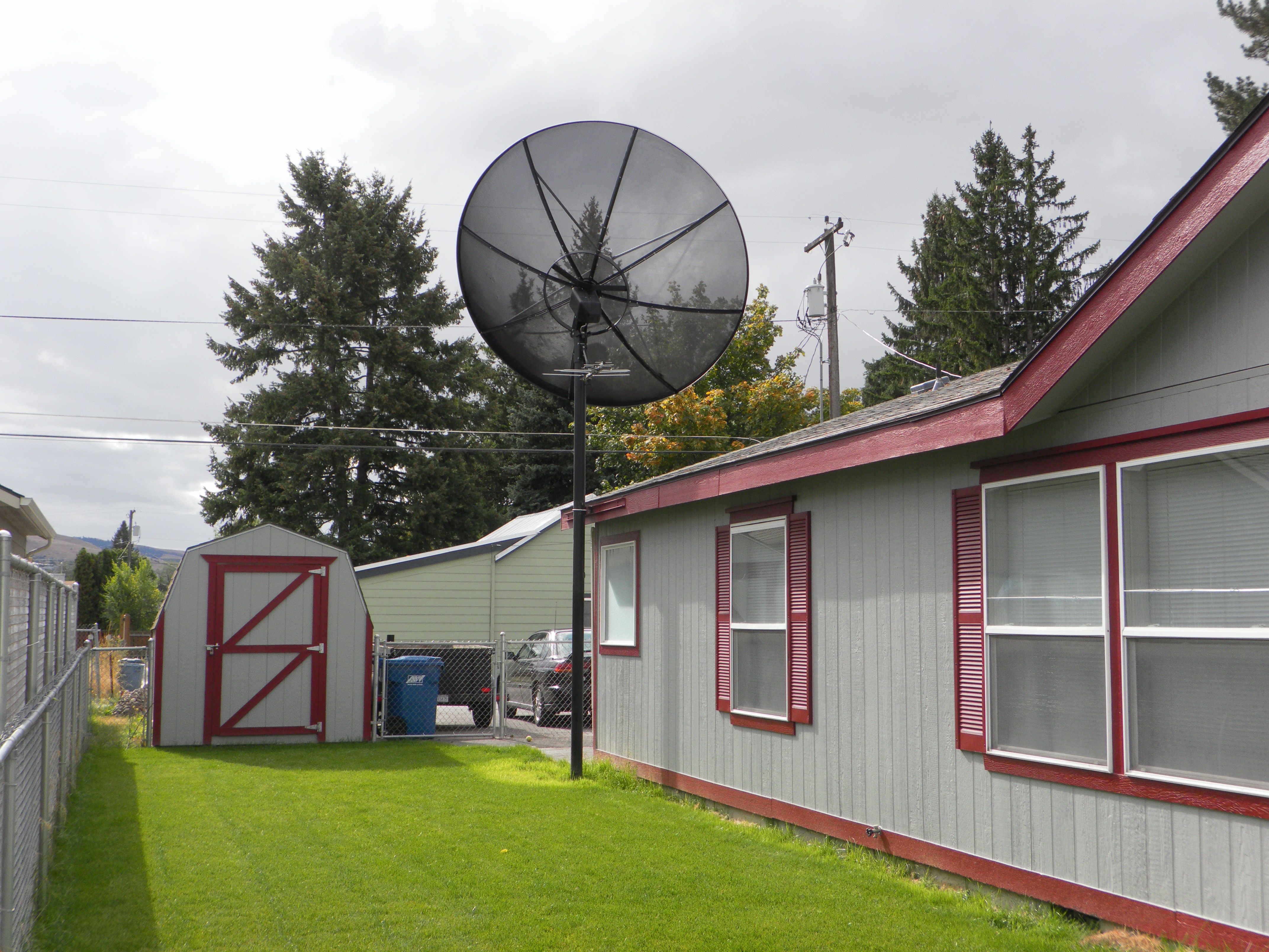

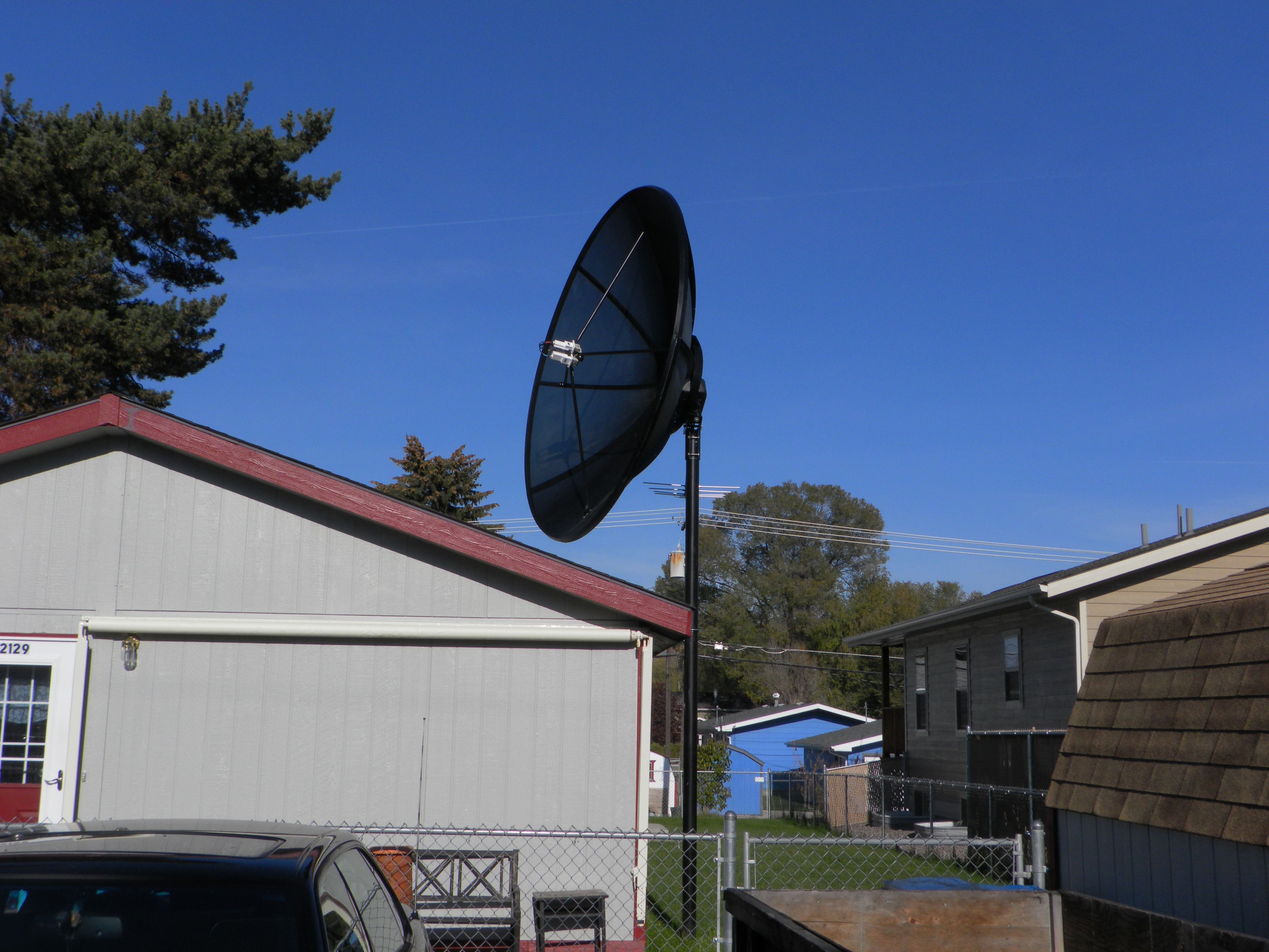

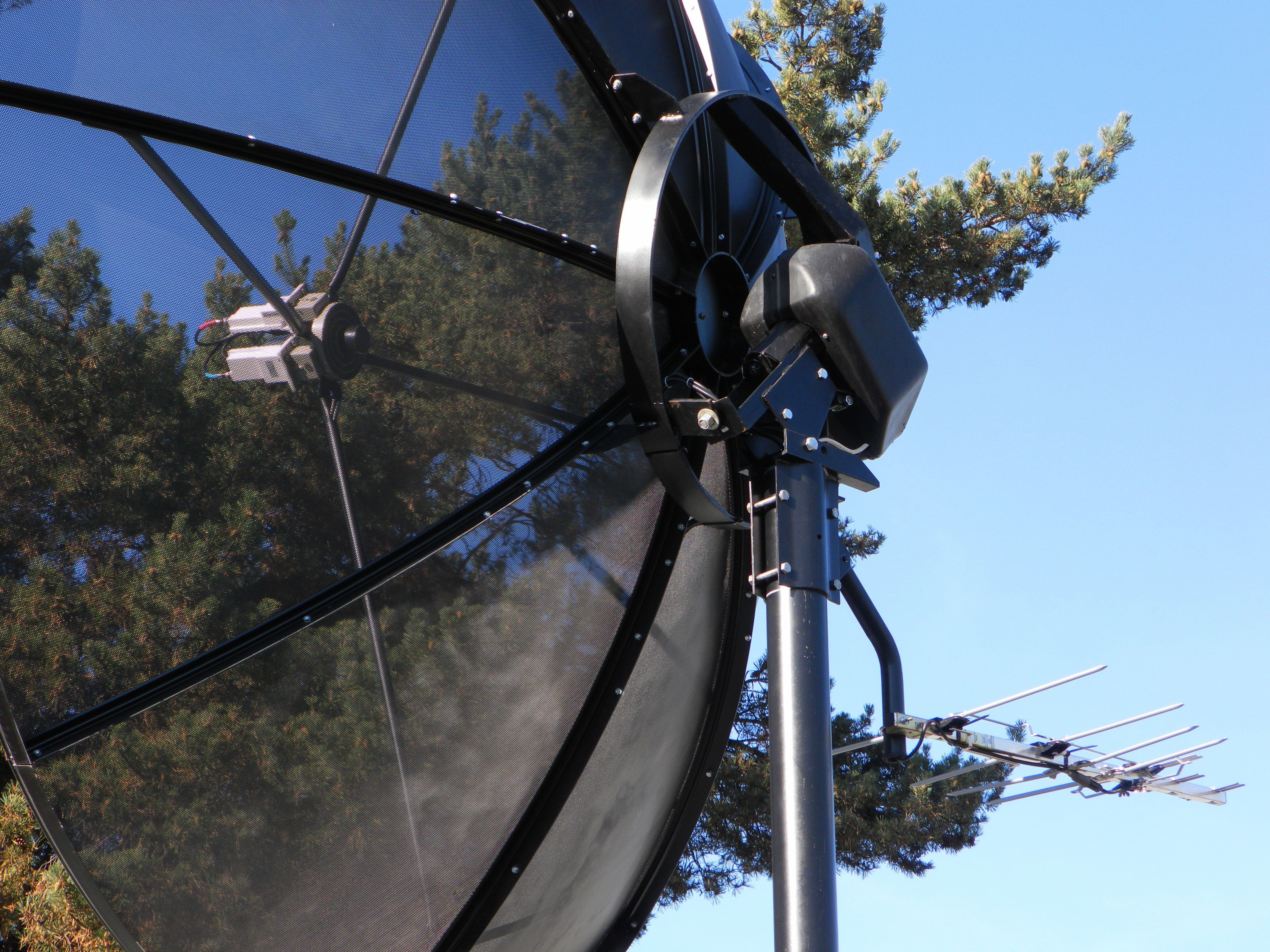

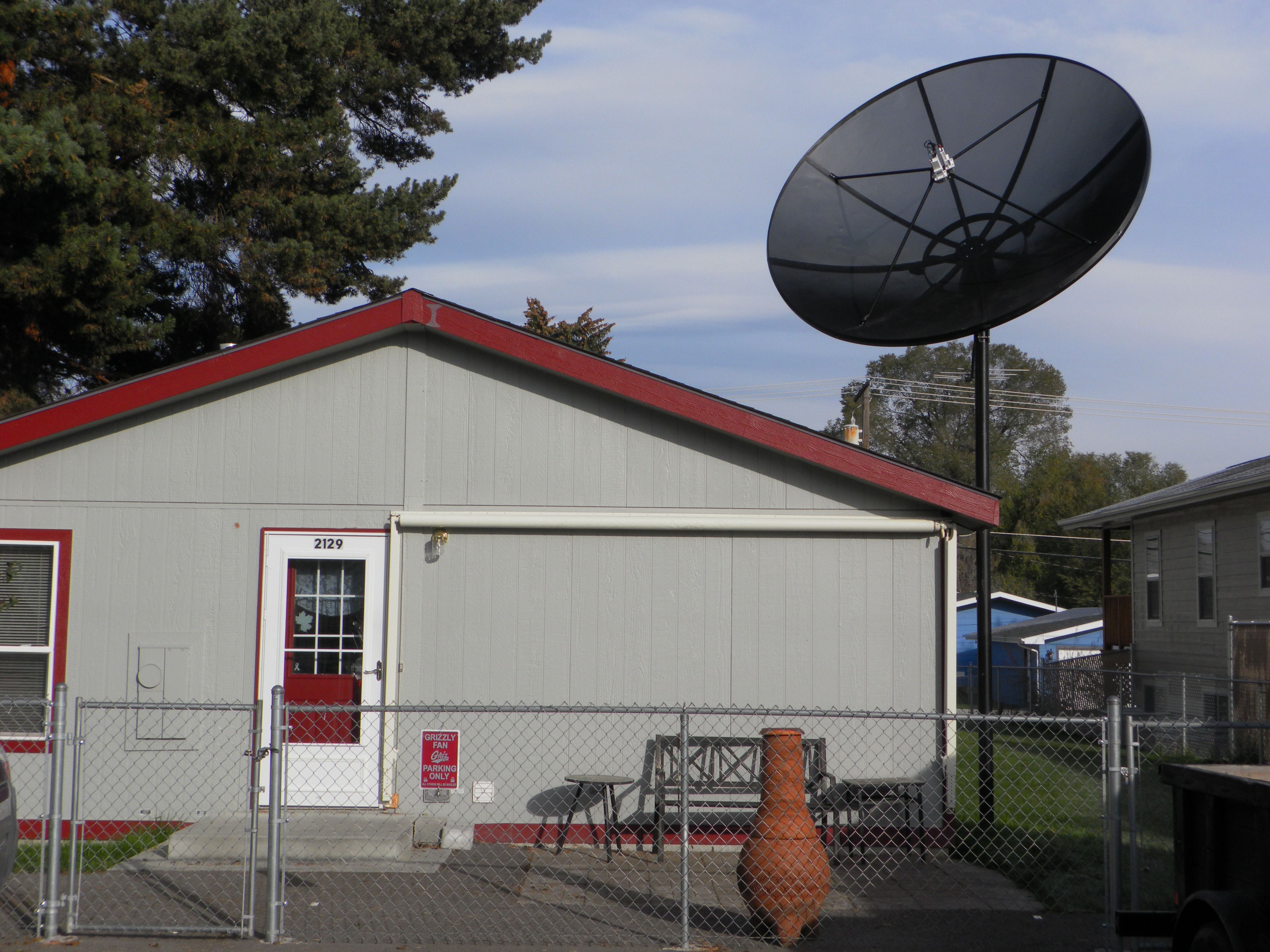

The Multi-band OTARD. A few recent pics of my latest dish setup.
Very nice!!! :cool:
I have never run across a H2H motor yet! Neat OTA mount too!
I was wondering where is the 30" Winegard and the 6' WSI special that is in your signature? How do you get around those darn OTARD rules with those neighbors so close by?
Very nice!!! :cool:
Well this is Montana, and even though I'm in the middle of this valley surrounded by the city, 15 years ago we didn't have paved streets and this was county property. Still surrounded by city property then. HOAs have not been developed here and the neighborhood council likes it that way :) Nobody wants to start finger pointing here as we all live in glass houses ;) I didn't have neighbors to the east untill a year ago.
Except Dish has been canceled and the dish removed. I have a 10' mesh lined up to replace the WSI 6' special when the weather permits.
