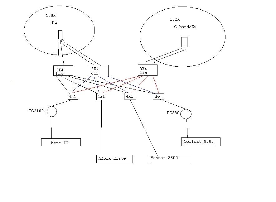

The 2800 is setup as the blindscanner for my 1.2M dish ( CS8000 driving the motor) . I'm liking the functionality of this new setup ! :)
