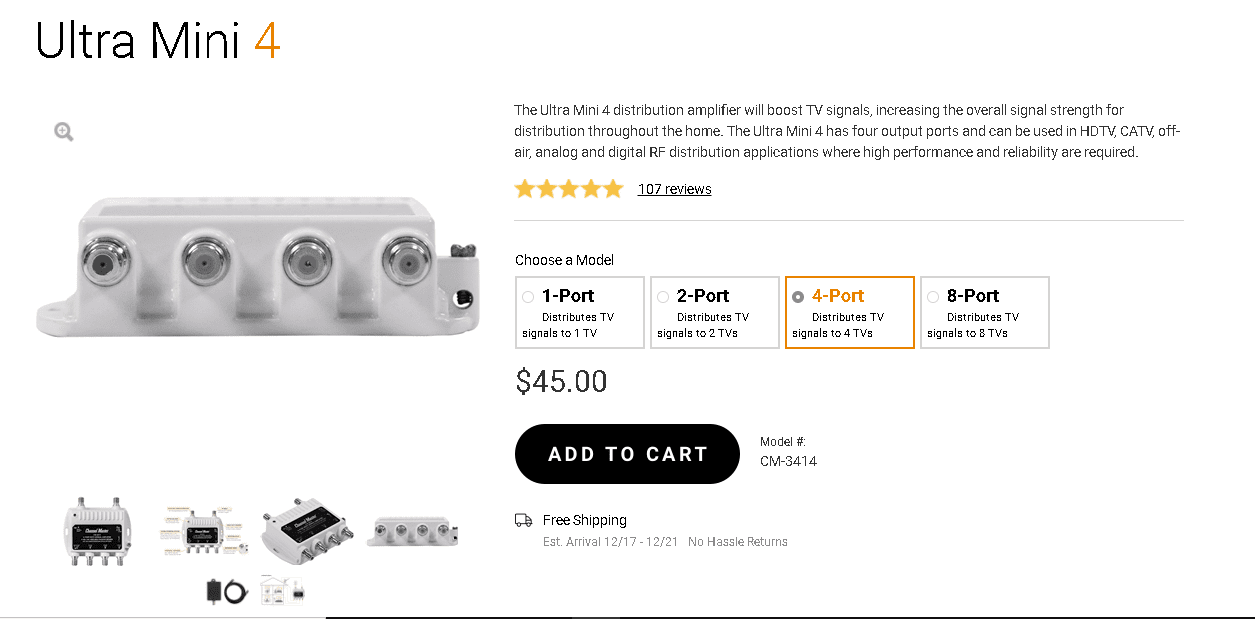

Hello navychop; I checked channelmaster's web site. Perhaps, a product like this could help.
