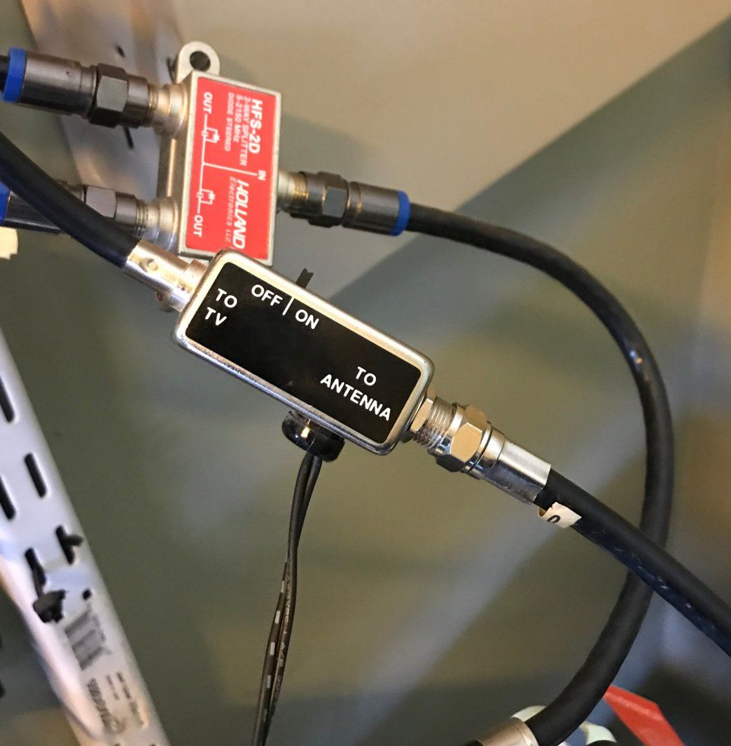

My assumption (which was wrong!) regarding Terk55 in the attic was that it wasn't preamp. I assumed the antenna should use external power to be considered preamp or amplified. Some good folks here corrected me. The coax comes from antenna to the home run and is attached to a power injector. this power injector is wired to a power plug.
My experiment with different connections to airtv adapter failed. I am making wild assumption here. The antenna (terk 55) was installed 18 yrs ago before we switched from analog to digital. So, does it mean that antenna is obsolete now? I am determined to see this as a challenge and will keep pushing it!
Here's the pic of terk55 power injector (located in the homerun room, not where the antenna is). The power cord is visible underneath.

Yes, I took the coax from injector and attached to airtv tuner. Without preamp capability, I got nothing. Everything I thought of and tried resulted with zero!.

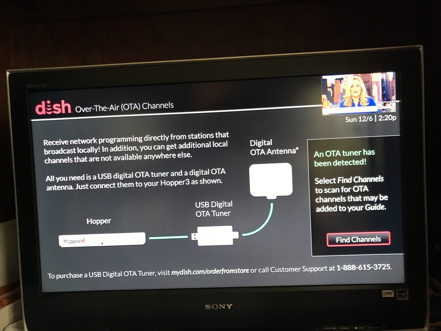

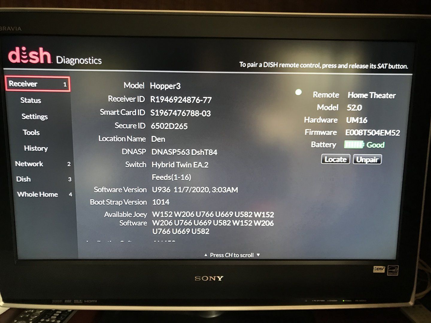

I attempted again today with all 3 usb ports. Settings show that OTA tuner has been detected when I insert the airtv tuner. But, scanning does nothing. I tried to do something. Turned Hopper 3 off, pulled the tuner out of usb. after turning Hopper on, went to settings/ota channels. I noticed exactly the same message "An OTA Tuner has been detected."
Now, why is Hopper showing that when tuner is not attached? Or, does it mean that Hopper has the capability to be able to scan for OTA channels after inserting tuner?
Hopper 3 software version is U936. Do I need to call Dish cust. service to have them reset my system for any reason?

No don't call DISH. You have been trying this and that so much that Hopper is probably confused at the moment. Simply unplug the Hopper from AC power for a minute and then plug it back in. That should clear the anomaly.

I received the barrel connectors from Amazon and did the following with a pleasant outcome (:clapping)
Remember the Terk 55 antenna has power injector where the coax cable ends. So, I connected a barell connector to the short cable coming from this injector. Then, an RG6 cable (spare cable from a box) to the barrel con. And the other end of this RG6 cable was inserted to an antenna input on a tv ( I brought from kitchen). I used the tv's (Vizio) scan feature. I couldn't believe tv found 43 stations!!.
I checked all of them. (The lowest number 5, the highest 67. Stations NBC 5.1 and 5.2 r coming from Cincinnati, 70 mile distance!) All networks and PBS from Lexington,KY (the closest market to me) and sub channels were available. Sure, some r 480i, some cropped. But vast majority are watchable. Even Fox looked realy good. Weird. It was the worst 18 yrs ago. for some reason CBS (WKYT-27) and its subs r slightly pixilated, but the sound is fine.
Not counting 3 shopping stations and 4 public tv stations (same, coming from different transmitters) I am able to get 36 stations. To be honest, I was shocked.
