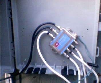

Slick, here is another picture. I have labeled the connections so it would be easier to tell wich one is which:

When I diplexor is used there are two pieces involved. One that combines the two cables and one that seperates them. The pic Technut posted is the one that seperates them(the little grey moto box). This is what combines them:

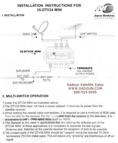

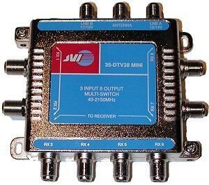

Tech nut tell me what the diffrece between a Diplexor and a multi switch? I look at your site and what yo are calling a multi switch I thought was a diplexor..
A diplexer combines two signals into a single coax wire. It can be satellite and cable, satellite and OTA, satellite and cable internet, or whatever. But it can't be more than two signals. The Winegard diplexer used by voom installers is a 3 in 2 out diplexer, it combines the antenna signal with the two satellite inputs, and sends them out the two outputs. It also allows DC voltage coming up the line to pass to both the LNB and to the OTA. The multiswitches diplex the signal but also split the combined signal into 4 or 8 outputs.

Correction... "installs inc used a multi switch to combine and then distribute mine"
yeah what wasch said, what about a multiswitch that will work with VOOM, any recommondations, do the multiswitch and diplexers need to all match (maker). and which ones are being used on "working OTA" voom setups. What hardware for this combining and spliting does voom recommend?
