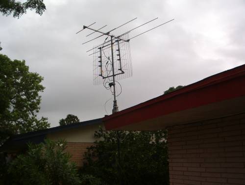

IceMan5043 is correct. Also, since I live in Corpus Christi (The STYX) and have only 4 HD channels :( I have to try and get all the analog OTA channels as well. So I pick up about 17 OTA channels. Screw Cable :D :p
Cheers
Heres a pic of it :) Sorry about the overcast as it looks like we're going to have our first good rain after a long drought. :)

bsr, cannot see the attachment, can you please resend or email to me.
