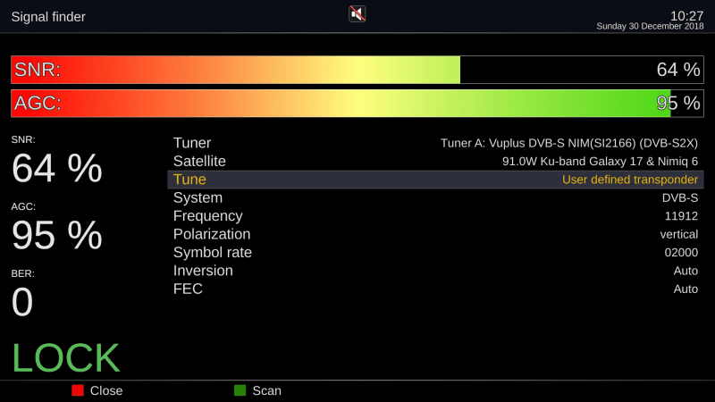

It's been said on the legitfta forum that the OS mio 4K will do the NPR MUX on 91W if the satdreamgr image is used. For some reason I am unable to lock on the transponder so I cannot test.
The VU+Zero4K will lock onto the transponder as above, however on the OS mio 4K there is no indication of the transponder at all...not even a blip. The VU did not find the transponder during blindscan, I had to add it manually. Tried adding manually to the OS mio and there was nothing.
I am using OpenPLi 7.0RC on the VU+ and satdreamgr 6.2 on the OS mio.

Found that I had to adjust the frequency of the NPR transponder to 11908 in order for the mio to lock on it. Once locked I was able to scan in all NPR channels and a few of them were active. So yes Virginia, the mio does work with the satdreamgr image for the NPR Mux!
