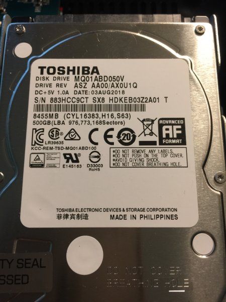

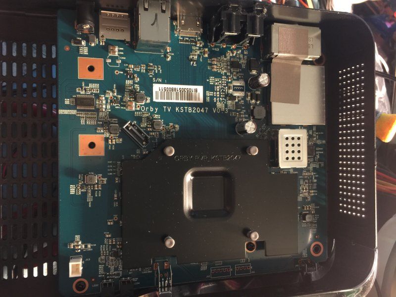

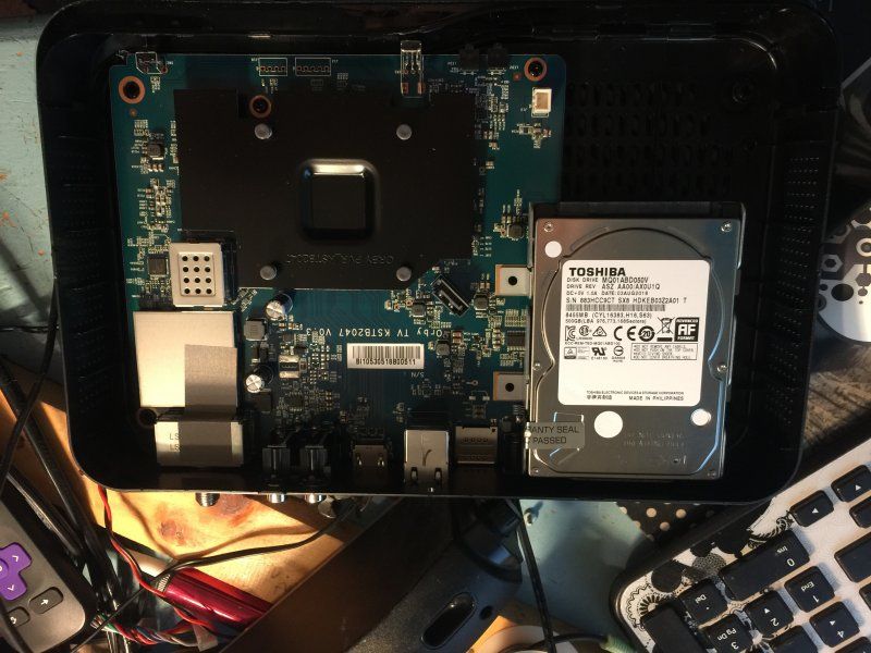

well here the pictures i said i would take for yous. so it looks like the hard drive only runs on 5 volts and also the hard drive can be upgraded to a 1TB for around $41 or so. ill have to buy and test that and will get around to doing that for yous. if anyone wants or would like to know let me know and ill buy and install and test. if anyone else wants to know anything else let me know thanks

I would be tempted to yank that Toshiba for a WD blue or black. The vast majority of drive problems I've dealt with for folks over the past few years have been those Toshiba drives.

Based on what I'm seeing it appears there is only one receiver and the DVR is simply a harddrive added into that box. That sound right? Does that mean it's possible to install your own drive?
I'd expect some firmware differences between the two receivers...
I would expect not. Maintaining multiple firmwares for essentially identical hardware (plus or minus mass storage) is fraught with a danger of "forking" where the fundamental software may diverge.
Most of the cheap TV tuners that have DVR features don't require different firmware if mass storage is connected (be it hard disks or flash drives) so I would expect a similar situation in satellite receivers.

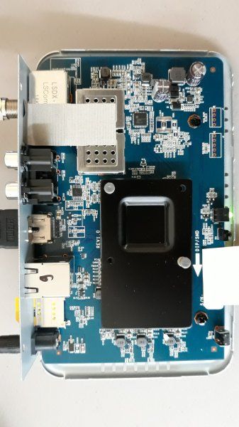

My Non DVR ORBY TV receiver is completely different. Maybe 3 models in distribution? Note that mine does not have ORBY printed on the PCB. Likely an earlier hardware version? See attached photo.
Model: KSTB2095
