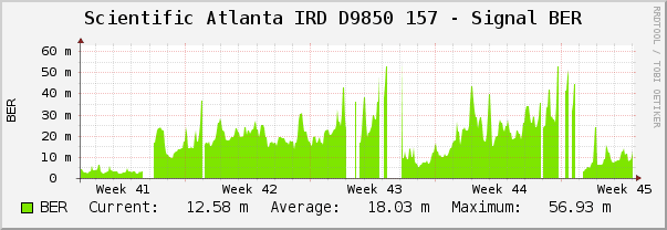

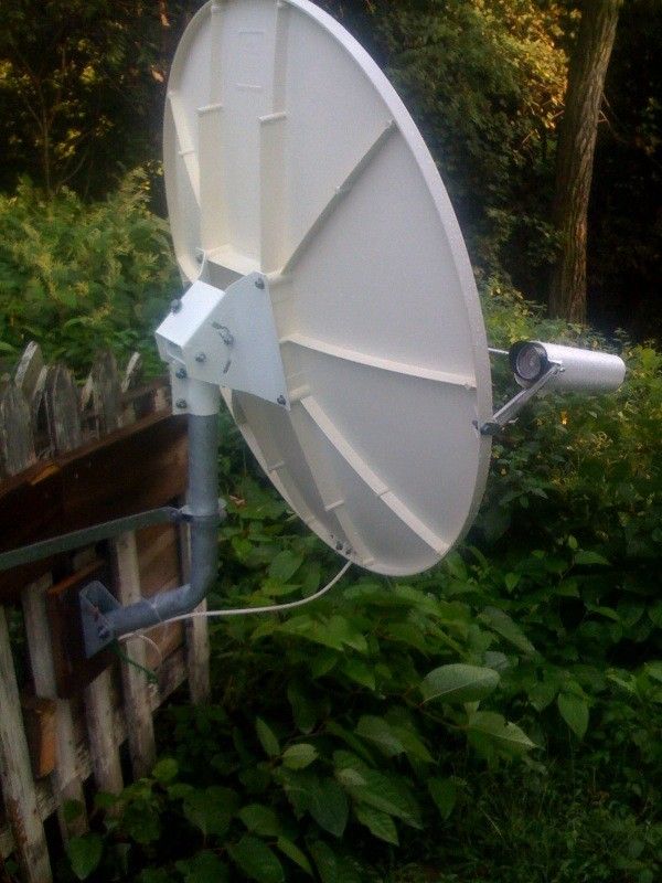

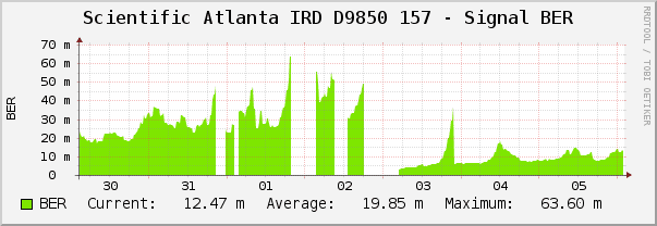

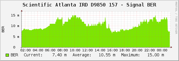

The trouble everyone has with 12140V is caused by that damn Hughesnet 12140V 30000 transponder at 127W. The only solution to this problem is a bigger dish. All I watch are the HD feeds on 12140V. I have a 90cm Prodelin and 12140V comes in weaker than others like 12104V and 12180V, but I am able to get it for the most part. The only time I lose it is when the picket fence the dish is mounted on moves slightly and knocks it out of alignment. Attached are BER graphs from a Sci Atl D9850. The areas with no data are when the IRD would return 0 because it lost lock completely. Between the 2nd and 3rd was when I repeaked it from when the picket fence moved slightly. The data for around "week 41" is when the IRD was tuned to the QVC digital multiplex on AMC11. Also attached is the picket fence I have it mounted on. It's not sturdy, so I have to push or pull it slightly and also shim one of the pickets with rocks to get it just right. Talk about ghetto!
Jonathan
awesome pic :)
(and whats wrong with ghetto)?? ;)

The trouble everyone has with 12140V is caused by that damn Hughesnet 12140V 30000 transponder at 127W. The only solution to this problem is a bigger dish. All I watch are the HD feeds on 12140V. I have a 90cm Prodelin and 12140V comes in weaker than others like 12104V and 12180V, but I am able to get it for the most part. The only time I lose it is when the picket fence the dish is mounted on moves slightly and knocks it out of alignment. Attached are BER graphs from a Sci Atl D9850. ....
I missed this the last time, but those BER graphs are excellent! Considering that they were generated from RRDtool, they must come from data over the ethernet network from that receiver. That's the difference between professional gear and the consumer stuff I own.... I wonder... Does the Azbox do this too? Don't believe it has a SNMP service....
