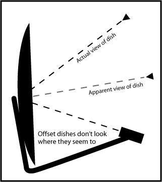

The actual position that the sats hit the dish is HIGHER than the angle of the LNB arm, so that may help some too.
So, you are saying if the dish is pointed at trees, the signal may actually be coming from above the trees? That would explain some nearby dishes that appear to be pointed right at trees.
That is correct; OEM DBS dishes are of the off-set dish variety.
