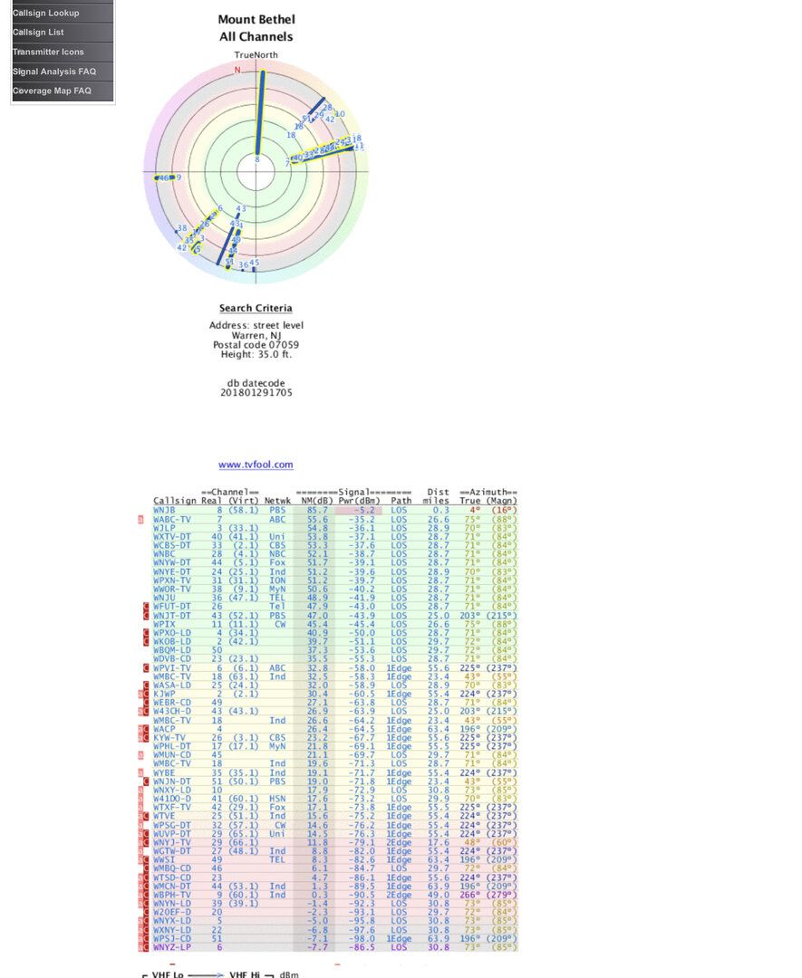

I am now live on rabbitears.info. My first effort. I am using a Pi 4 w HDhomerun.
The antenna is an Amazon China Five Star, soon to be replaced by Winegard HD7694P fed by 35’ RG6. Antenna up about 25’ and location about 400 MSL with no trees. Aimed at 200 degrees. No mast mount preamp.
I would be grateful for any feedback and or suggestions. Link and TVfool pic. Thanks!
