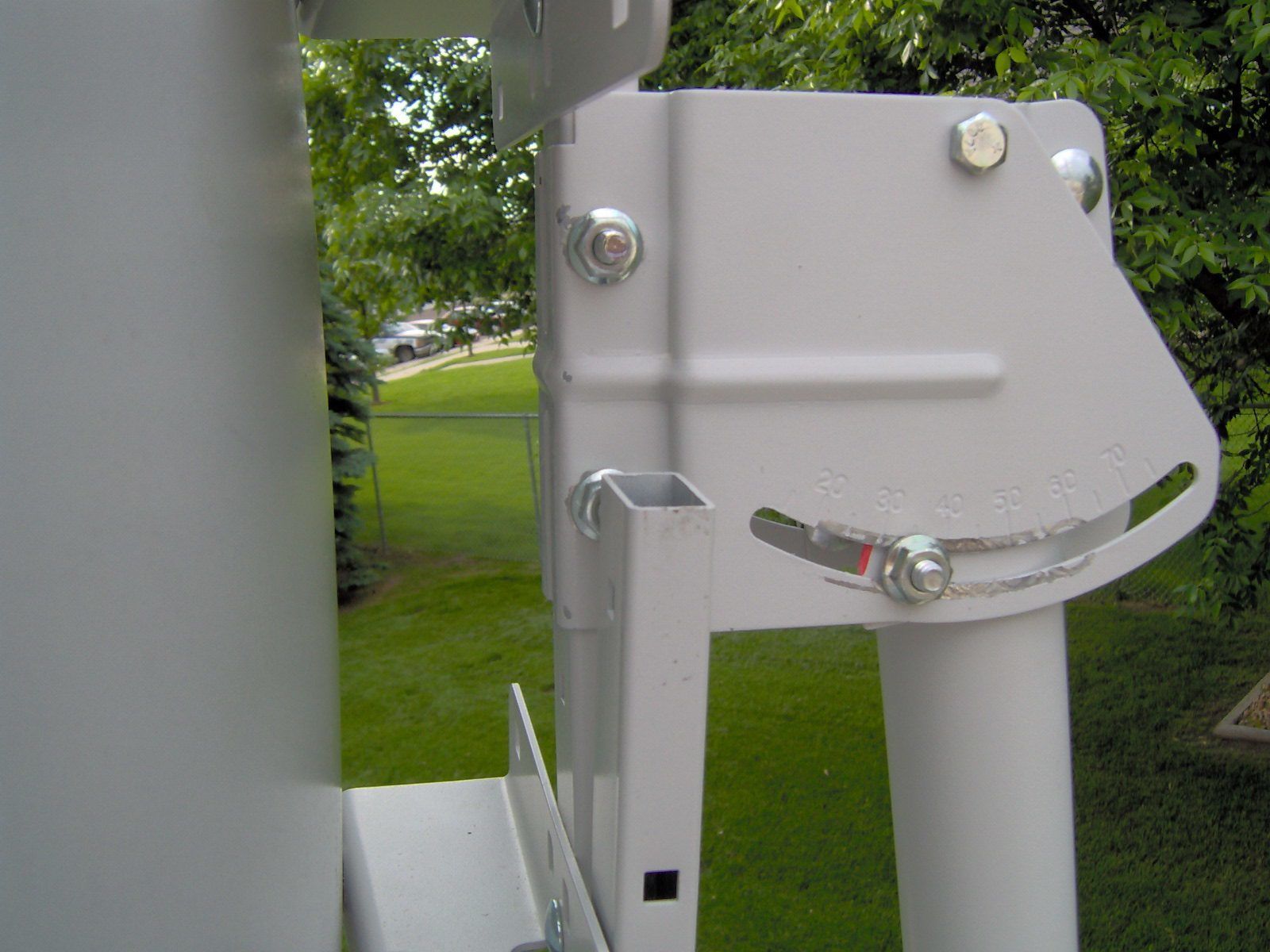

I understand wha t everybody is telling me, but I still cannot figure out how to get the correct elevation correct. I cannot find the marks or a picture of the fortec dish with the proper adjustment marks.
on the 36" dish there should be a red line on the one side. Line it up with that. If there is no red line then use the edge (where the red line should be)
otherwise try a power scan to see if you pick up ANYTHINIG (even if it isn't T5/IA5/G25/G19)

Hey Ice thanks got that taken care of. I must have moved the dish to every possible direction there is from East to West and leaving the dish in that position for some time with no better quality. Has me stumped. I realized that scanning will not help if there is no signal including power scanning.
