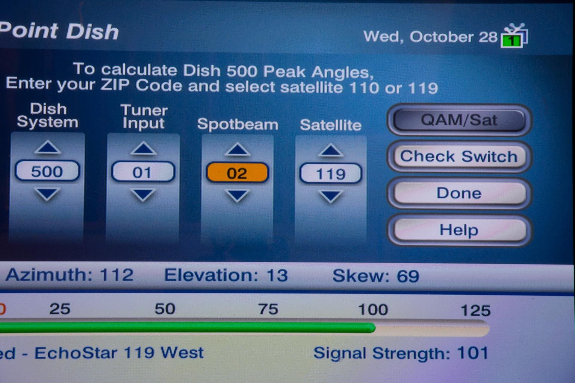

So I am pulling higher signals on my old 722k than I get on my new 211z, a couple transponders on 119W have 100 or 101 signals.

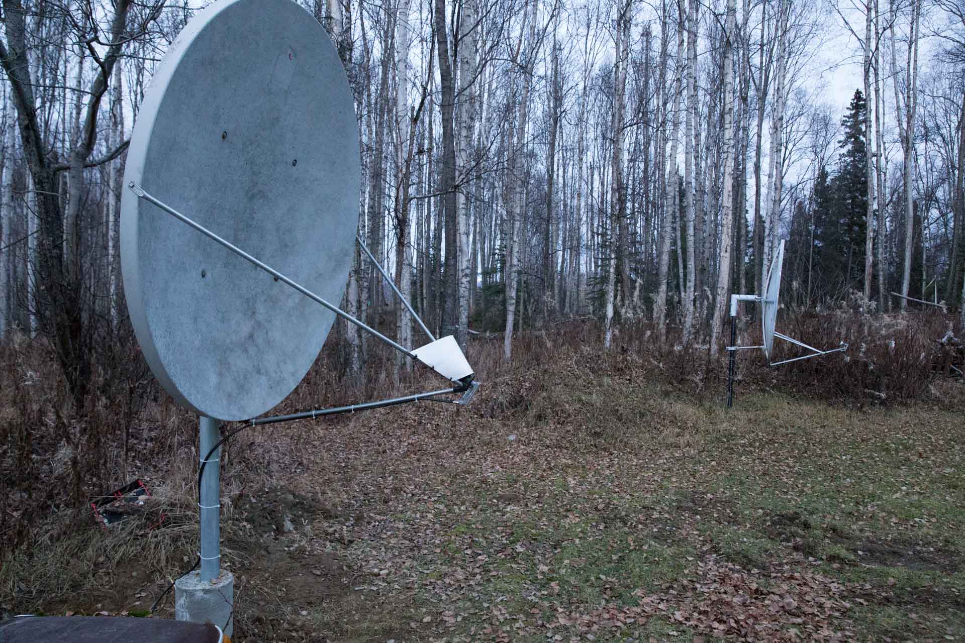

Here are the two six footer dishes, one on 119W and one on 129W. My mom lives a couple lots away and is hooked into both dishes on about 150 feet of RG6 each. She is getting high 90's on the same transponders.
We also have a 1 meter dish on the empty lot between our lots, pointed at 119W (but now retired in favor of the six footer) It still has an offset LNA for 110W. I'll eventually point the small dish right at 110.
Eventually I'd like to have a triple-LNA beam out front of one of the six footers and call it good for all three satellites.

So is that a true thing, that the 722 receivers are more sensitive than the 211z? Are the latest dish products even more advanced with better signal processing?
