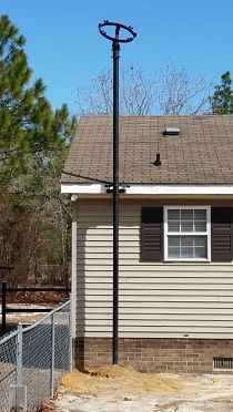

Got the pole up this past weekend. I checked prices on renting a 20 foot A-frame ladder, wasn't to bad of a price. 35 dollars a day. And to buy one it's about 800 usd. Got lucky, my wife work has a 20 foot A-Frame ladder i used. I can use it anytime i need it. I got 500 pounds of concrete around it.

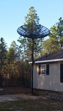

Well guys, Got the dish up today. Me and the step son put it together on the roof of deck. it was more level with a small pitch. We carefully walked it over to pole and leaned it up against the pole. I then extended the 40 foot ladder and had son push up while i pulled up and got one bolt in the mount. Then the rest went easy. Got the motor and coax wires on it. Ran the coax to back deck to tv and link box.Then turned the dish left and right until i hit 83 west my true south satellite. I hit 90 percent quality and 84 percent signal within 10 minutes. Before i took down from other home i parked it on 83 west. All i got to do is run wires to my bedroom tv. and zip tie the wires to pole.
