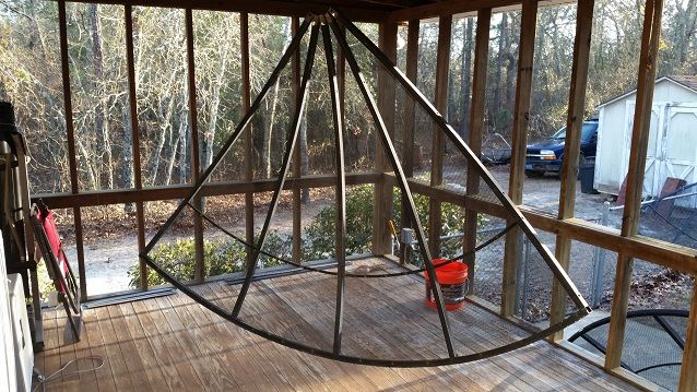

Weather was nice in SC this afternoon, Got up to 60 degrees. I got one coat painted, on one of the four pannels. This pic was before the paint. Suppose to be 72 degrees tomorrow and 76 Sunday. I should get other three pannels bye Sunday.
