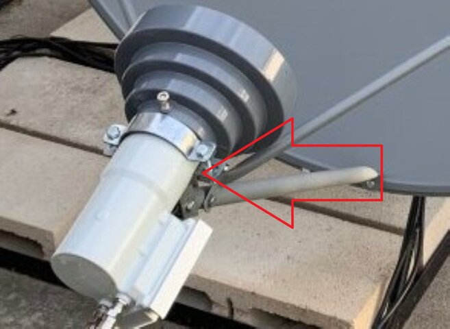

Why is the dish rotated?
Is that the correct LNB bracket from SatelliteAV?
It's on a polar mount, yet it's an offset dish. So.... if it's not pointed true South, the face of it is going to look "rotated" depending on which satellite he's presently pointed at.
