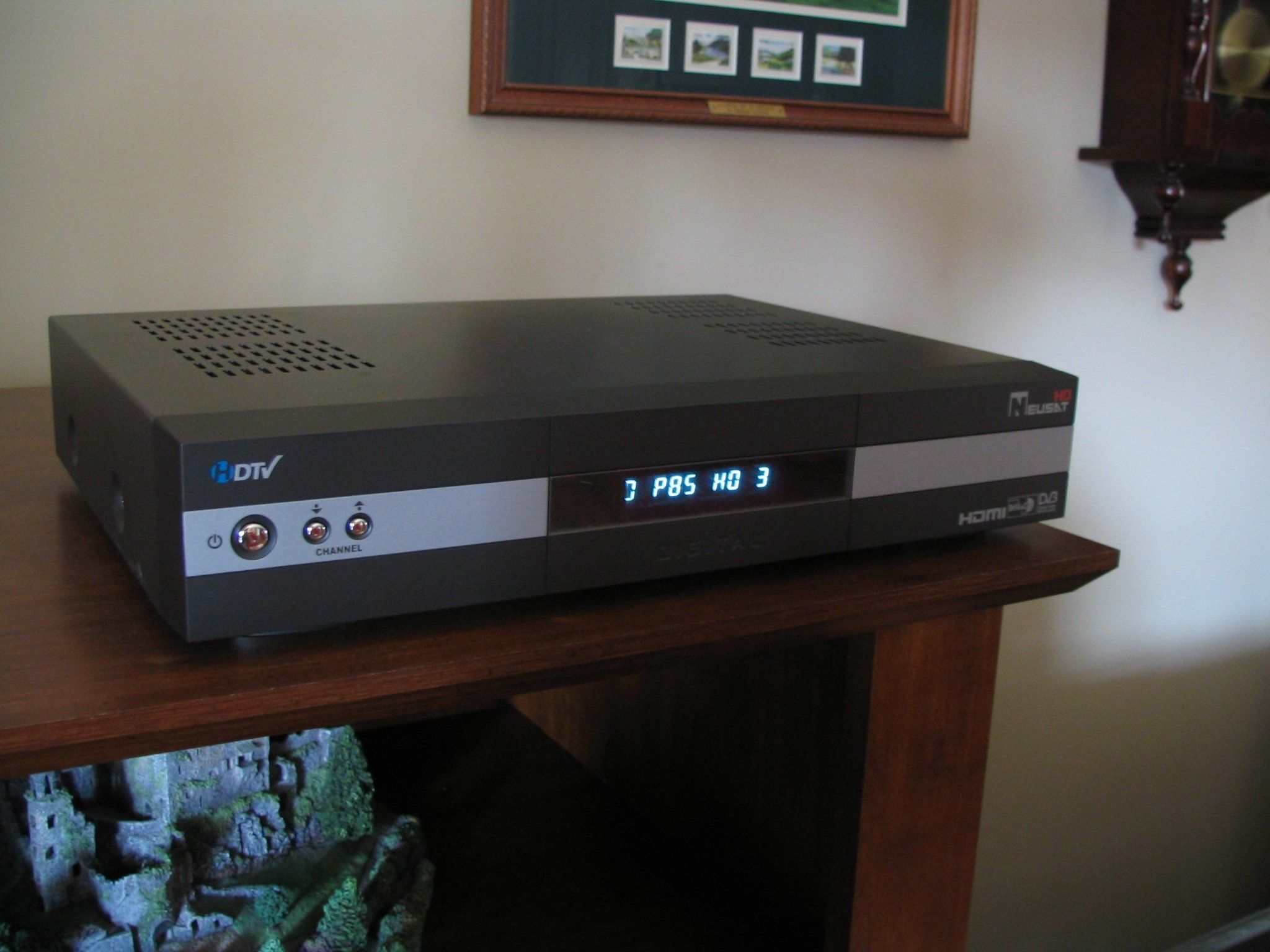

Appearance
The receiver is black with metallic trim and a blue vacuum fluorescent Display on the front panel. It looks very nice side-by-side with most home theater equipment.

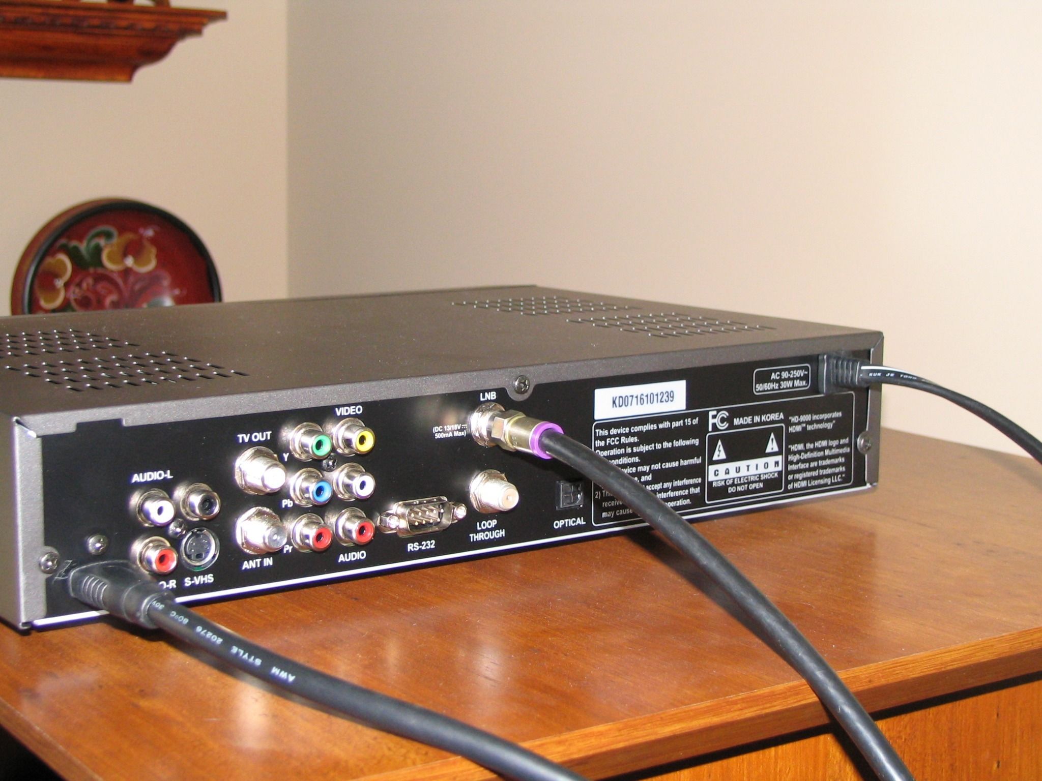

Connectivity

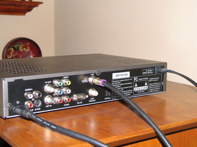

The rear panel contains connectors for the LNB input and passthrough, component and composite video out with RCA audio out, S-Video out with RCA audio out, HDMI out, and an SPDIF Digital Sound (optical) audio output. There is also an TV Out for viewing via channel 3 or 4, and a serial port for firmware upgrades. There is no power switch.

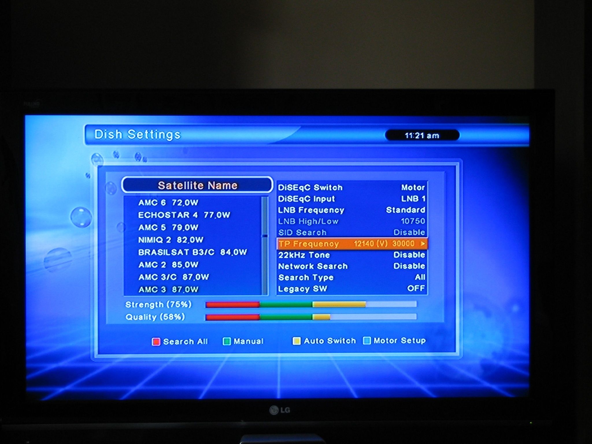

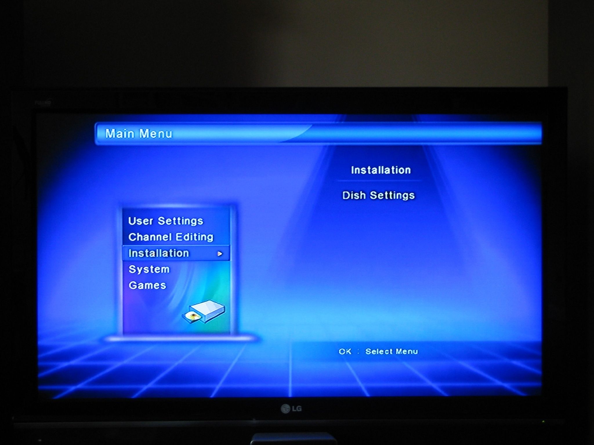

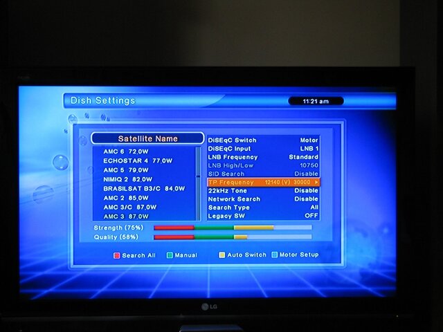

Now staring at a blank screen, I hit the menu key and chose Installation, then Dish Settings. You choose the satellite to set up and then use the right arrow key to change to the right side of the screen where the parameters are. You can set the Motor, DiSEqc, LNB settings, choose TPs, etc.

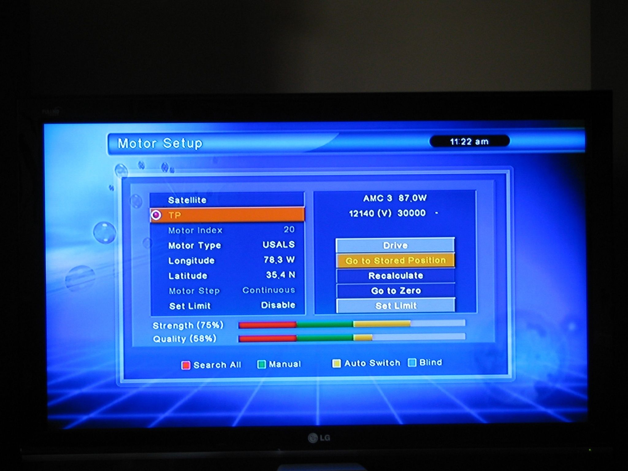

Motor setup can be done via DiSEqc or USALS. I choose USALS and it worked well. Motor control in general works, but there are some strange behaviors. Moving from one satellite to another often occured in several discrete motions instead of one continuous motion. Even with this behavior the receiver reliably and repeatedly hit the selected satellites. The discrete motion issue does not occur with my Fortec.

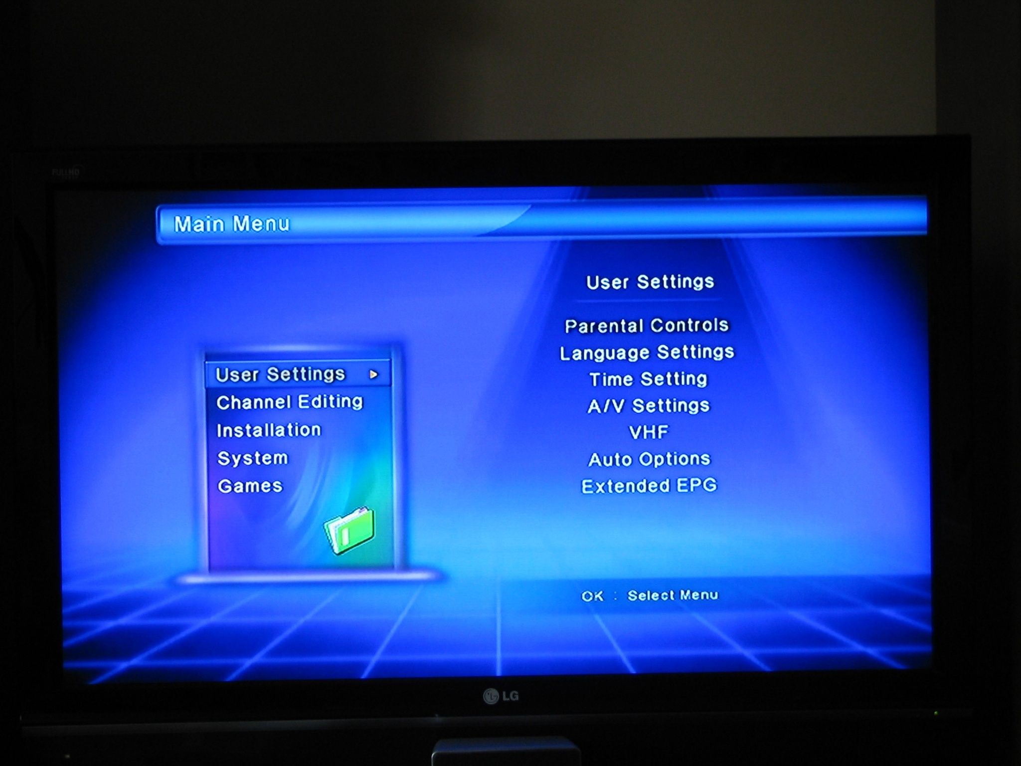

The on-screen display (menus) on my 42" LCD TV look very nice. The same menus on the 19" CRT TV that I occasionally use outside at the dish were more difficult to read due to the small size of the font.

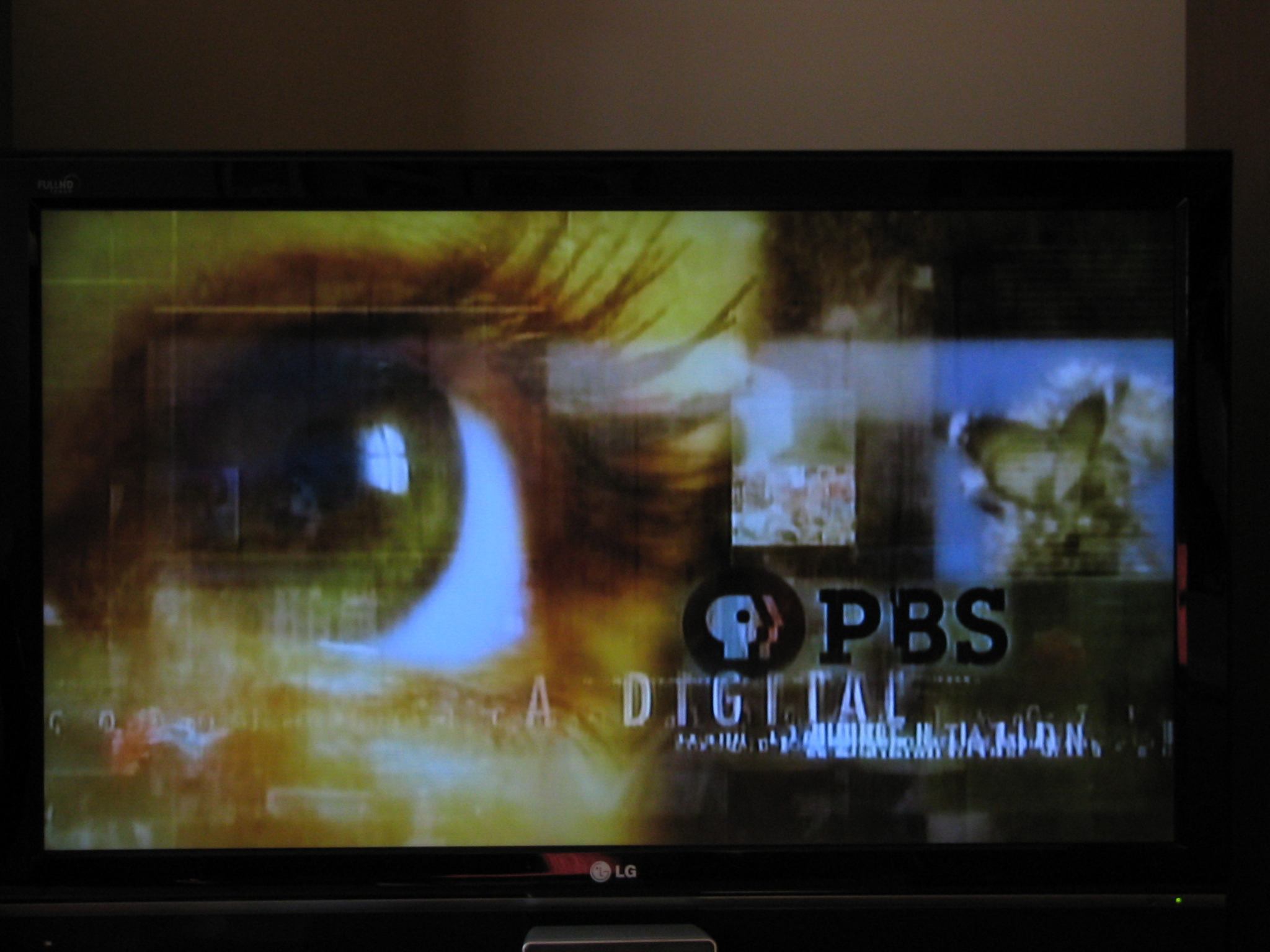

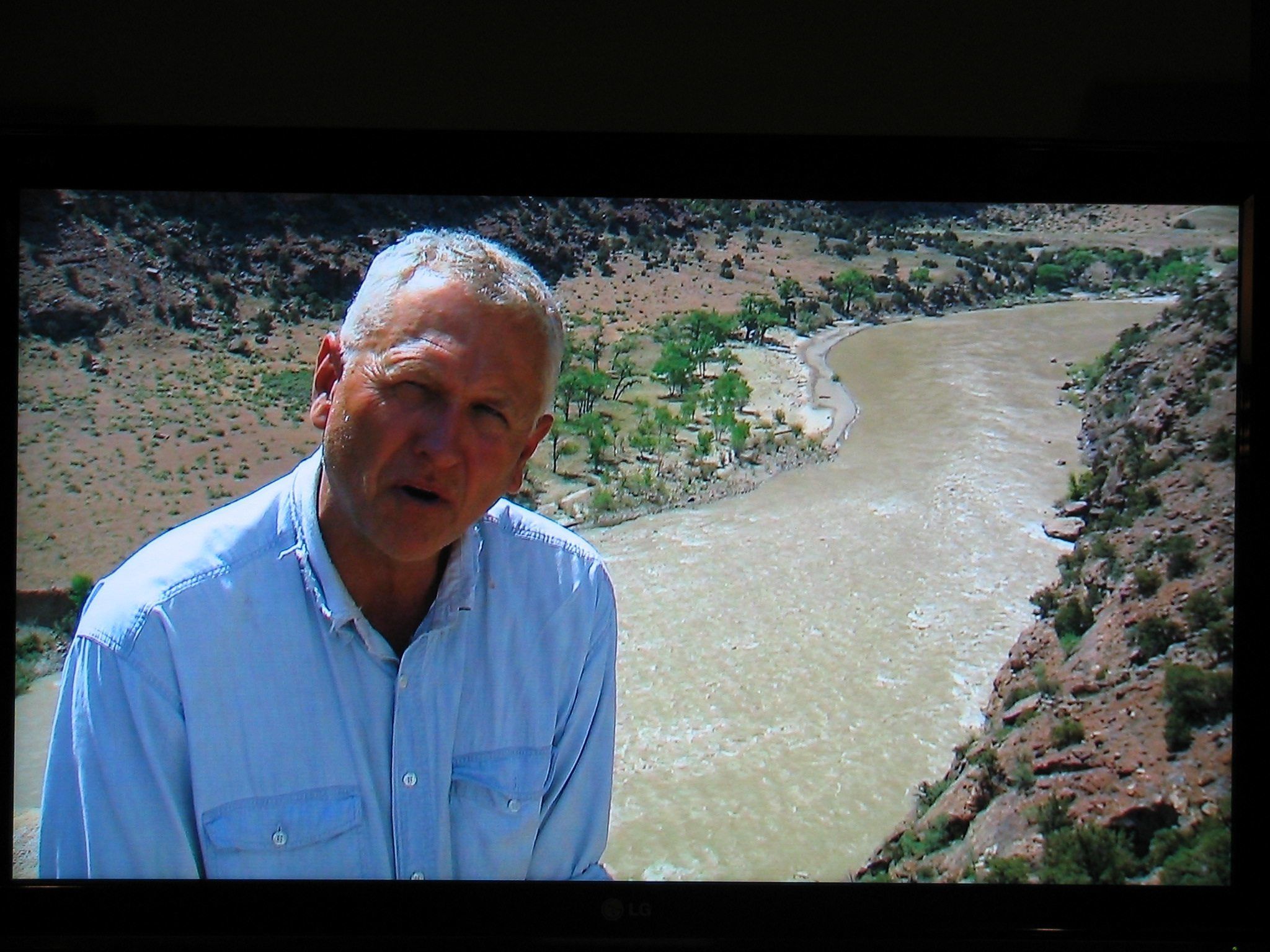

Picture quality for standard definition (SD) was comparable to my Fortec. The picture quality on PBS-HD is excellent. It is as good or better than the local OTA PBS feed. There are still some noticeable compression artifacts, especially in scenes with lots of motion, but all in all, the HD picture quality is very good.

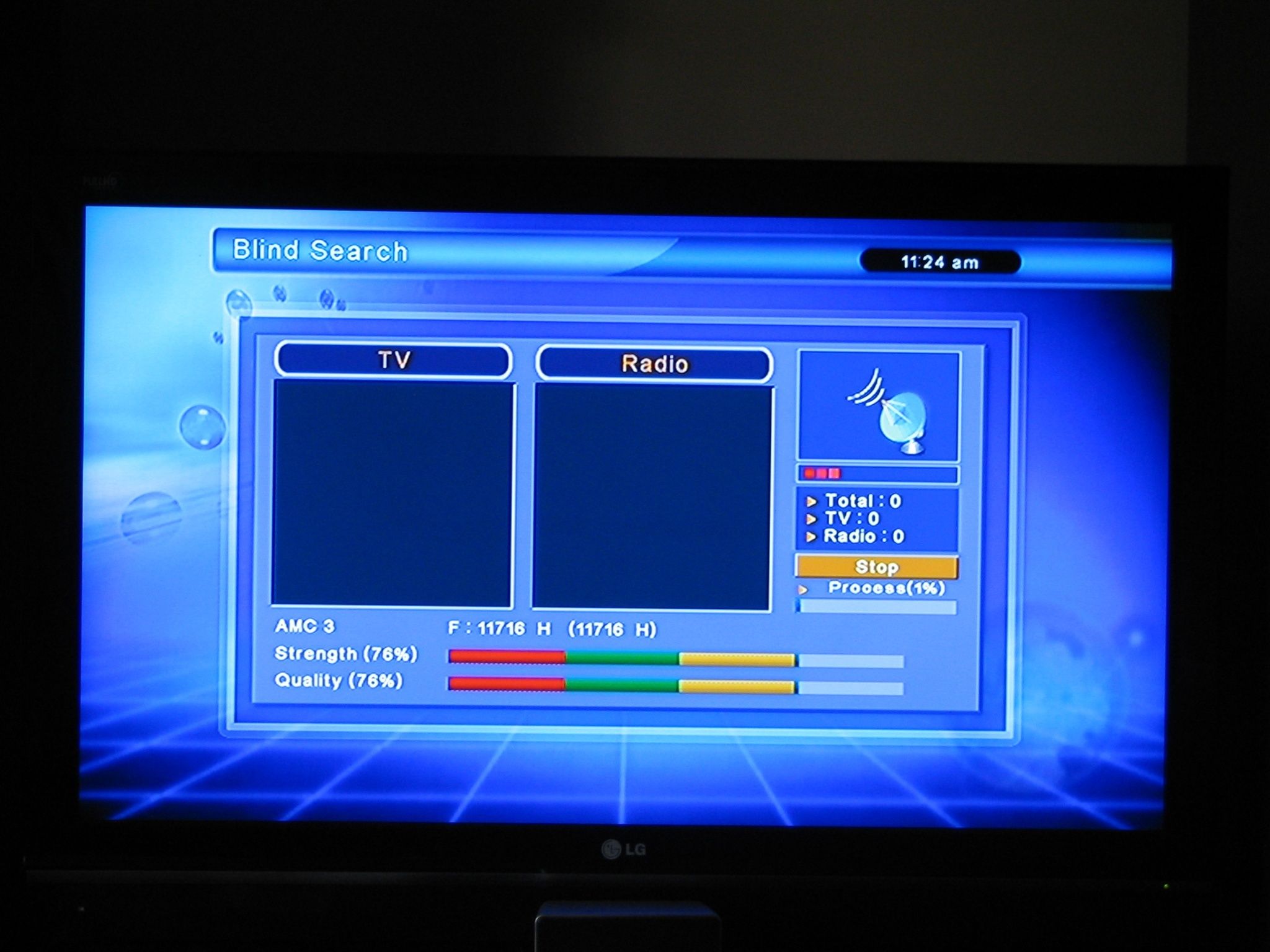

Blind Scan
I'm still experimenting with the blind scan function. At times it does appear to work, but there are issues. When I blind scan a satellite it does appear to find channels on TPs that are not in the list, but does not seem to save those TPs in the TP list! The channel list apparently contains the info so that the channel can be received, but it seems odd that they would not be saved in the TP list.
Sometimes, when attempting to blind scan, the scan will hang. The receiver doesn't hang, as you can stop the scan and navigate back through the menu structure. I do not know if there is a particular cause for the hang, such as a 4:2:2 feed or some other factor.
I tried deleting all TPs except one on a single satellite and then doing a blind scan, but noticed on another screen that there still appears to be a list of TPs coming from somewhere!
A blind scan of AMC1 took 8 minutes and found 32 TV channels and 2 radio channels. A subsequent scan found a feed listed as AMC1/21C NBC FEED that was not previously found.
A blind scan of G26 would not complete.
Manually entering and scanning a TP has not caused any issues (with the exception of PBS HD, noted below).
Some users have reported very long blind scan times.
The receiver features the ability to select multiple satellites, and then scan them. It moves the motor from position to position and then scans. I suspect the same issues appear with the blind scan in this mode. I have not tested this feature.

I purchased this receiver for the PBS-HD feed. I was disappointed that out of the box the receiver would not add PBS-HD when the correct transponder was scanned, even though the TP showed good quality. I tried reloading factory defaults and reloading the factory firmware to no avail. In desperation I loaded some "non-factory firmware" and amazingly PBS-HD was recognized and added. For the record, this firmware had been rendered unusable for its original purpose by a well known satellite provider. This firmware works fine for FTA use.
