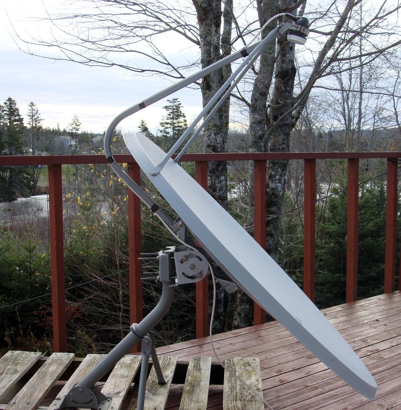

I should look at the picture before speaking, but...
sounds like you're fixed, so can you just invert the dish?
That's the (a, one) easy way to get to zero elevation. ;)
Nice to see this video. Almost like looking at the dish yourself in person. This is the dish I need. I wonder how much to ship all the way to eastern Canada. Inverting the dish is an easy procedure and a practical solution for fixed dishes for viewing lower elevation satellites. Attached photo shows dish on 121W at 14 degrees elevation. I was worried about not having a scale once you invert, but after you find your first satellite and make a reference mark, it's easy to simply move up or down by the calculated amount for your location.

No. The formula is 90 - (elevation to sat + dish offset) = Take-off angle.
For example, if aiming at a satellite at 14 degrees elevation using a dish with offset of 27 degrees:
90 - (14 + 27) = 49
The dish will point up at angle of 49 degrees with respect to horizontal. See Post #24.
