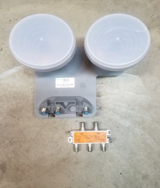

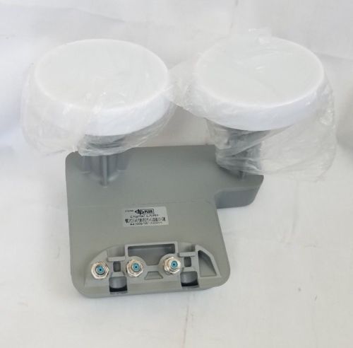

Now you'll need to figure out if you need a hybrid lnb or not. Non hybrid (dpp, which you have pictured) goes with a solo node, and a hybrid lnb goes with a hub. If you can follow the lines from the dish, you'll see either a square gray or silver box, which is the node, or you'll see a smaller orange "splitter", which is a hub. Should be good to go to order an lnb after that.
this is the the hybrid i cannot tell the difference from the other pic i posted
The coax ports on the LNB have a different alignment. The two on the left go to the top 2 ports on the hybrid duo hub (as you are showing it), the Hopper goes to the port marked Host. Joeys go to the ports marked Client. The third port on the LNB would be for a wing dish.
If he's using just one Hopper then only one wire from port #1 on the LNB to the hub is necessary. He could probably use a dual hub with terminators and a cap on the unused ports but a single hub is what he should have.
Those dual hubs are made for two Hopper 1's or two Hopper 2's or a Hopper 1 or 2 and a Super Joey.
