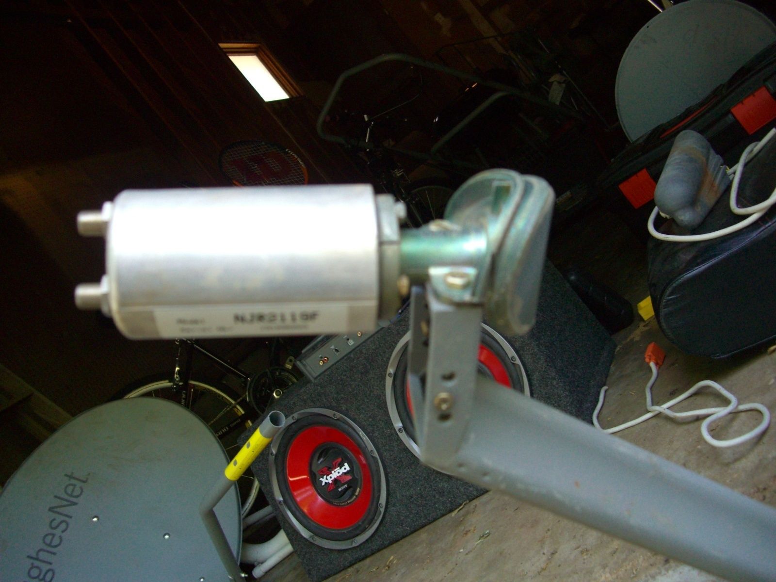

Turns out that dish I traded is an old elliptical P* dish with LNB model# NJR2119F
Here's a couple threads mentioning this LNB:
http://www.satelliteguys.us/free-air-fta-discussion/124428-some-questions-you-all.html#post1227446
http://www.satelliteguys.us/free-air-fta-discussion/35603-lnb-question.html

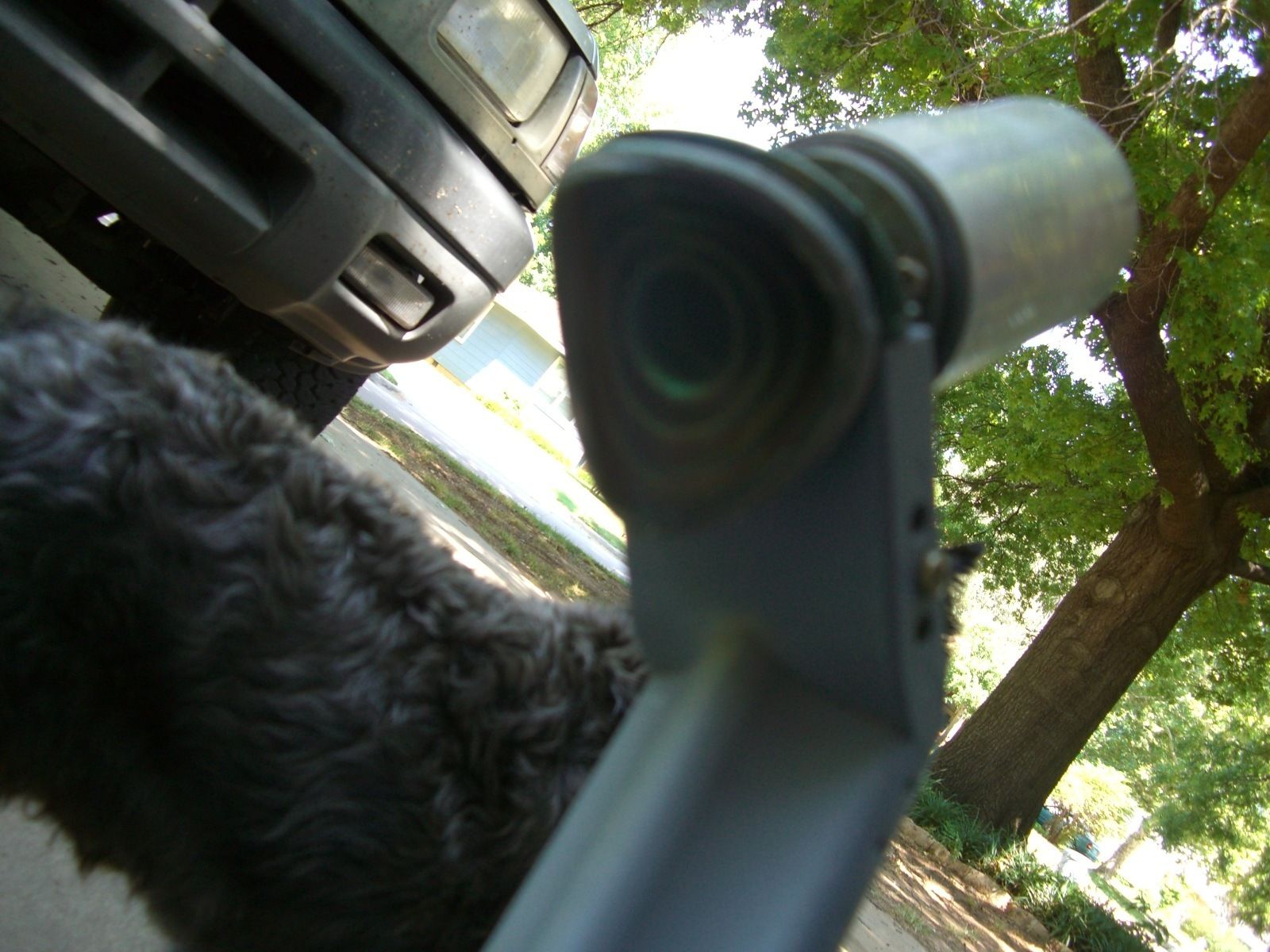

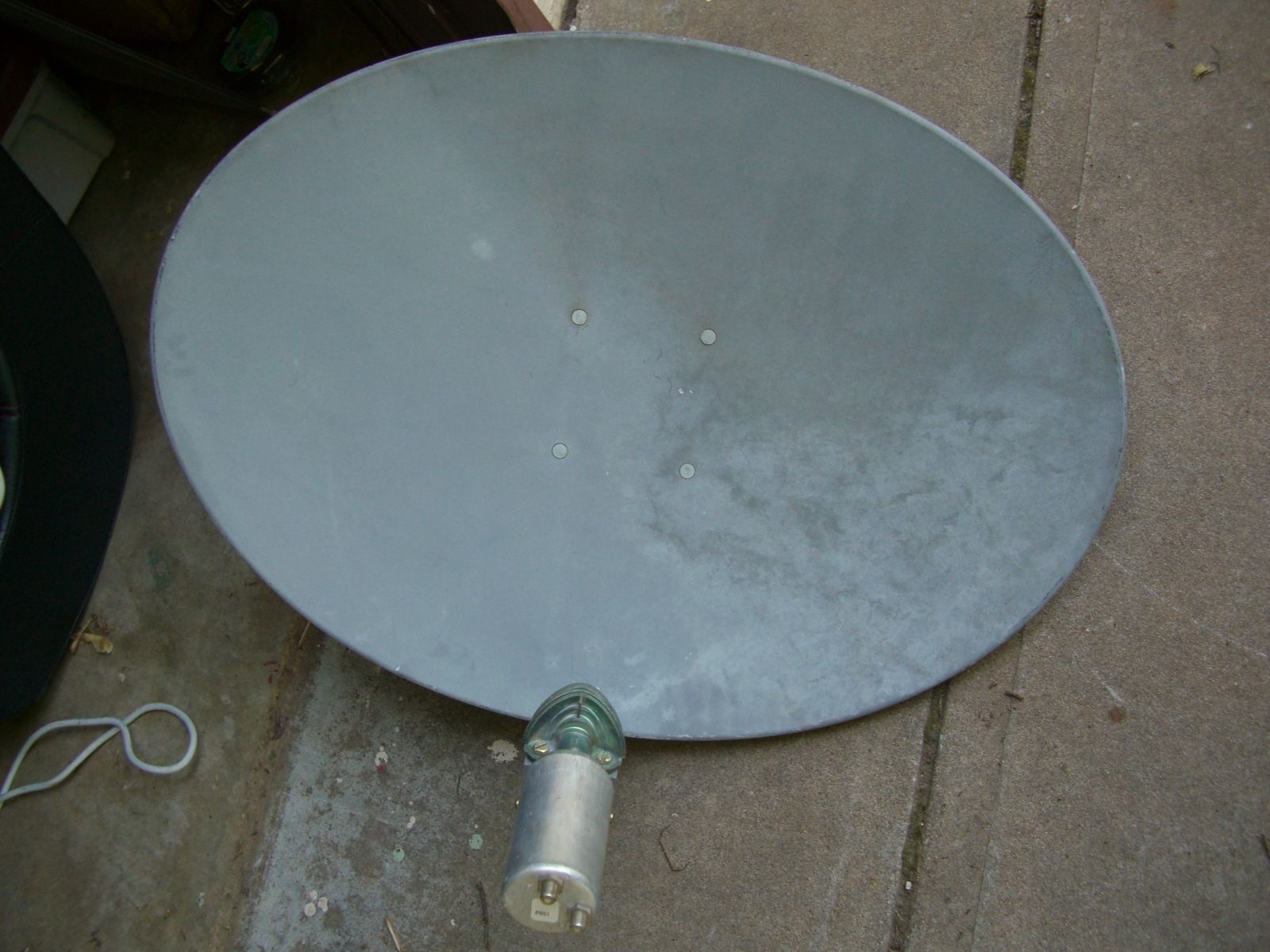

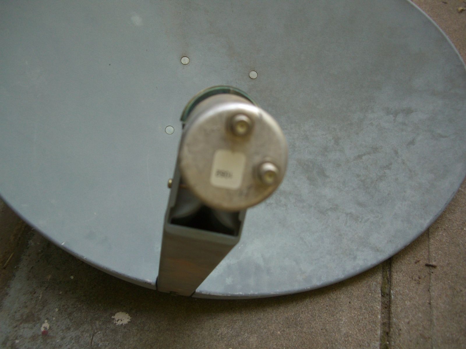

Here is pics of the dish I traded for the Direcway dish. It measured to be about 36x26.
I took down the warped metal Hughesnet dish and mounted the composite P* dish shown in the pics above. Took me about 15 minutes to find 123W.
The tip I needed before all this was to watch out for warped/bent dishes if you are using a used metal dish. Circular dishes will obviously be easier to tell if they are warped/bent. I dunno how anyone new to this would know if their metal elliptical dish is warped or not but be wary of it!
