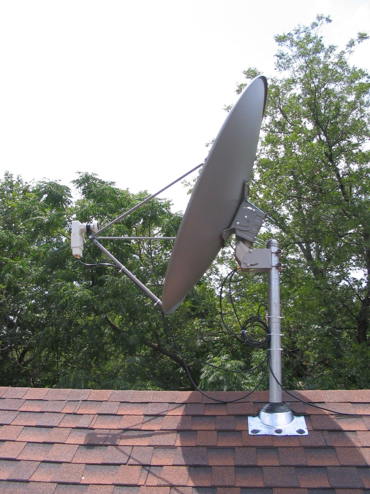

Here is a shot of my rooftop installation using a vent sleave as described by Pittsville. In addition to being U-bolted to the top and bottom cords of the truss it is pinned to the bottom truss to prevent rotation. Some shimming may be required to plumb the pole if the truss is not perfectly vertical. I recommend schedule 40 pipe if you mounting point is going be be more than a couple feet above the roofline.
What is missing in this picture is proper grounding of both the pole and the coax.
Nice setup, I did mine the same way a while back.
