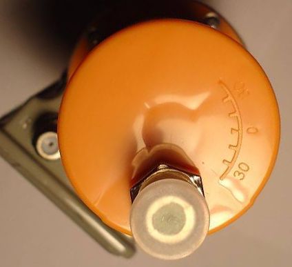

Ok, one more thing, On my true south satellite with the WSI NS741 I have the skew (I thought at zero) How ever NOW I'm confused (as normal) about where the Zero should be. Vertical and Horizontal TPs always match everything online though and I seem to remember checking into this before and being told (or reading) that "0" is at 90 degrees. Now why would that be?
So Zero is like this image looking at front of dish at true south:
