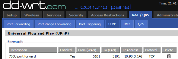

DLNA started working tonight(without a HIC); I turned on UPnP on my router and reset the hopper. The hopper registered port 5101 on the router and DLNA instantly started working. I'm not sure why this would matter but does anyone else without a HIC see the same port forwarding on their router? Capture.PNG

I have UPnP turned on in my router and I see the hopper in the port mapping there... but alas this is a fickle (read buggy) beast it seems.
