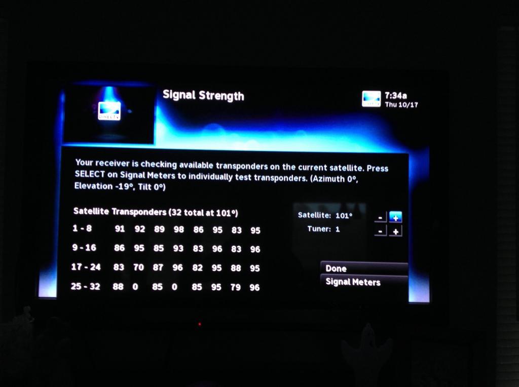

Alright! Got the dish moved and bolted to the deck. We got it level, it's just a hair off being perfect. Should that be a huge deal? Had it perfect, bolted it, then it was just slightly off. I went inside and turned the TV on. Almost all transponders are 90 or higher. About 3 or 4 are 86 or higher. Two are 0, but I've read that that can mean I don't get those channels. One is 67. I'm not getting AMC on channel 254. I haven't noticed any other channels I'm missing, but I also haven't went through them all. What do I do?
You may be seeing low signal strength on 99s or 103s. That's normal since those are spot beam satellites. Can you post the numbers from 101, 99c, 103ca, and 103cb? AMC HD is on 103 transponder 10. What are your numbers there?
Hope that's what you need. If there is something else, just let me know how to get to it and I'll post it.
Those numbers are a little bit low, but not bad. How about 103ca and 103cb?

The plumb mast just makes it easier. You hit the sats so you are good to go. The 101 launch position (all the SD sats) has a very strong signal. The 99 & 103 are less so so you expect to lose HD service first in bad weather. Therefore you want to spend a little time peaking the 99 or 103.

Joe youre right on the money. We got some rain and a cloudy day today, and lost almost all signals.
What exactly do I need to do to adjust this and get a better signal? Is there a tutorial somewhere of where I go from this point?

103ca: 1-8 are N/A. 9-16 and 17-24 are all 0. 25-32 are all N/A.
103cb: 1-8 are all 0. 9-14 are all 0. 15 and 16 are N/A, as are 25-32.
I think we celebrated too early. Channels were fine yesterday, and all gone today. We have had storms, though.
EDIT: Went outside and loosened the sleeves to move the azimuth a bit. Moved it about an inch to the right, and voila, moved transponder 1 from 86-97...channels are back.
The wife's Vampire Diaries are on and my Thursday Night Football is on, so we're happy right now. Will take a look at the transponders and post them again tomorrow, but hopefully that got it!

I was gonna say, the numbers you posted on the 103 sats being zeros, is gonna cause you trouble every day.
I just checked mine to make sure and I have all mine 91-95 on the 103, now everyone varies some, but you should be over 90 on them I would think.
Let us know what they are tomorrow and see how it looks, remember to tighten the nuts back down once you find your happy with where the numbers are.

A way to being where you are =..... return to the 101 sat.Try the pic after your weather clears...might be good. THEN TUNE...... Get it as high as you can by swinging the dish through the signal with the el & tilt locked. Then lock the az (back bolts) and loosen the el (side bolts) and tune again for highest signal.This is called "peaking" the dish and at the end of the process no adjustment will increase the signal; it is at its peak!
Remembering that the whole rig moves when you move one parameter...........switch to the 103 or 99 sat and again peak those sats. By pushing west from the center of the 101signal a little bit...one degree approx...you will begin to raise the 103 as the 101goes down a little. This can be done by feel OR there is a technique called "dithering" that uses those wheels you may have noticed on the dish.
