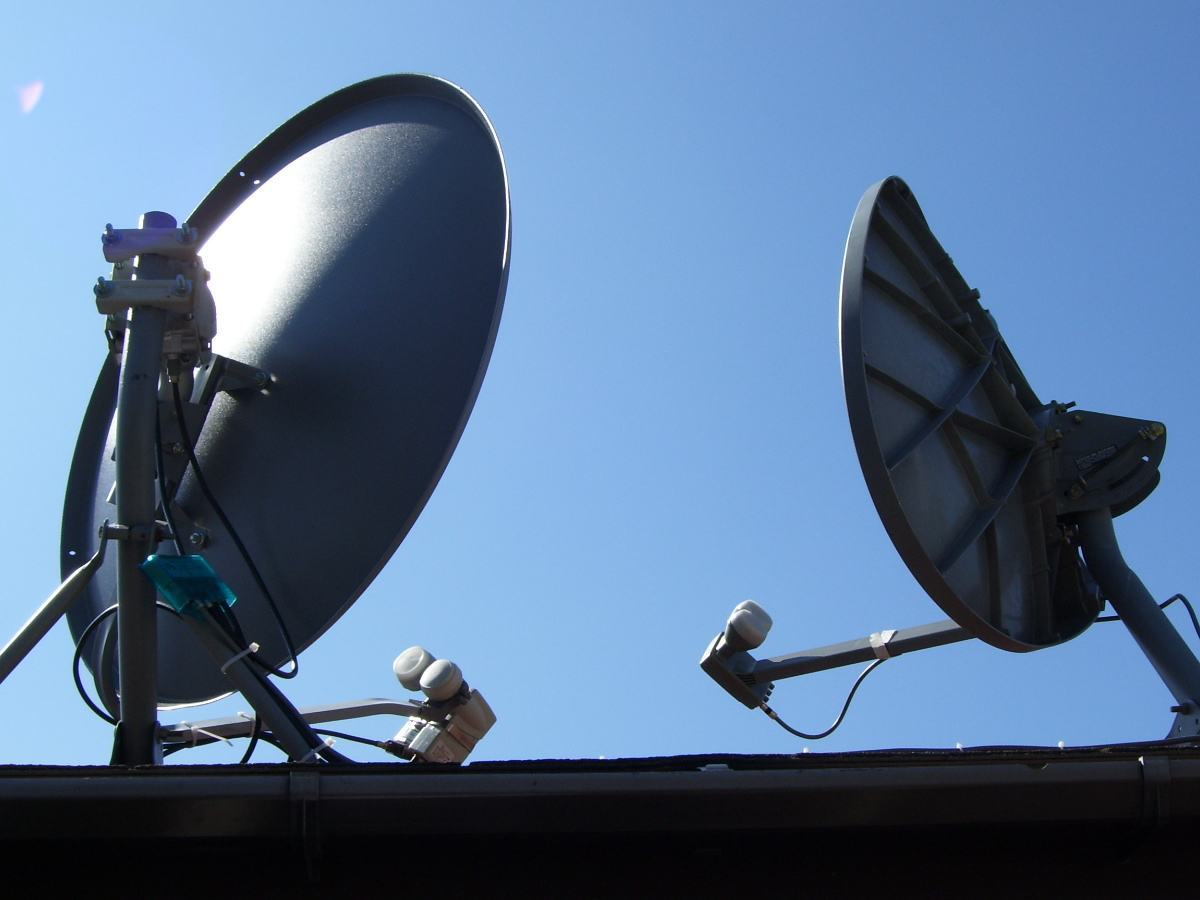

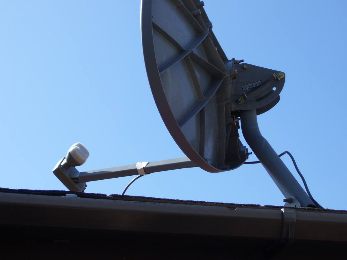

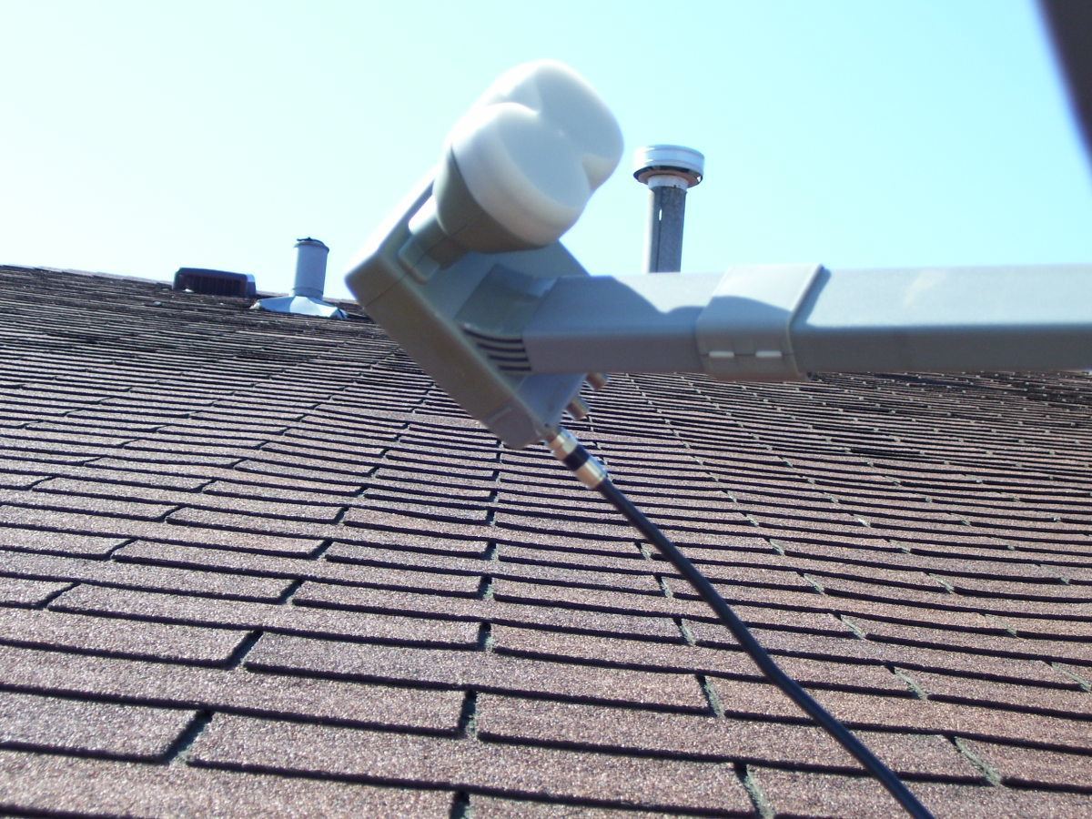

I use to use my 75e dish and the sat B (aka the 111.1 LNB) since it is boresight here in MN

I reside in Sw ontario and i have used a 75e i think its 18x32 oval to capture 30w and 43w am currently using it on 79w and working real good.
