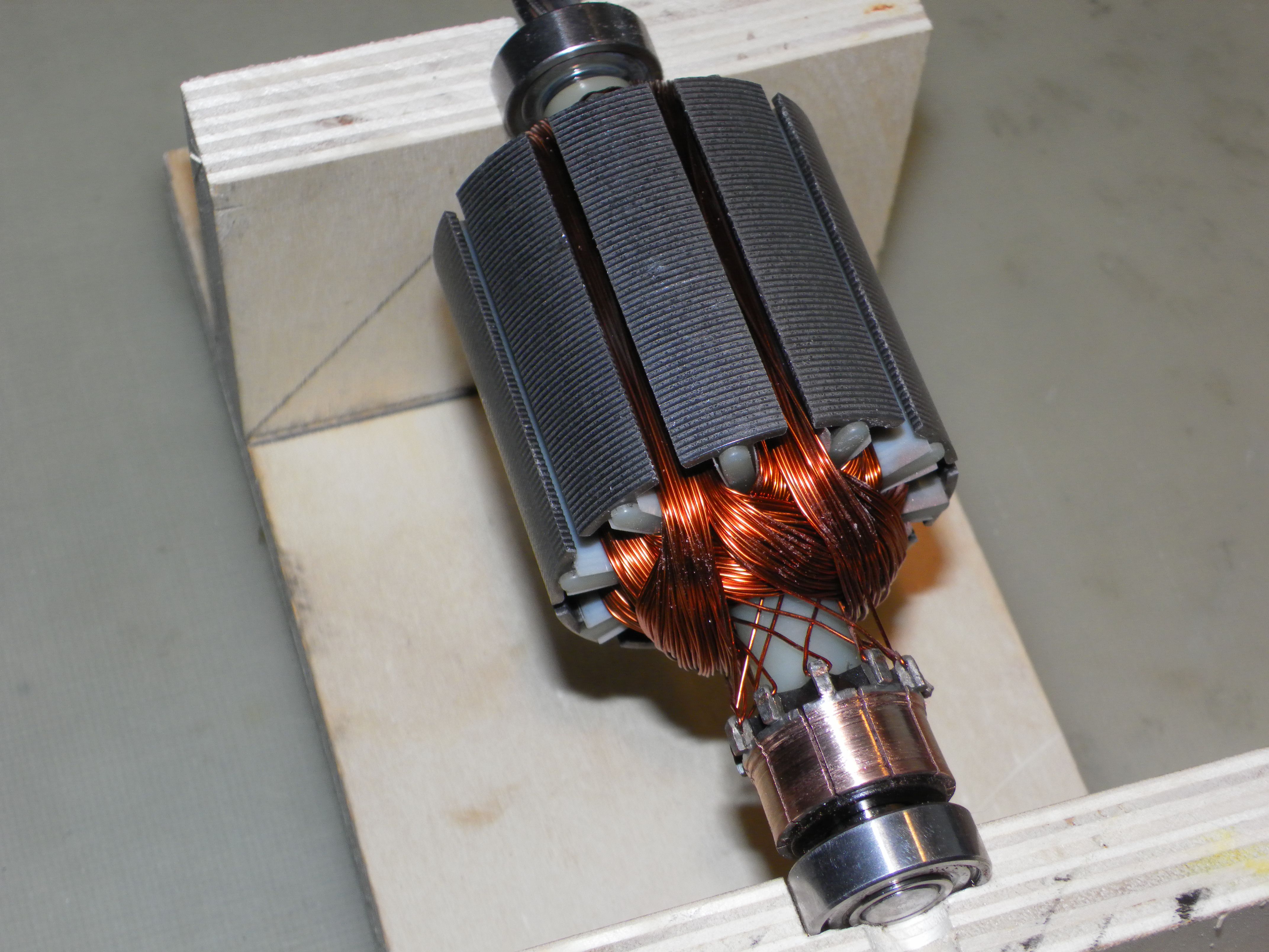

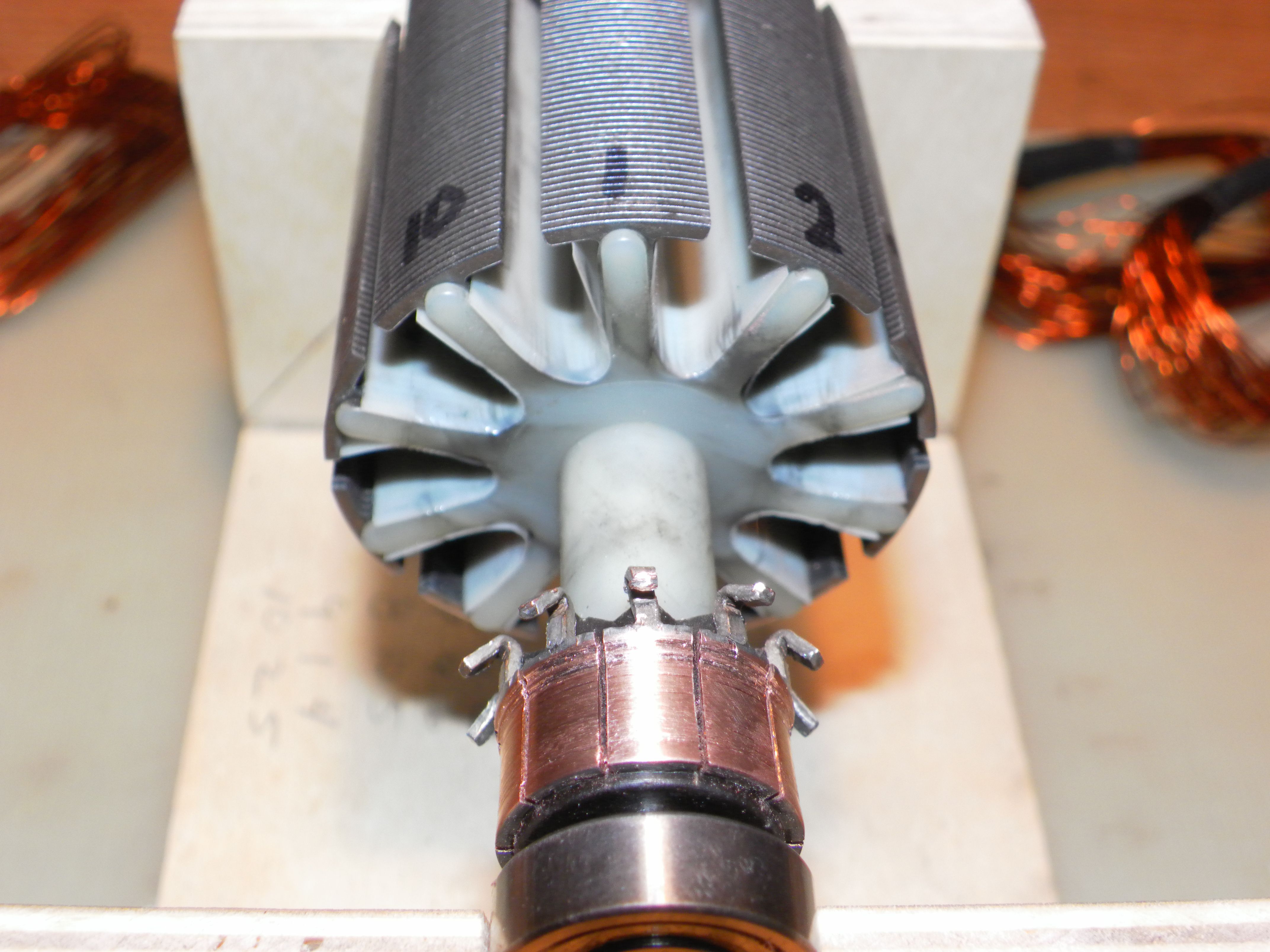

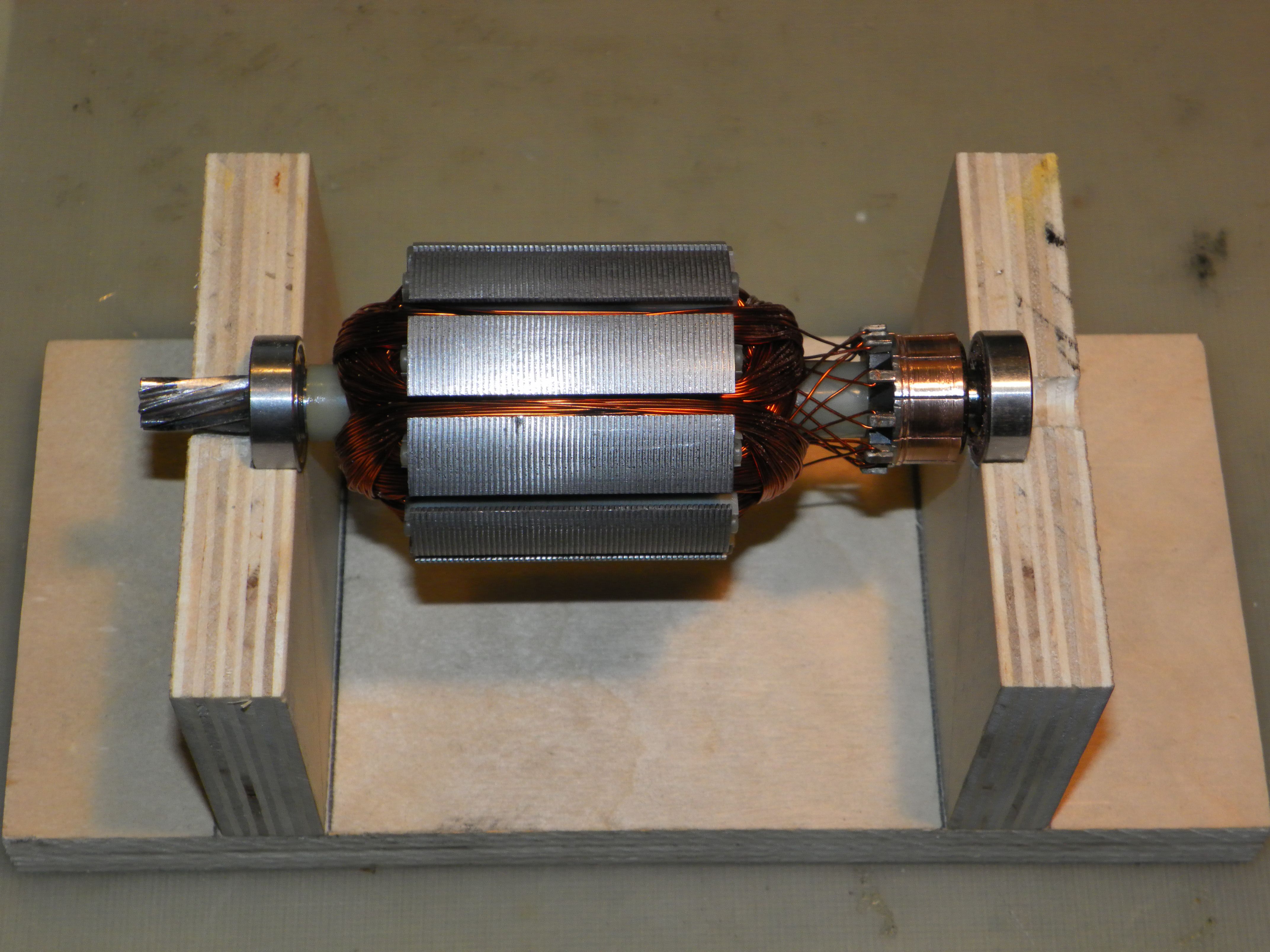

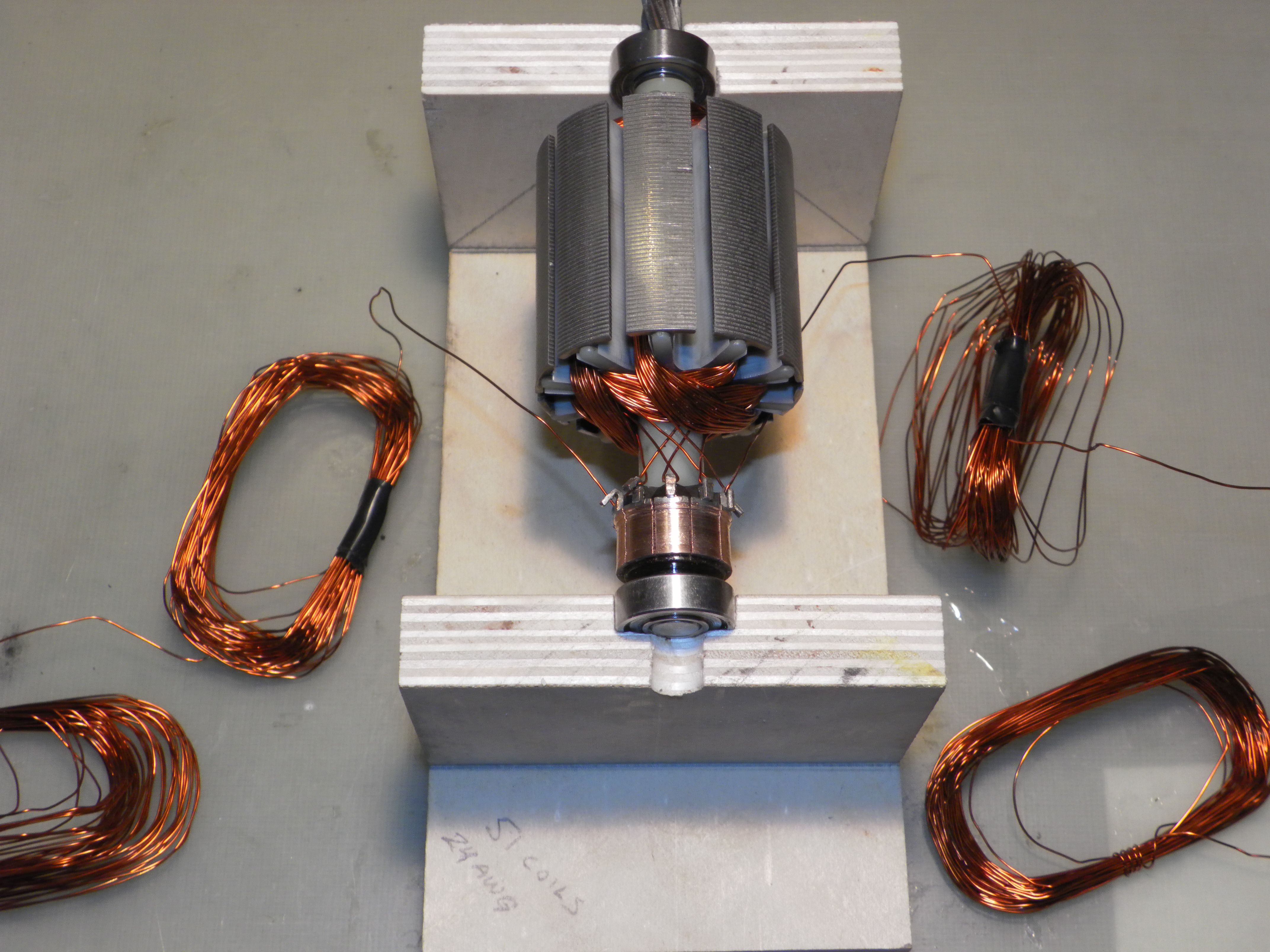

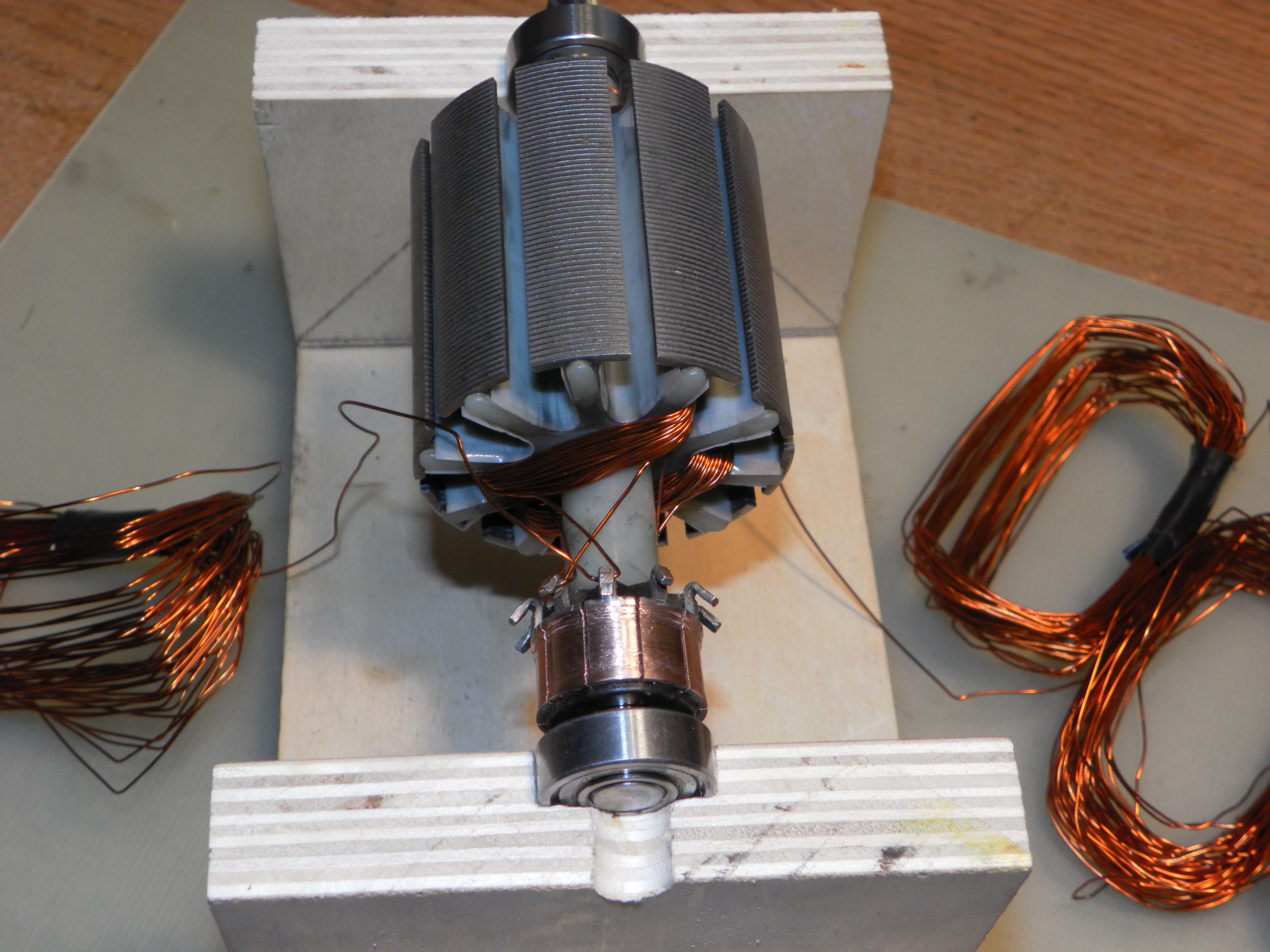

I have started into the job. There are 10 winding's of 51 wraps each. About 300 ft of 24 AWG Mag wire by weight. When the armature was wound at the factory they started in the middle and worked both sides out at the same time. The wire connections on the armature commutator are to facilitate machine winding and not indicative of how the electricity flows through the armature. I have disassembled the winding and ordered some mag wire. I made a little jig to hold the armature while I work on it.

Just an FYI for you, it is no longer politically correct to use that term! Years ago, we in the Machinist trade had to start referring to them as a "fixture" instead! :imshocked :oldwink
LOL okay then ;) I must have lived a sheltered life. It took me a little while to figure out what was "politically" wrong with that. Learn something new every day.
Same here had to research that one.. Ridiculous if you ask me but whatever.

My fingers are sore just looking at the picture!

Well that didn't go well :( While I learned how it was wound I didn't learn any techniques used to do the job. I did not wind it tight enough and it shifted and shorted right out. I was debating weather or not trying to wind tighter would hurt the insulation. But definitely needs wound tight.
