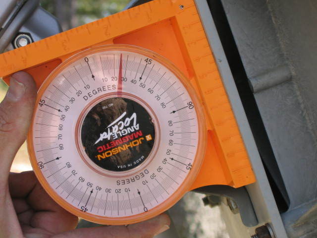

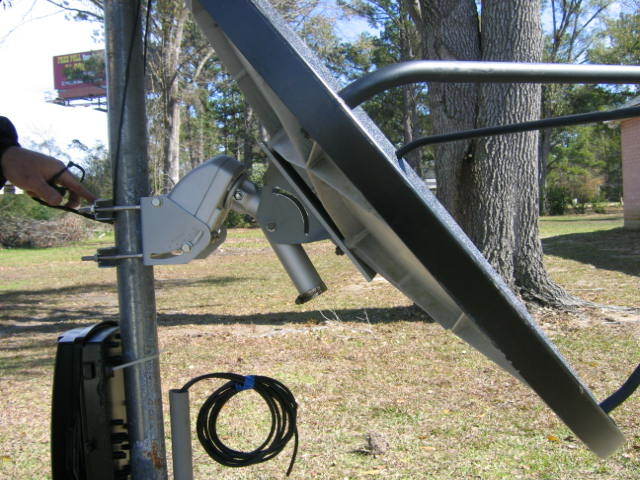

Ok fellas, I have the motor set to my latitude 30.18.567. the Motor maunal says set the dish to 30 minus my declination angle. That will be 25 because the declination for 30 degrees is -5. Correct?
My southernmost satellite looks to be G9, at 182.2. should I line it up on that satellite and adjust for the arc or should I move the motor with the reciever to that satellite position THEN align the dish? I am using a Coolsat 5000 diseqc 1.2 mode.
Reason why I am doing all this is I need to design a jackscrew and I want to be CLOSE before I design a jackscrew asembly.

I think I have the motor VERY close to due south on the pole right now, I set it with a compass to the middle of the tube as close as I could get it, then tightened the u-bolts.
I went back to HD and got all the supplies to make the jackscrew, I am going to try and use a all-threaded rod, but its gonna have to be CLOSE because I am only gonna have an inch or two adjustment unless I shorten or lengthen the rod each time, which I do not want to do. :)

I wanted to use a turnbuckle, but I couldn't find a left handed threaded bolt to go in one end of the stinkin' turnbuckle. All the turnbuckles have hooks and eyelets on the ends, not good for supporting weight, designed for pulling loads, not supporting them. I thought about bending the eyelet 90 degrees in my vise and then bolting it in place, but I dismissed that as unworkable. So I decided on a piece of 5/16 all thread and a whole bunch of washers, nuts and lockwashers...:D
The dish I am using is a P* 1m round dish, so I don't know how I'd put a circular LNB on there....I have an old D* lnb I guess I could ty-rap it to the side of the P* LNB and it probably be close enough for guv-mint work.;)

Well, after tweaking, fiddling, fuming, cussing, smoking, and twiddling some more I finally have the arc. Half of it anyway. I think I didn't set my pole back enough from the house to clear the southeasternmost satellites, either that or my aiming is wrong. :no
I can hit pretty much everything linear from IA-6 westward, but east of that, nothing.

I think its the pole. I moved it to the top of the pole and NAILED G10 with 85+ on most transponders. Everything from IA-6 westward is great, no problems. East of that, still nada. I need to find that obstacle-height calculator and find out if the peak of my roof is blocking it.
I should have put a six inch pipe six feet in the ground...:mad:
