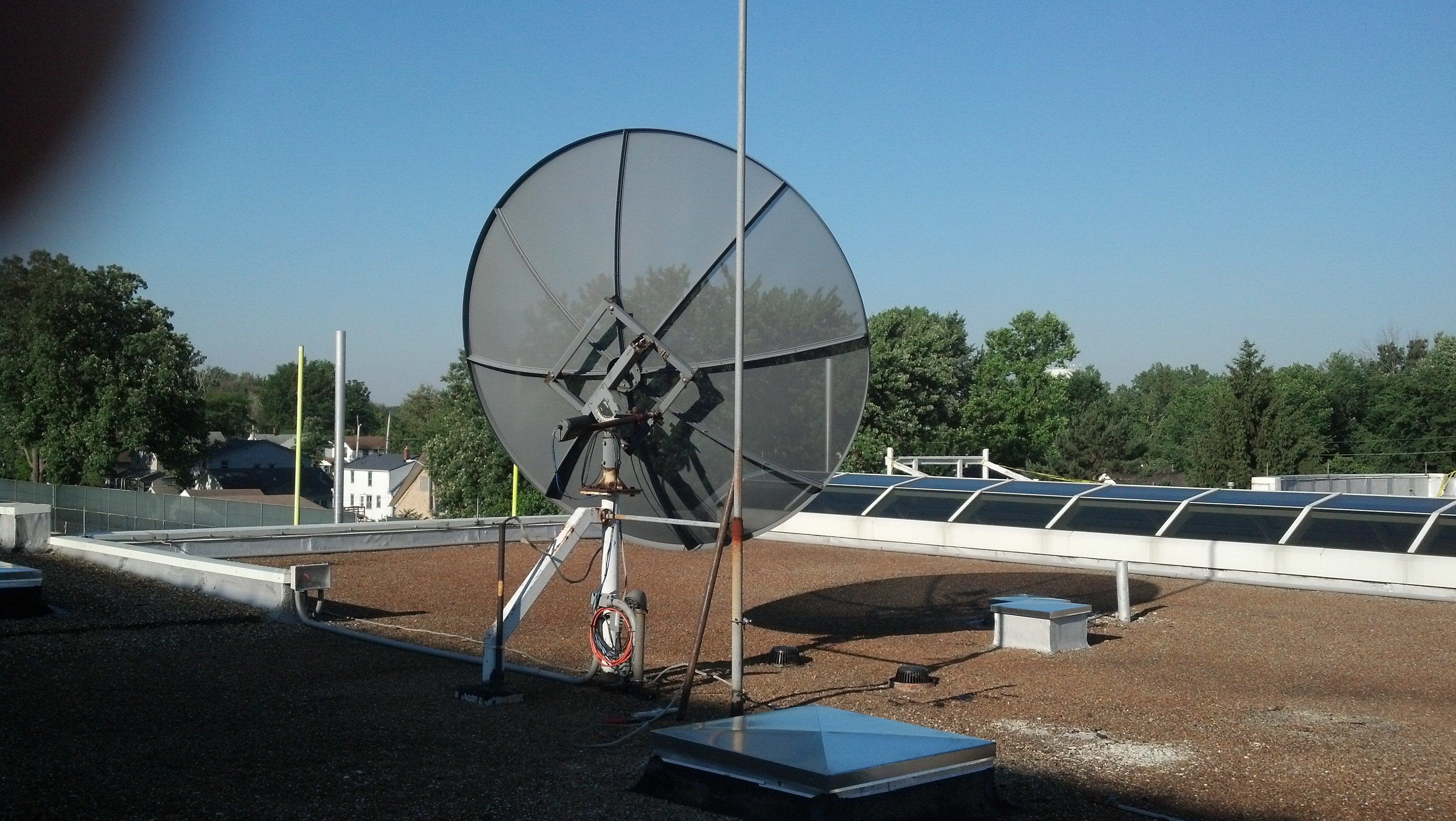

2 RG11 lines run through conduit, 12/2 AWG run for voltage and a cat6 run for sensor. I also ran an RG6 incase I ever need to power the multiswitch from inside.. not sure how will that would work over a 250+ ft run but hopefully I can just use it for an OTA antenna. Should be tweaking next week!

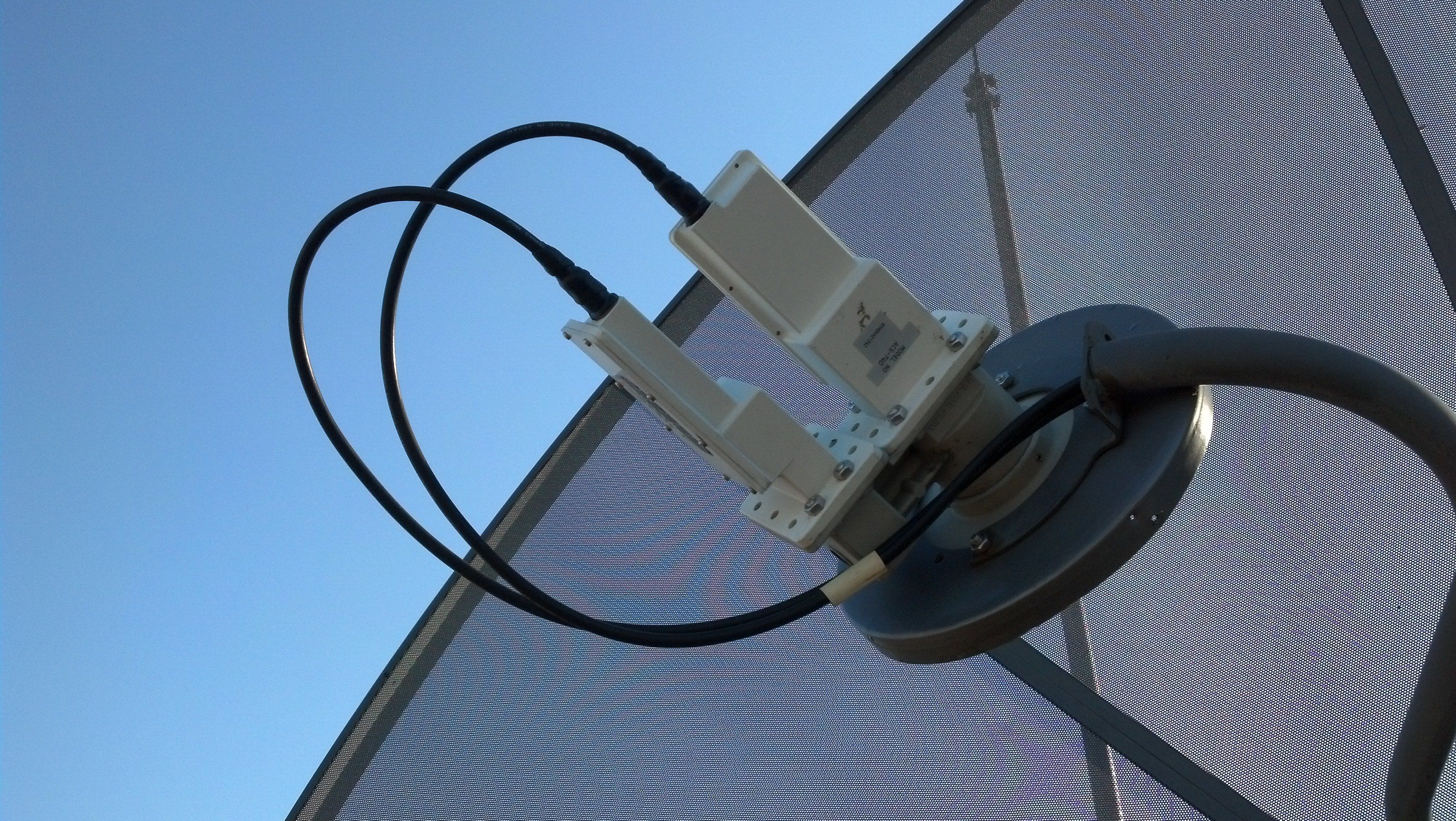

Anole - You said I need 4 runs from my ortho to my multiswitch, I only see one F connector coming off each of the feeds. I'm sure this is a dumb question but where do I plug into my SWA-48 from the orthos?
4 coax
Thought you had a dual band ortho. C + Ku. Two coax for each.
edit: yea, wrong thread. Yours is C band only. The better configuration.
If not, then that small Ku dish up on the roof could be outfitted with a dual output LNBF.

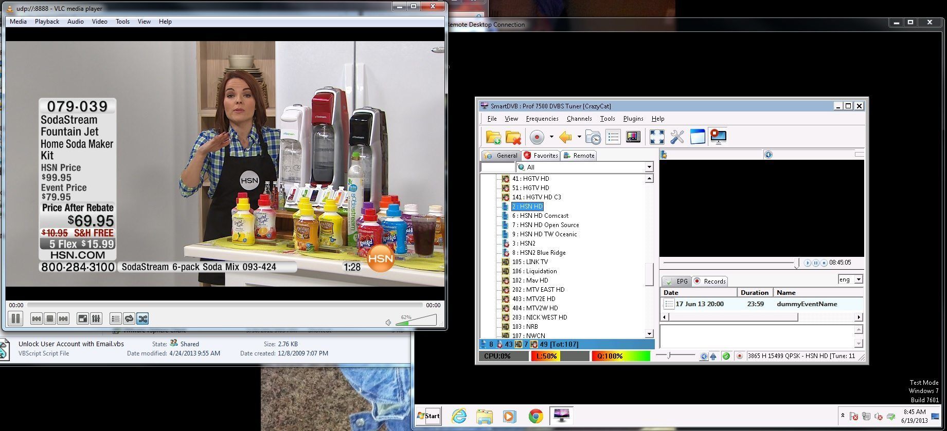

Finally got around to hooking it all up last night before I left the office. Checked the modified multiswitch, 18V coming out of all the ports. Got all my wires to the MDF and a PC loaded up. My VBox doesn't arrive until tomorrow but I decided to do a blind scan anyway, I wasn't expecting anything since I had moved it back and forth with a drill battery to see if the mover still worked. To my surprise I pulled in some channels! With the help of lyngsat it didn't take me long to figure out I was on AMC10 135W. My first viewing was of some good looking chick working an ab roller of some sort on HSN, I did have the H&V scanning in backwards so today I went up to the roof, swapped the LNB inputs on the multiswitch and cleaned up the mess of wiring. Thanks for the help everyone, I'm sure I'll have more questions once my mover gets here tomorrow. One thing I'm not sure of is how far I should be able to move the actuator? if I go to far will my dish flop off or will the mechanical limits stop me? Should I set limits on the vbox if I have mechanical limits in the actuator? Anyway here are some pics!
Nice setup! I like my Winegard Pinnacle also. Curious about the feed setup on yours. The Pinnacle is a very deep dish F/D .278 . In order to illuminate the whole dish the feed would stick past the scalar more than an inch. Pendragon went through some extremes to modify his Bullseye II feedhorn to accomplish this. I noticed yours is not this way and was wondering if you tried to tune that setting and that's where it was best or??
I've done no tuning, my vbox gets here tomorrow. Do you have a particular feed you have issues with that I could try to hit tomorrow? This dish was previously setup (not by me) and I didn't move it, I just ran new cables to it.

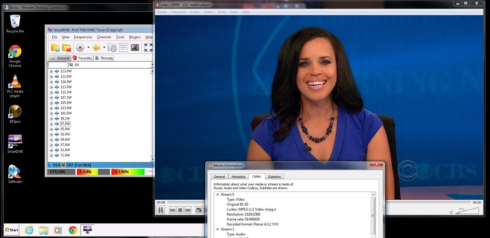

Hey guys, little update.. Got my Vbox and been setting things up and watching TV. I'm covering from 72-139 just fine, the 4:2:2 CBS feeds all good. I did try to find Simon Bolivar but no luck, according to sat beams I'm in the C footprint and my 10 footer should be enough to get something... unless I'm reading satbeams wrong. I'm in northern Ohio if anyone has any input on that let me know!
