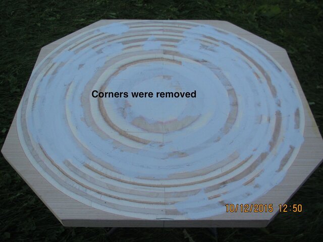

Machine for making wooden offset dishes of various focal lengths

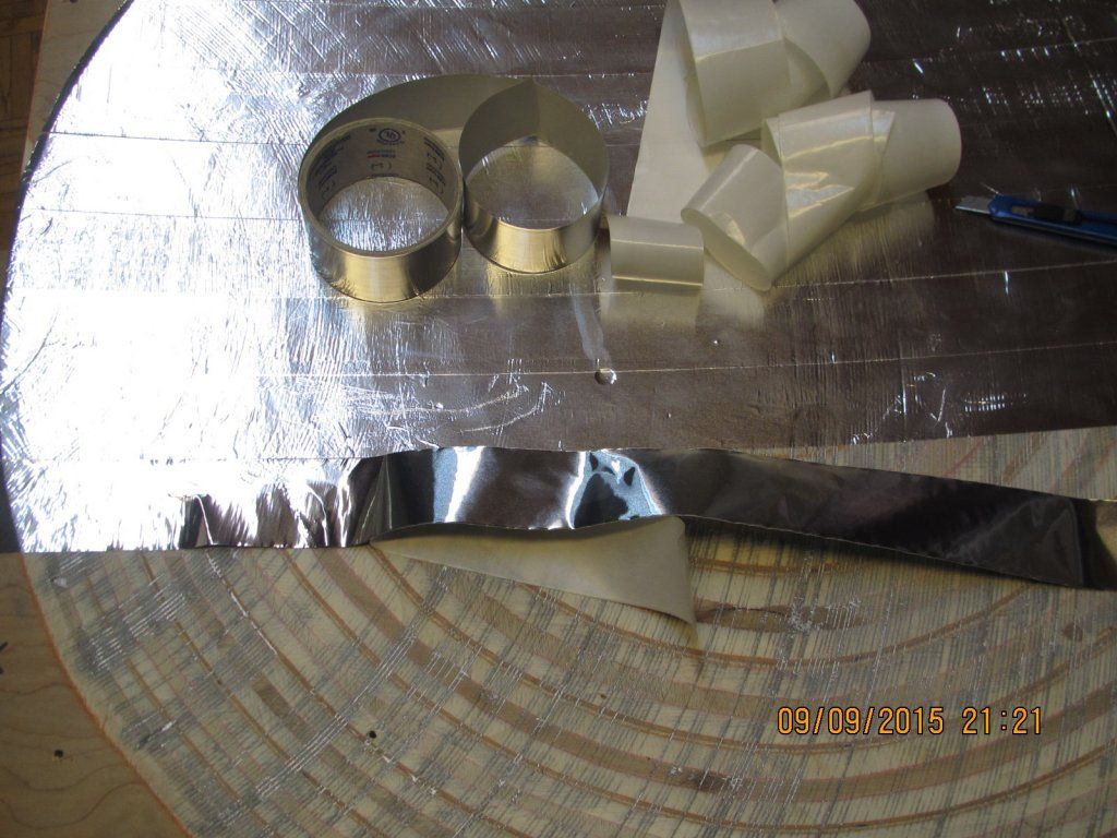

How about that metalized duct tape?
Gee, isn' t there a telepathy ?

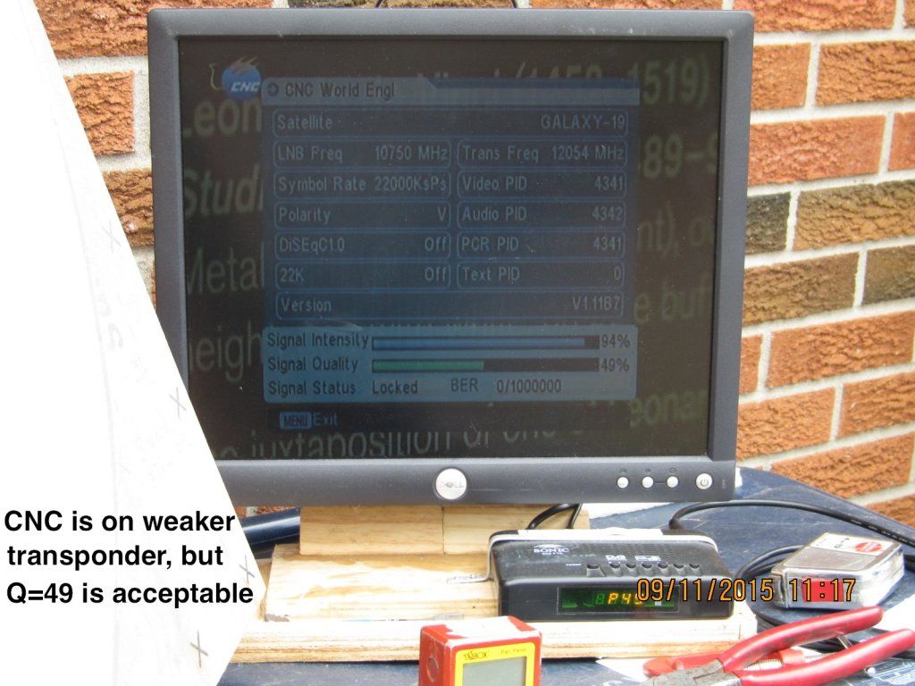

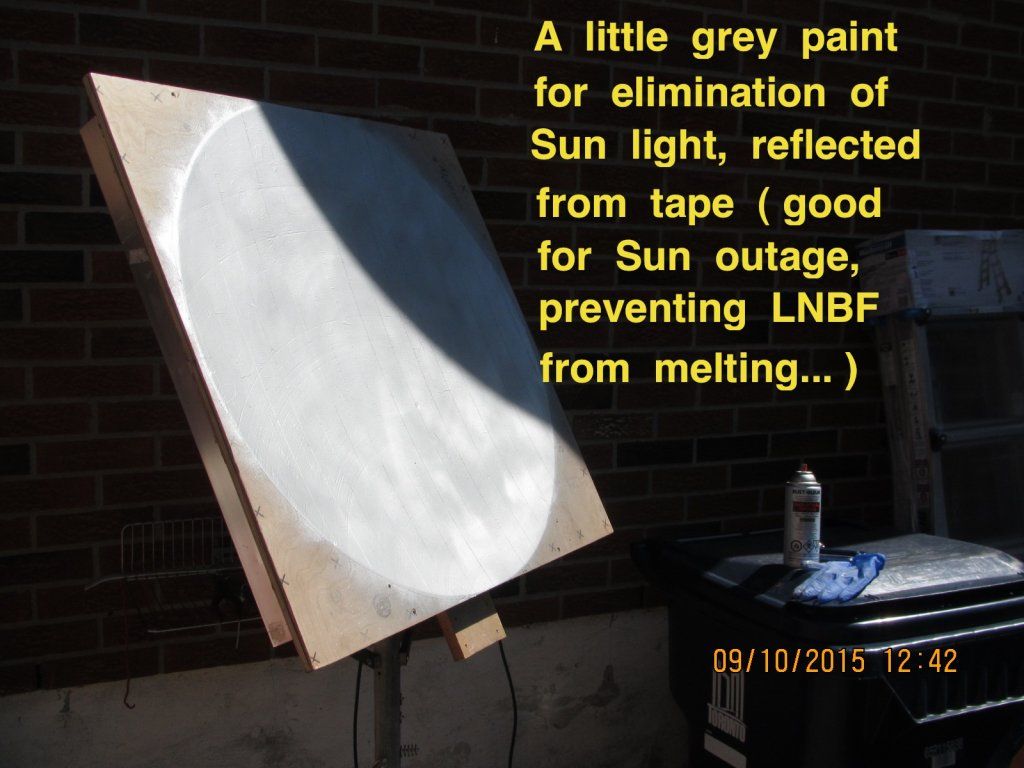

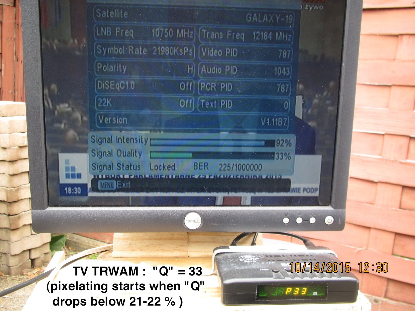

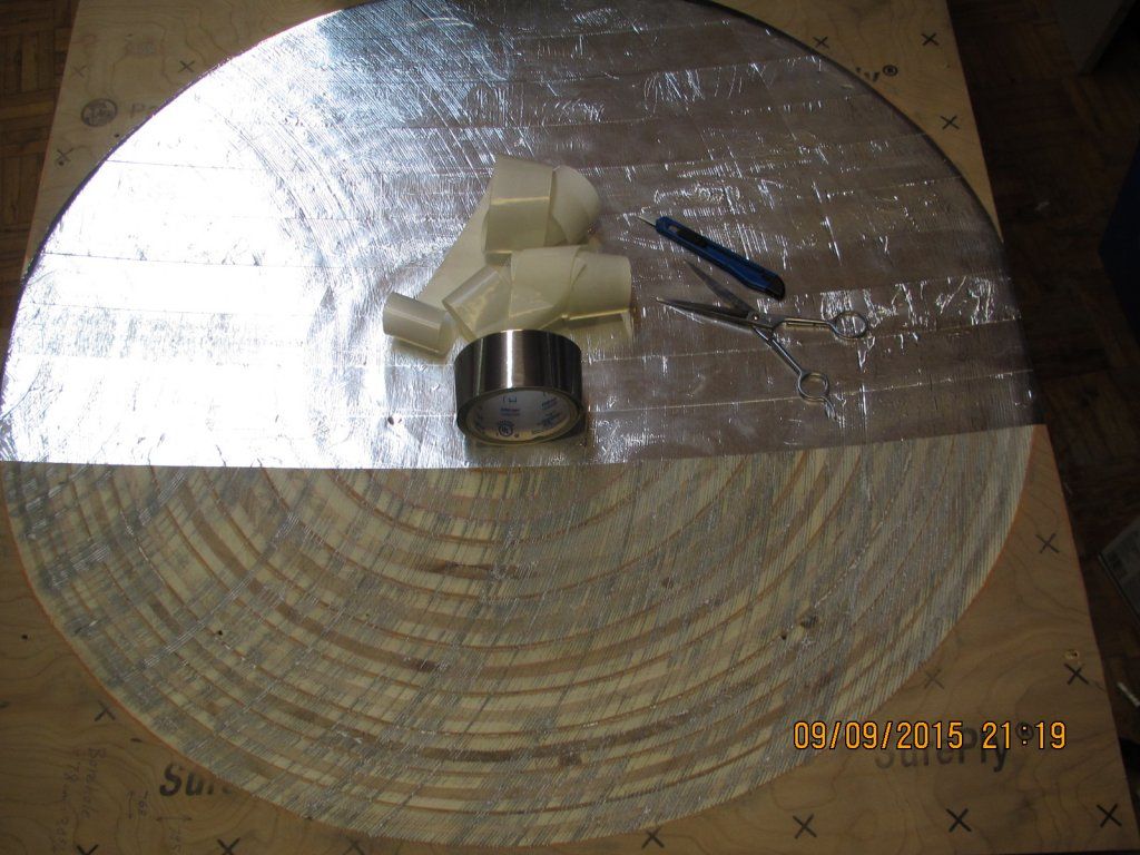

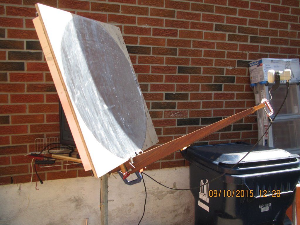

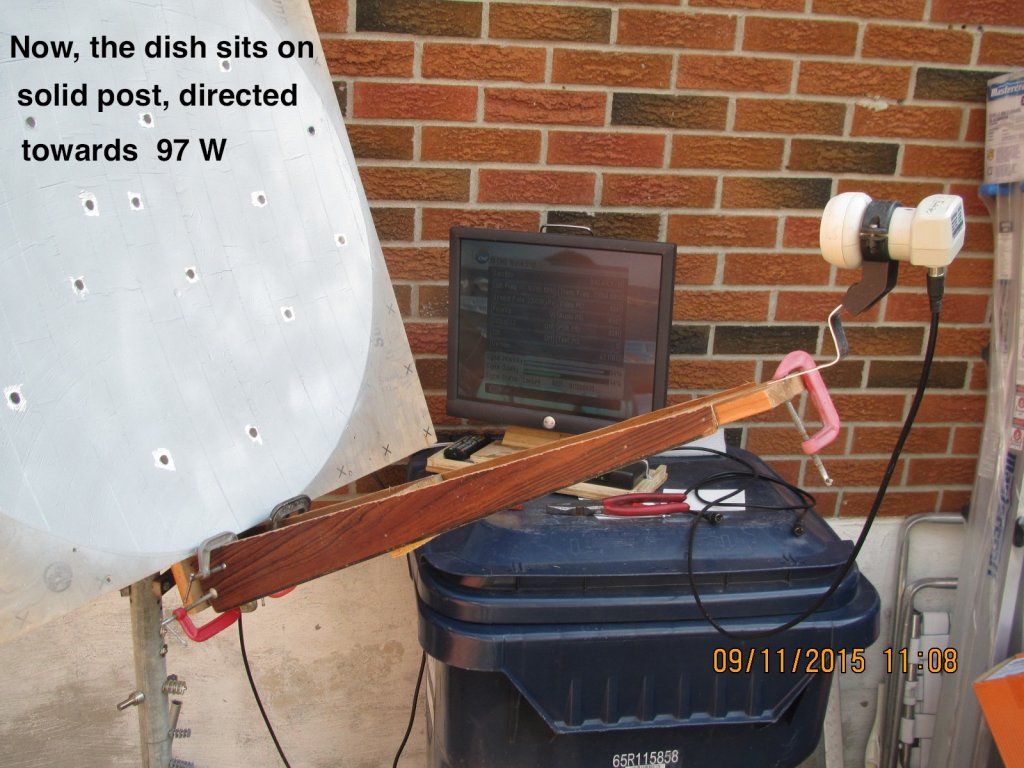

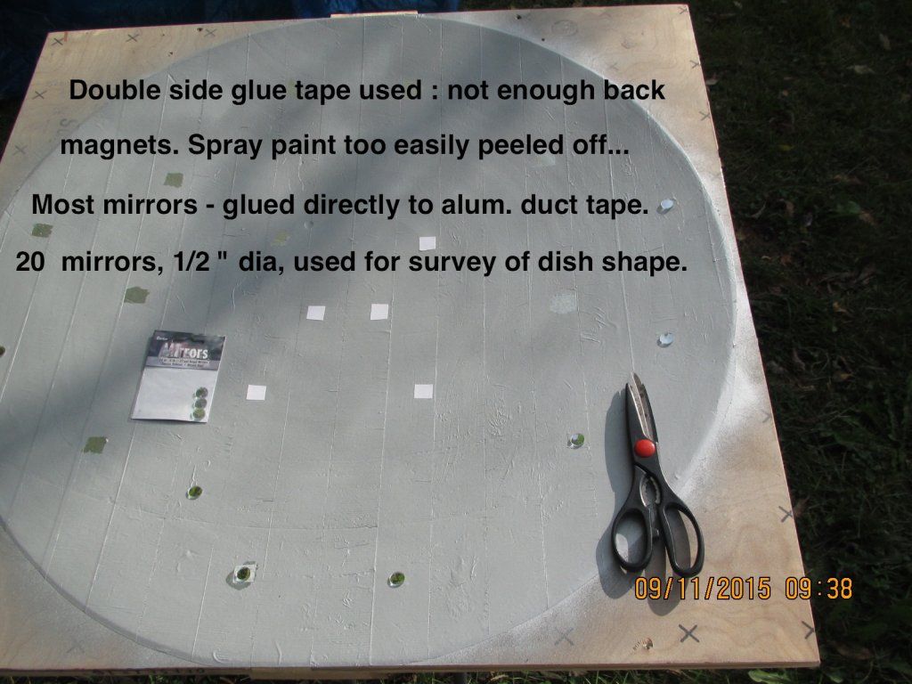

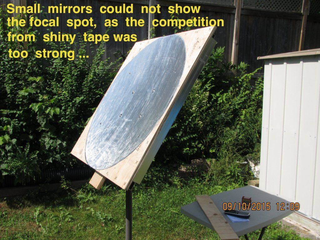

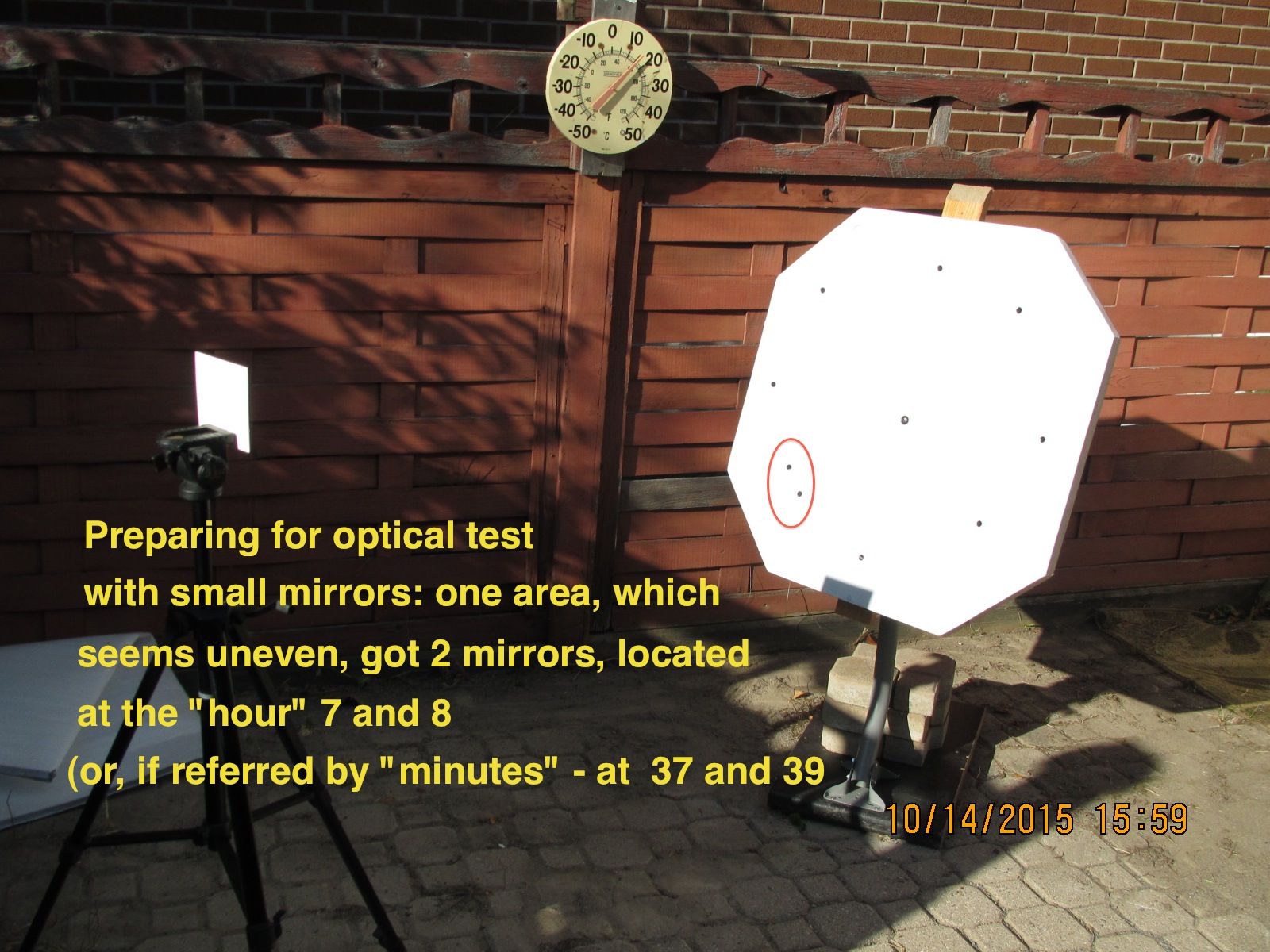

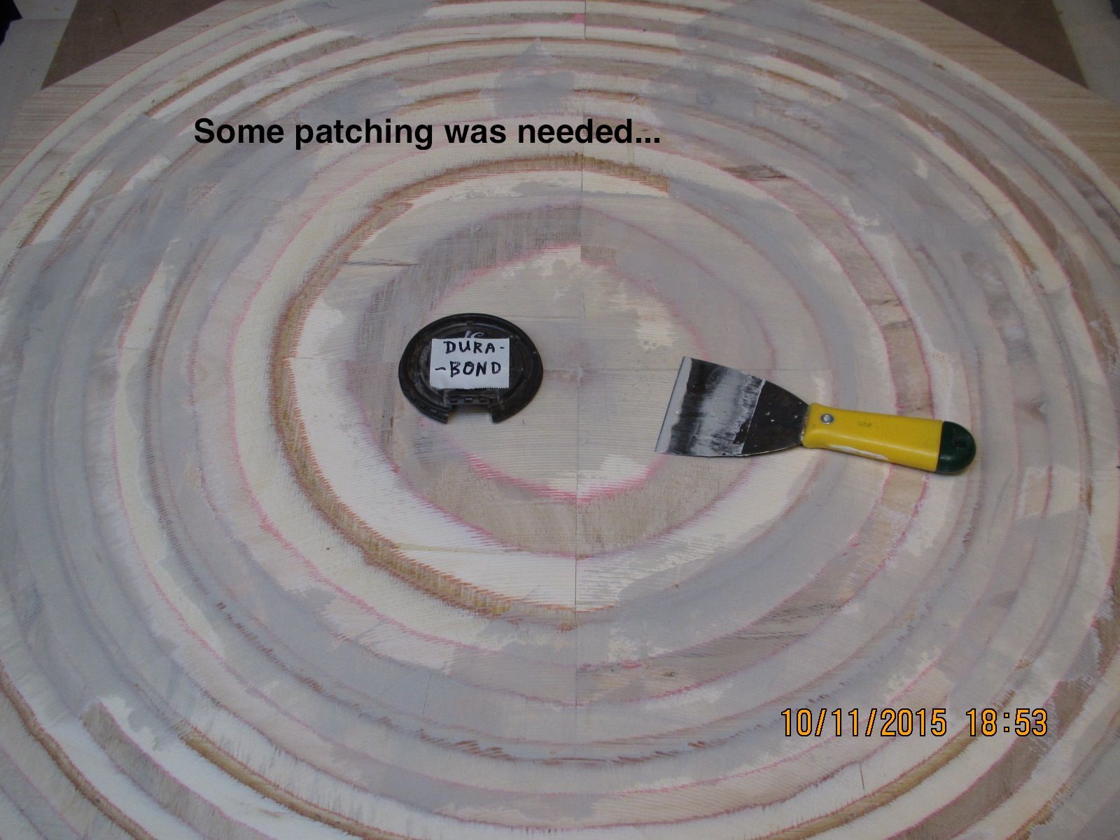

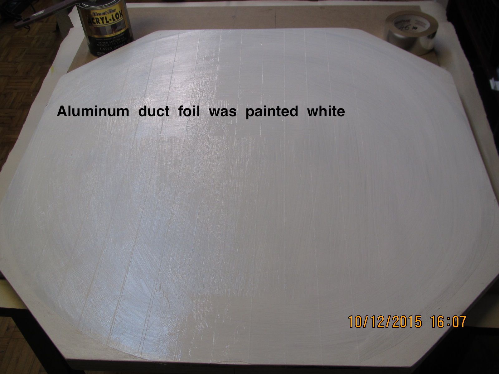

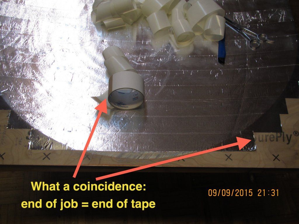

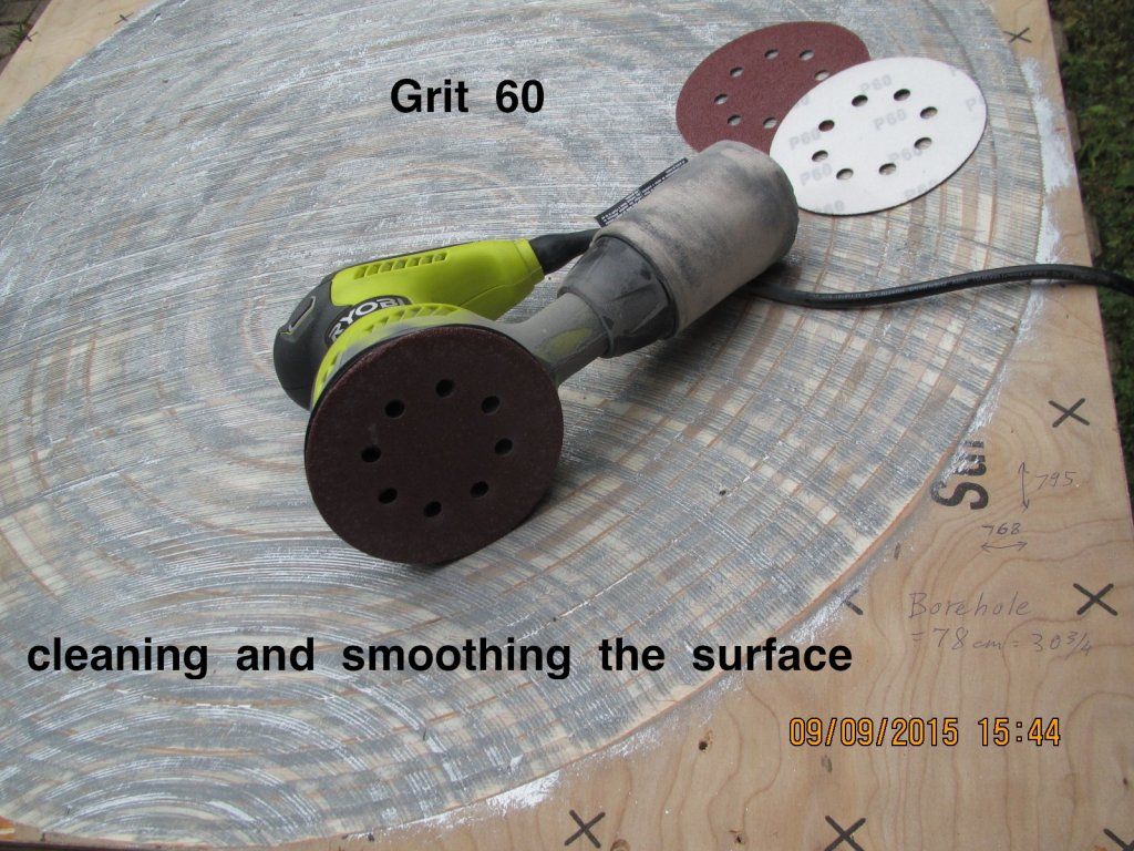

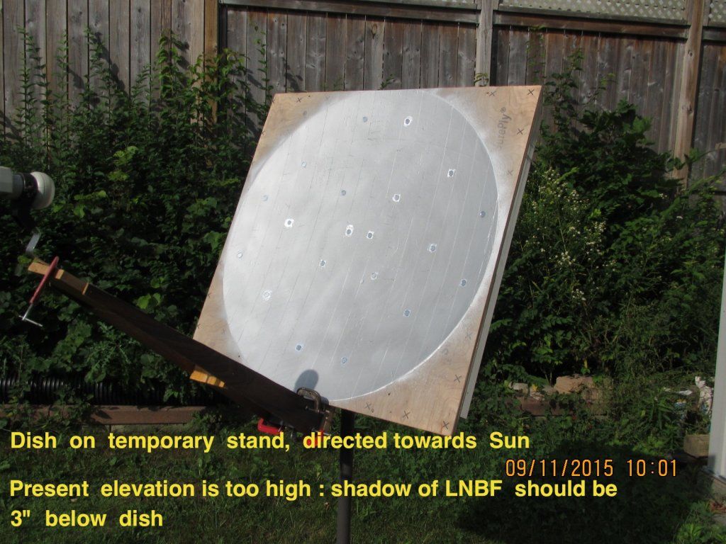

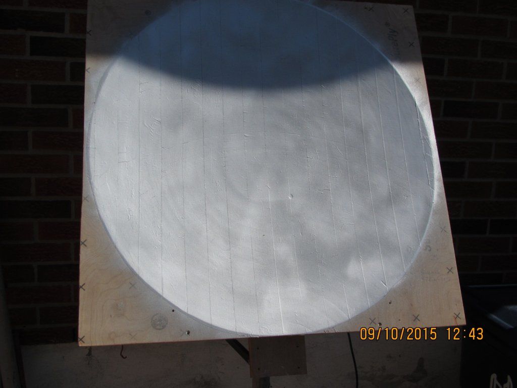

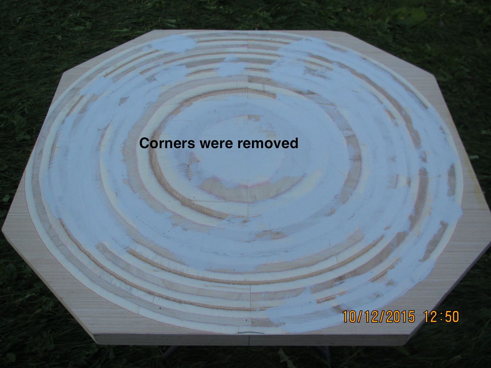

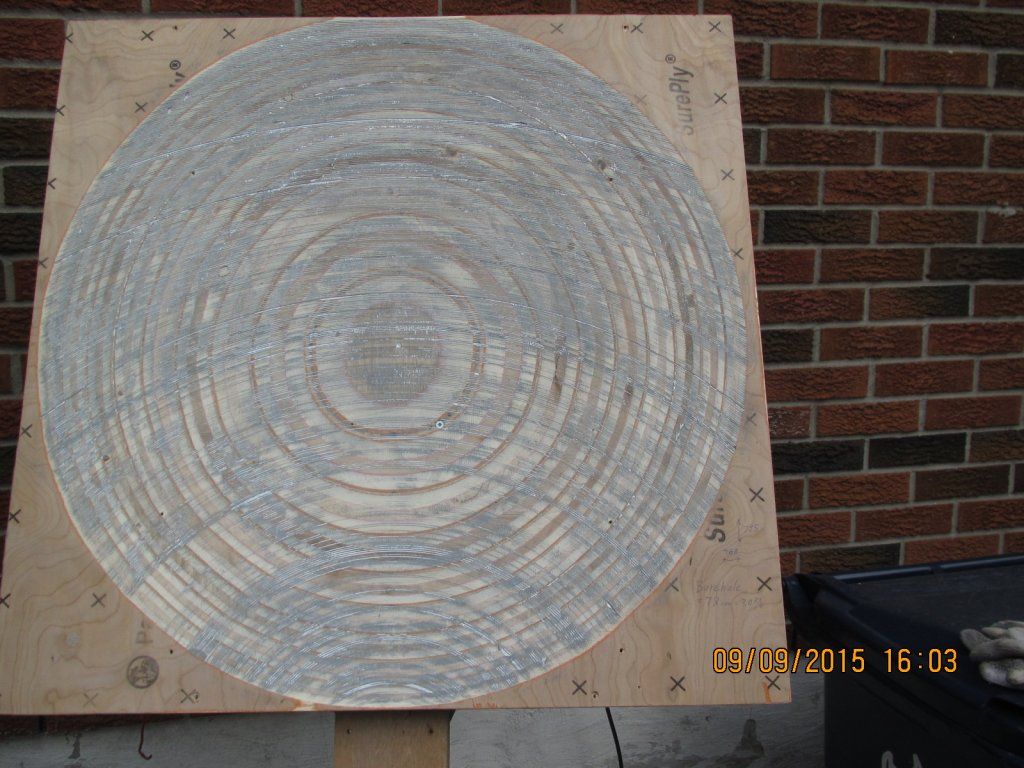

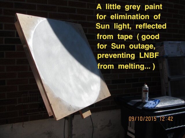

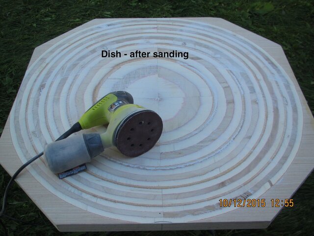

After cleaning (grinding) the dish, I was thinking about 12" wide aluminum kitchen foil and contact cement, when I found a leftover from metalized duct tape.
Was not sure it would be enough, but gave it a try.
Kitchen foil is 15 microns thick, and duct tape - 42 microns.
IMG_1783.JPG IMG_1784.JPG IMG_1785.JPG IMG_1787.JPG IMG_1788.JPG IMG_1789.JPG

Metalized duct tape. Forgot about that! Used that on my failed salad bowl reflector. Yours has a MUCH BETTER chance of working!

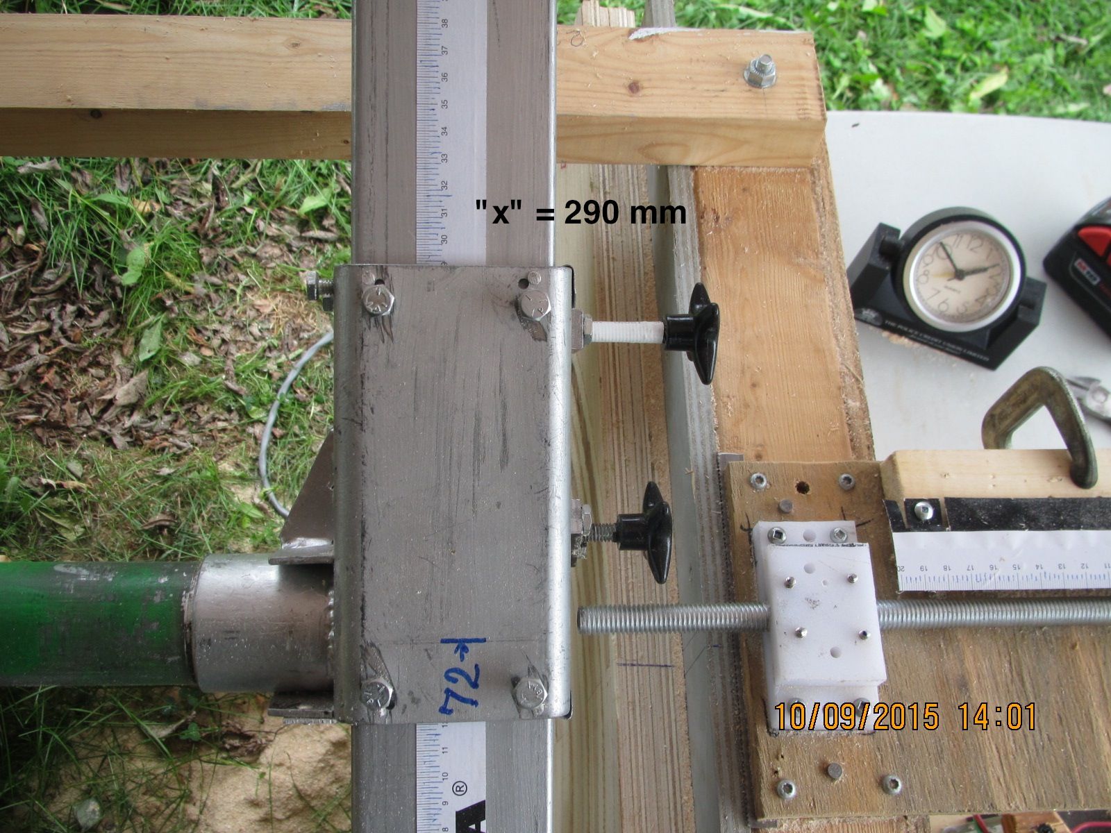

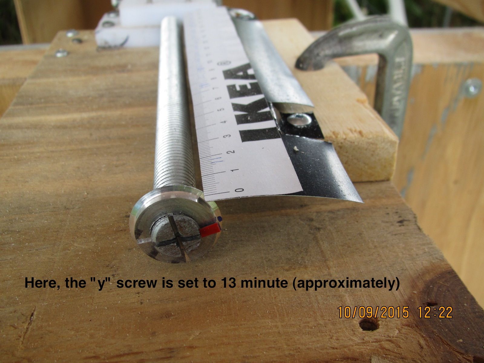

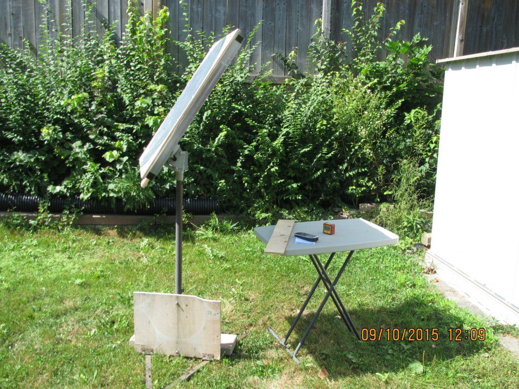

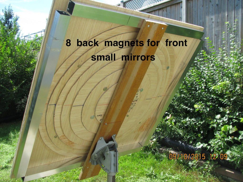

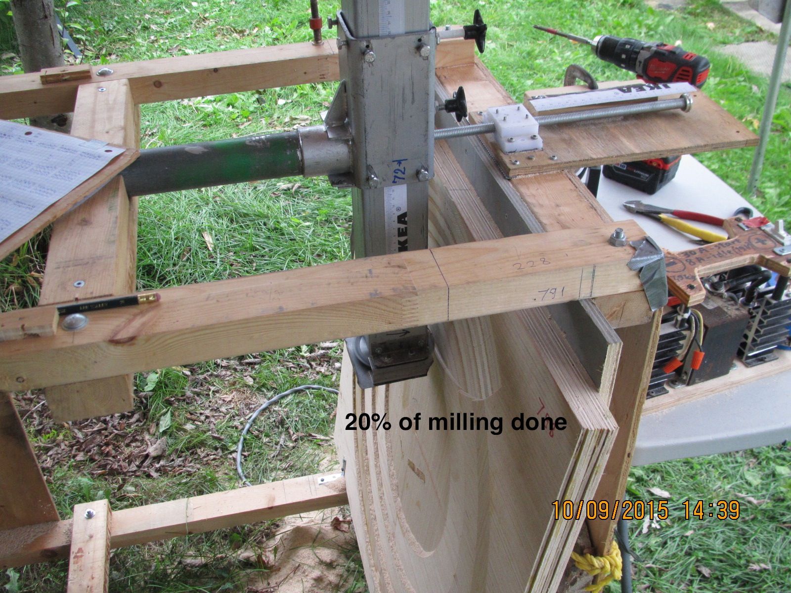

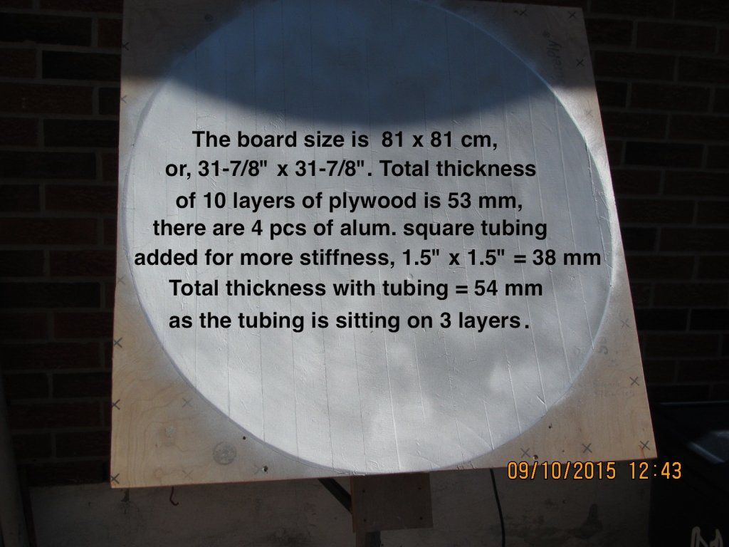

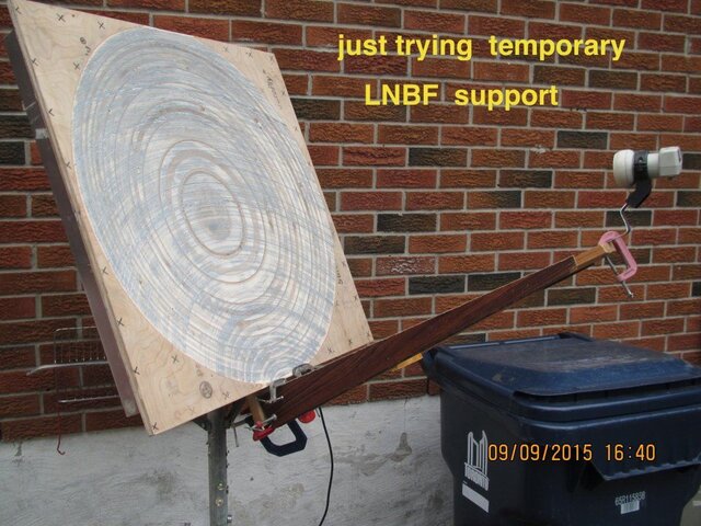

Neat polgyver. How wide/tall/deep is it?
GA

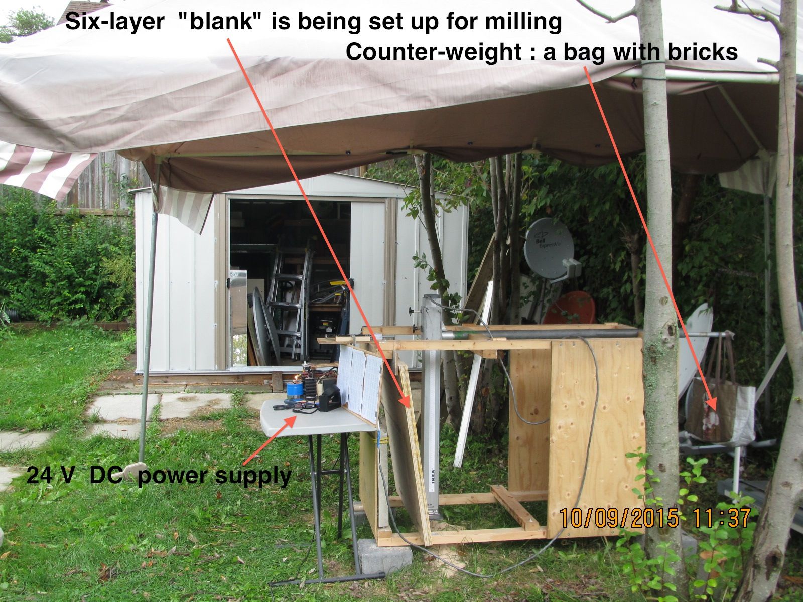

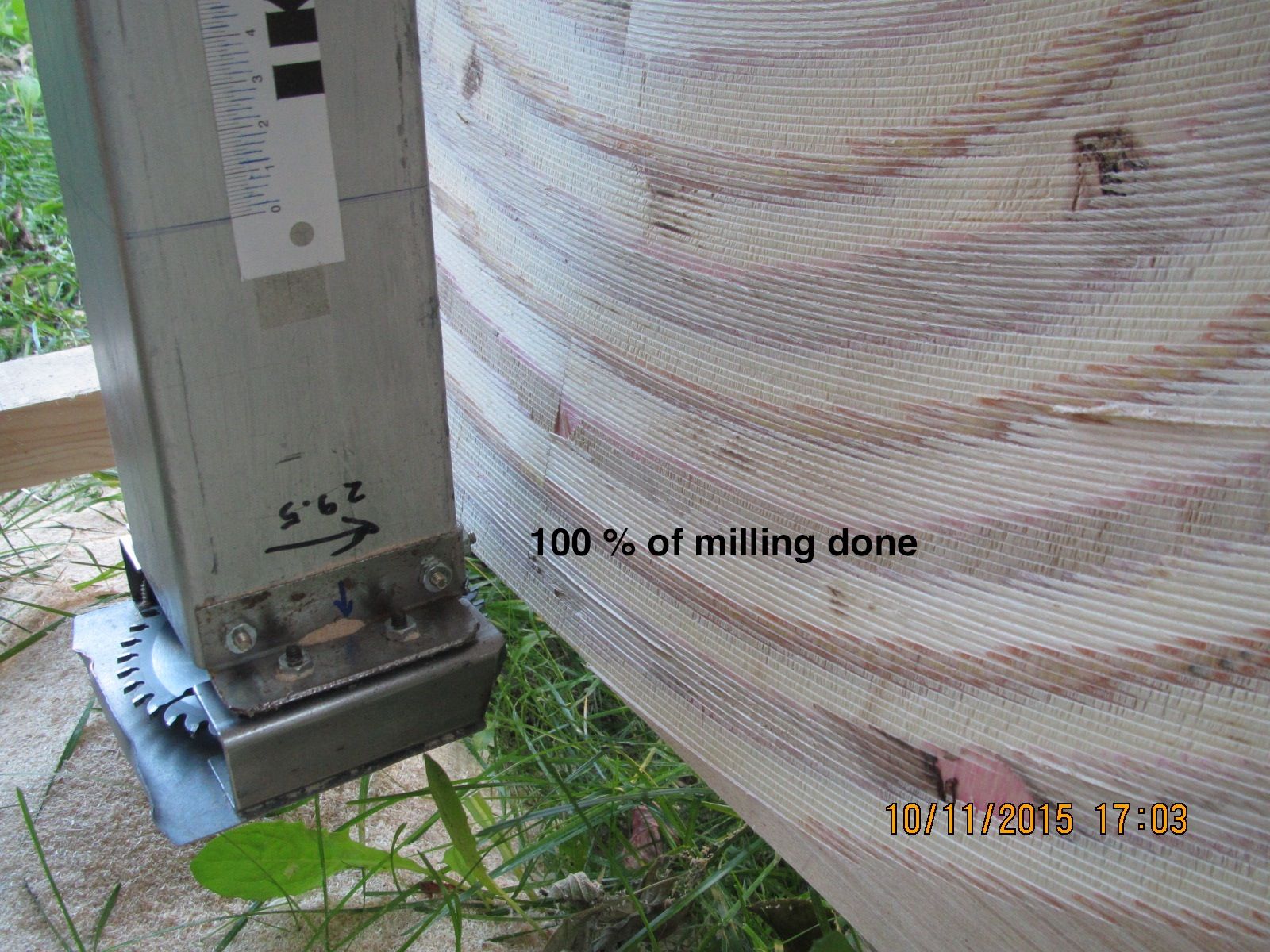

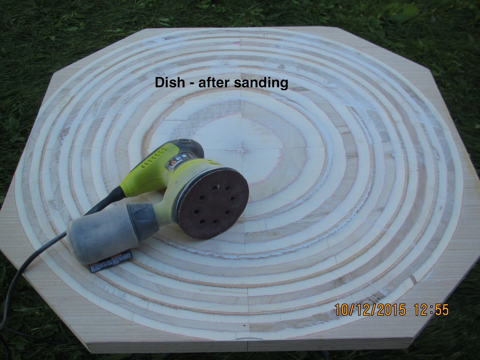

The dimensions are on picture below.

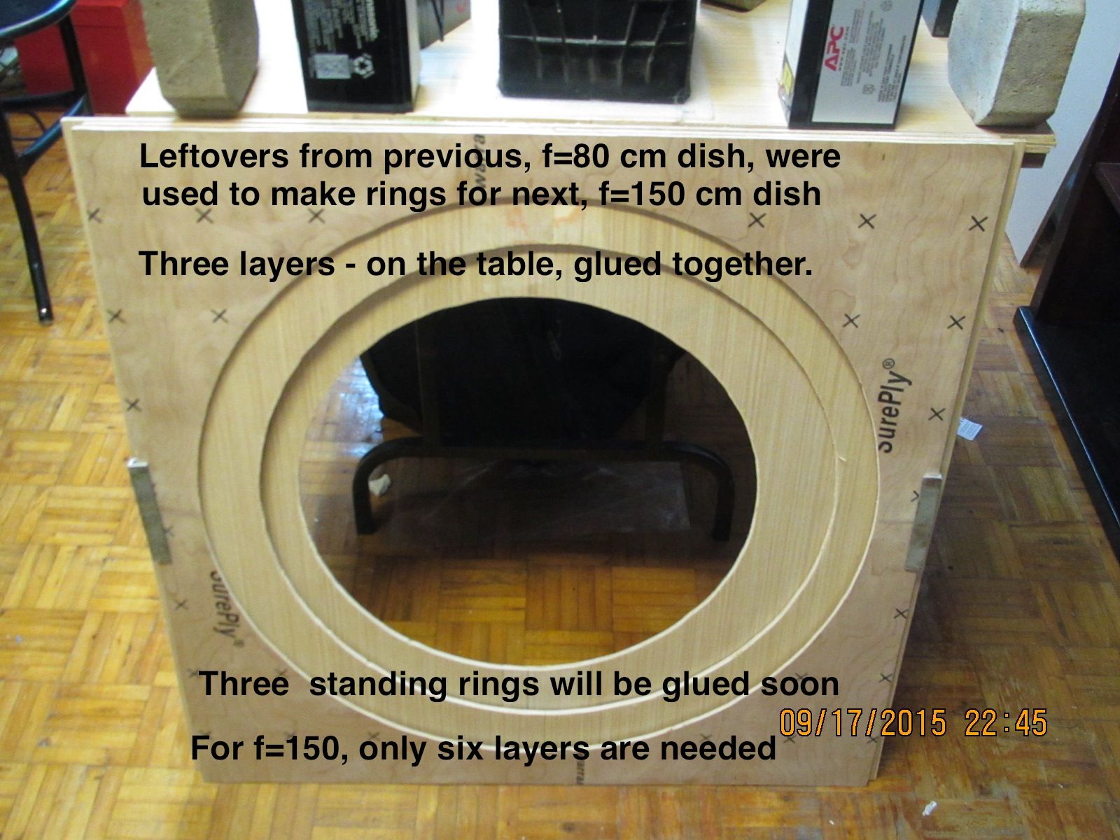

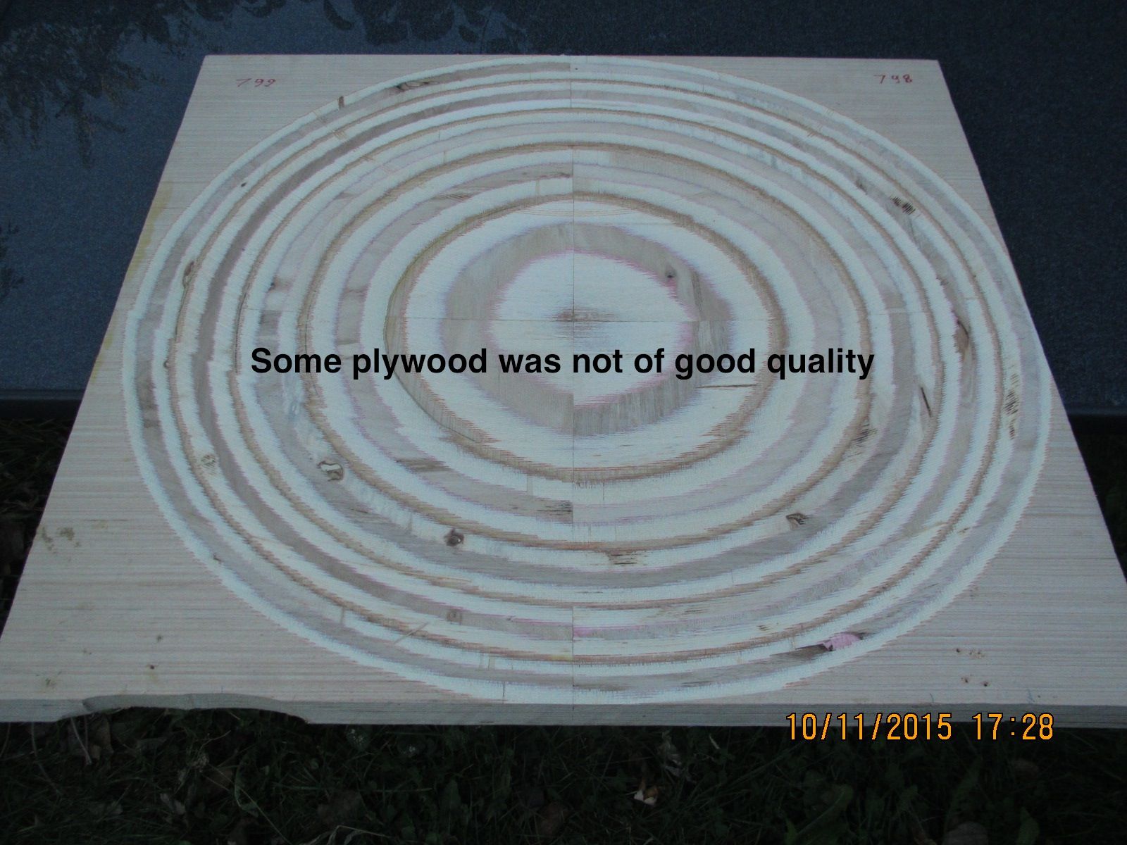

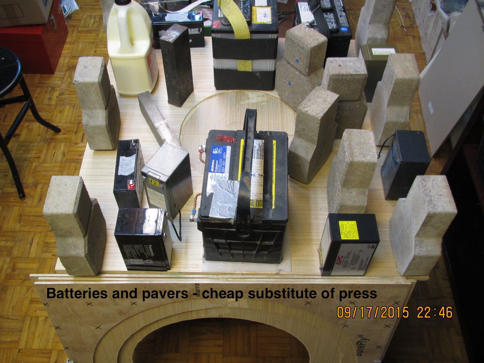

I used 3 pieces of 4'x4' tile underlayer which is sold in Home Depot, about $13 for a sheet. I cut off 16" straps to get 32"x32" squares. Three squares were enough to cut rings and circles for one dish( 10 pieces ).
Probably the remaining 16" straps could be butt glued to make other 32"x32" boards.

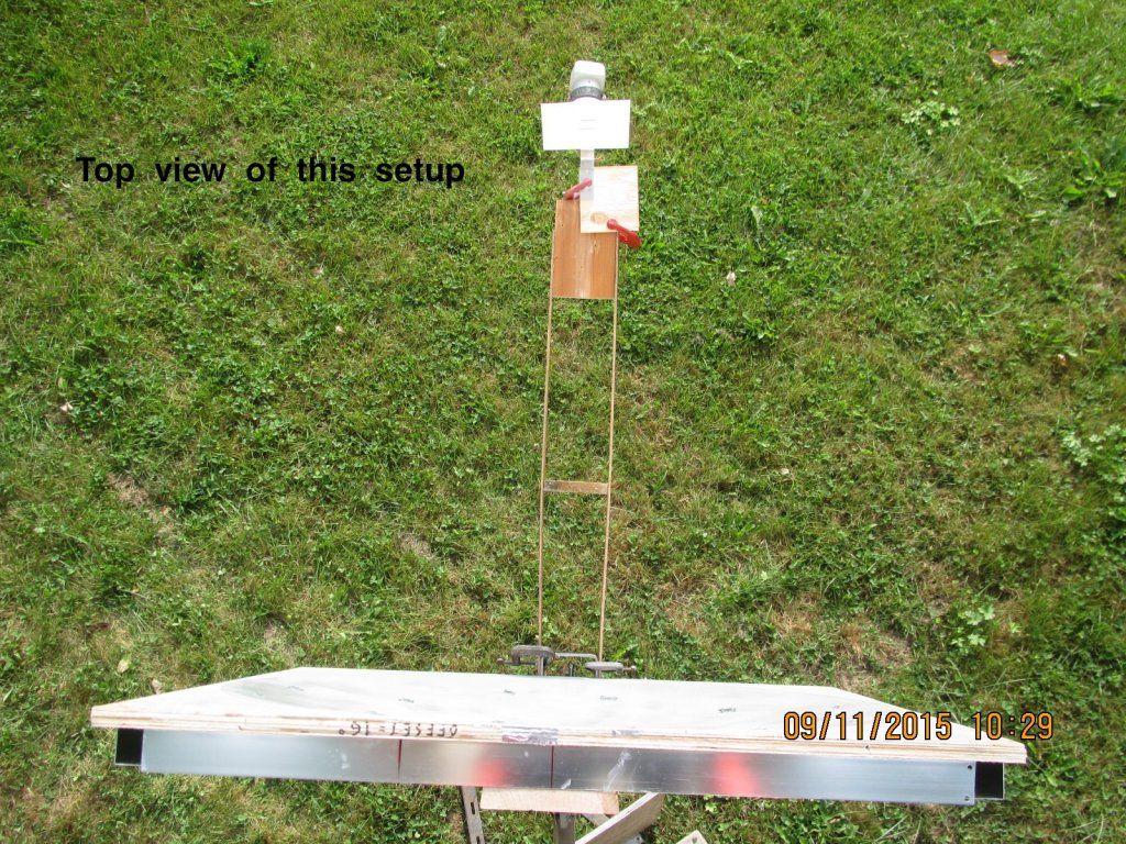

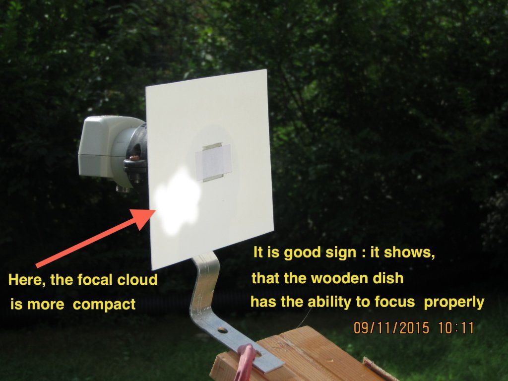

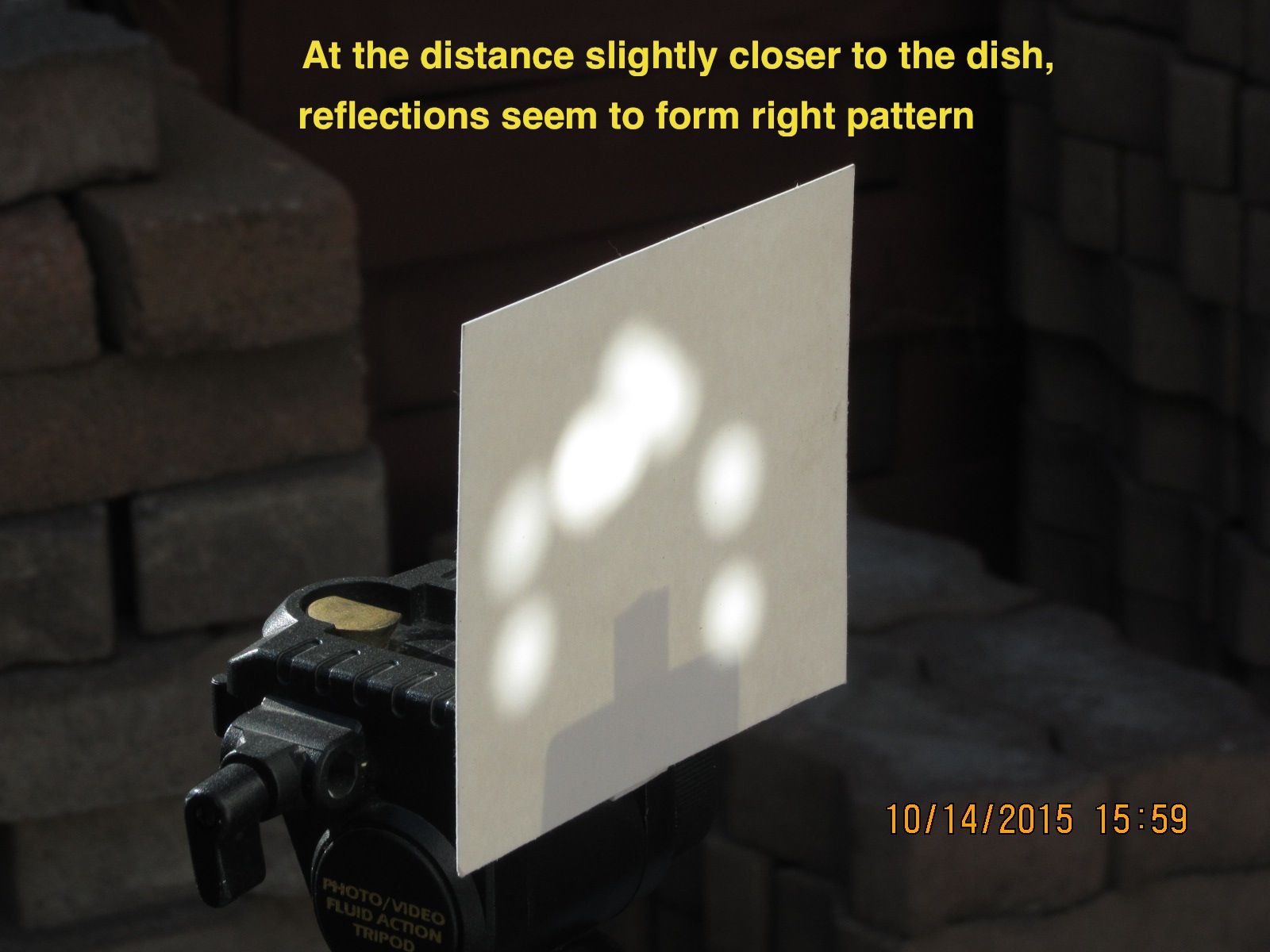

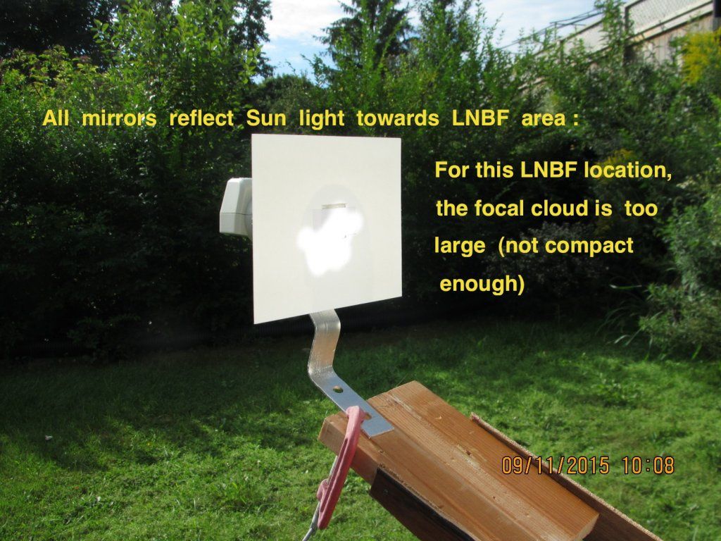

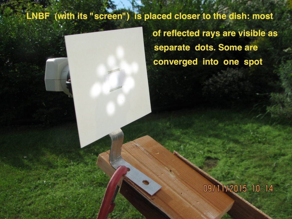

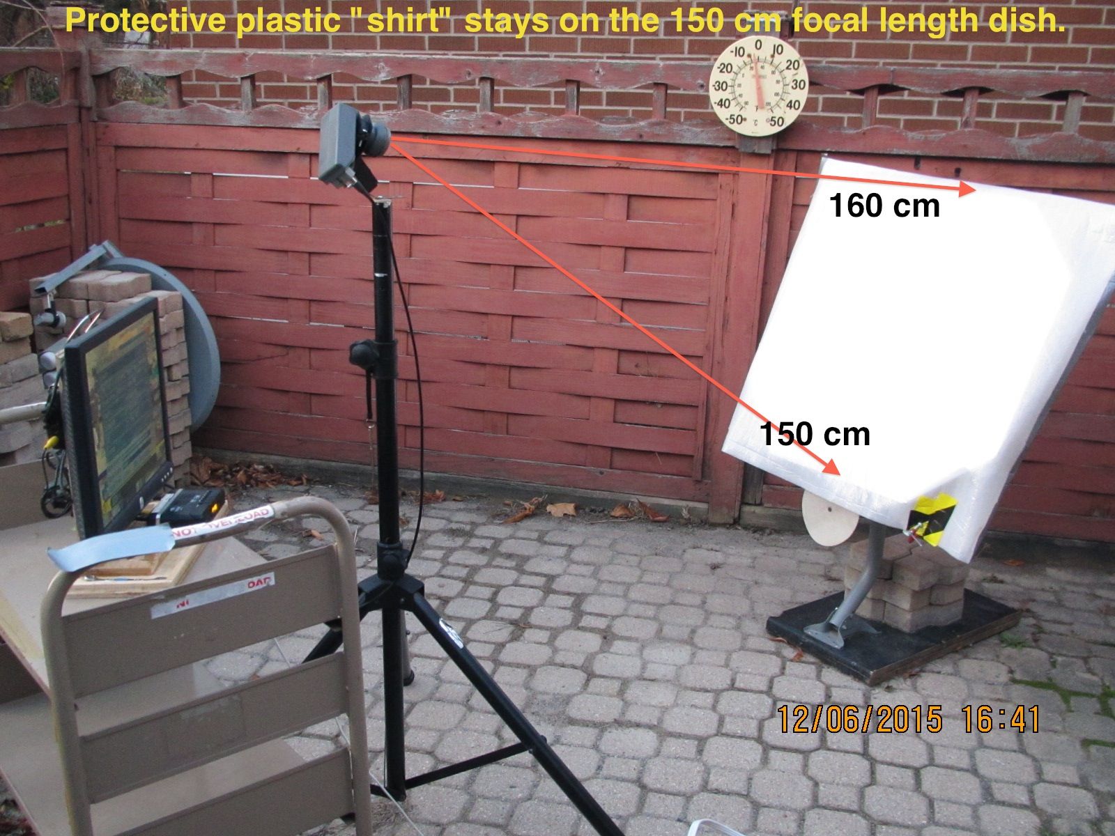

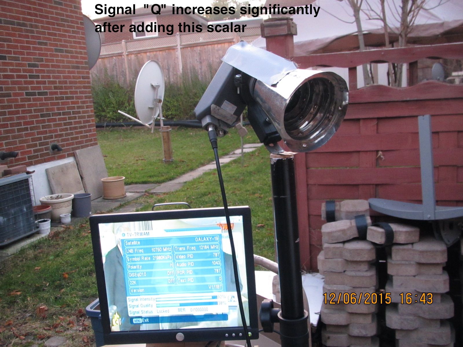

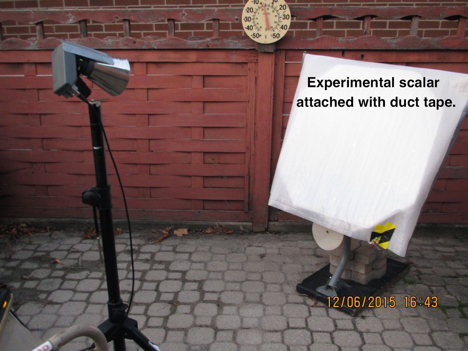

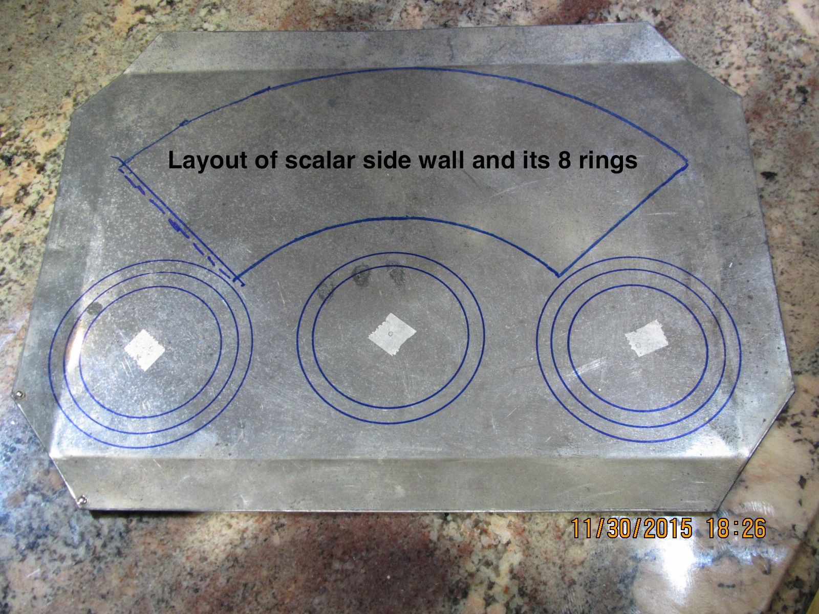

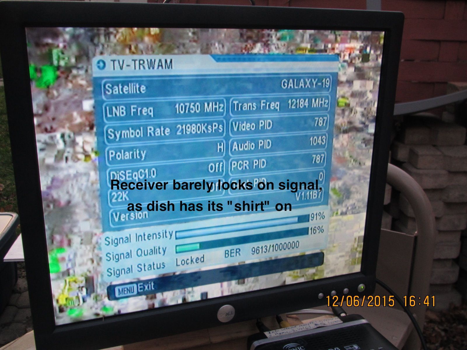

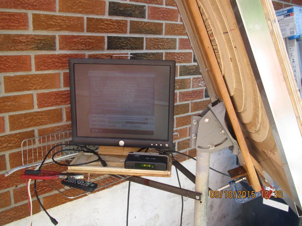

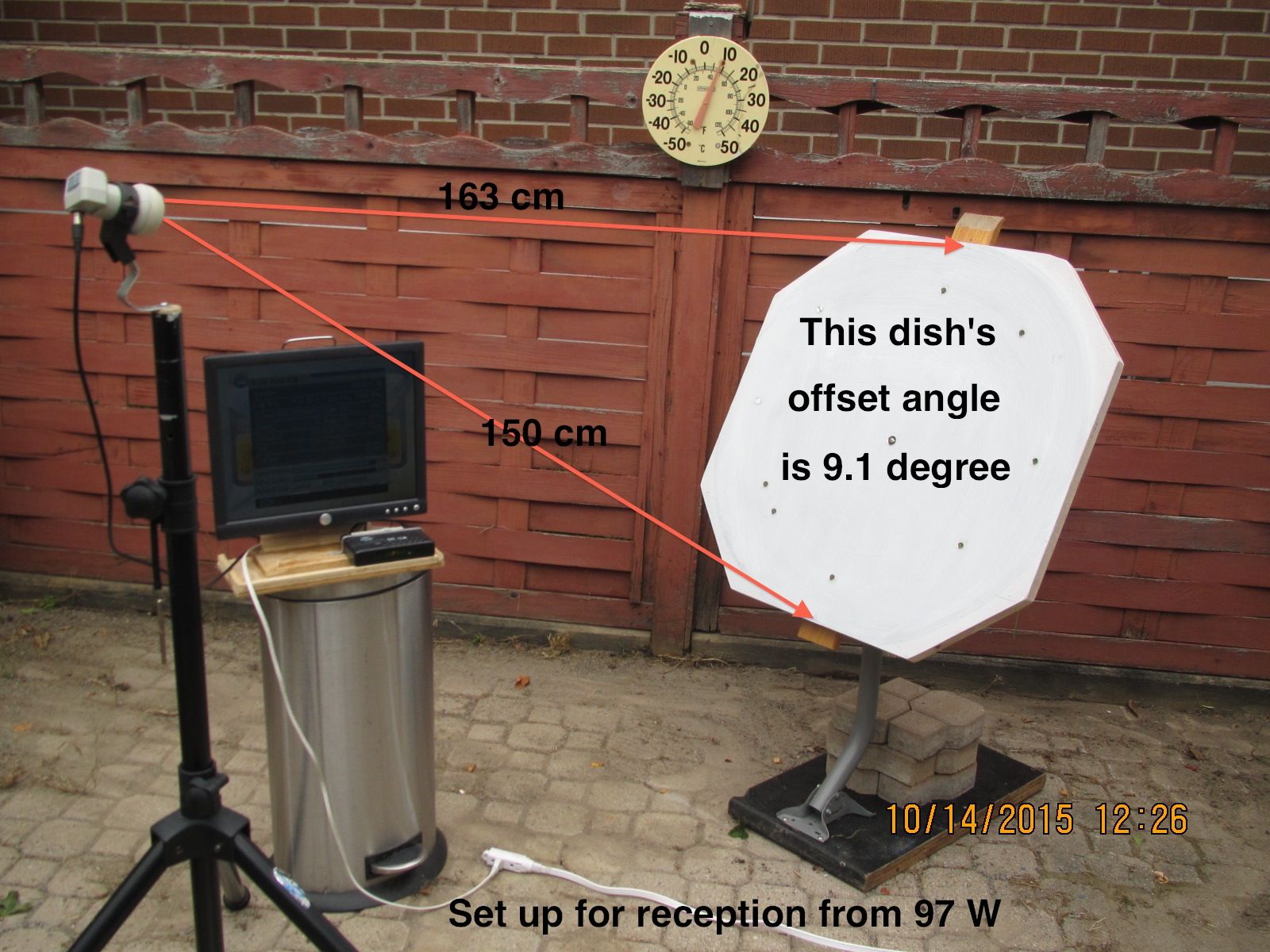

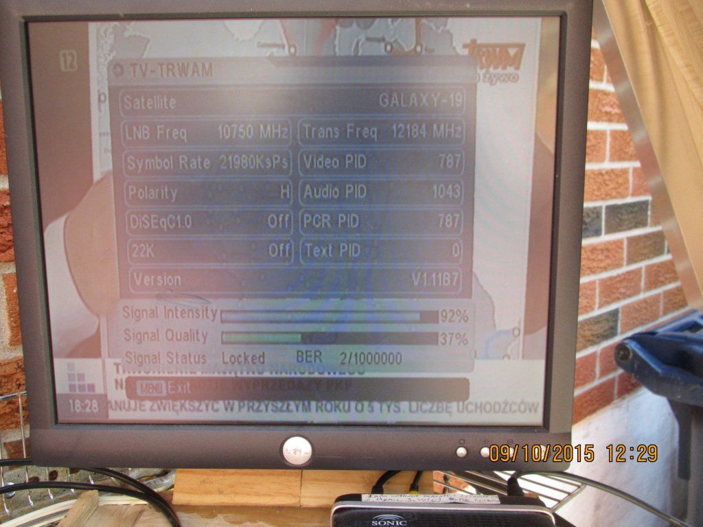

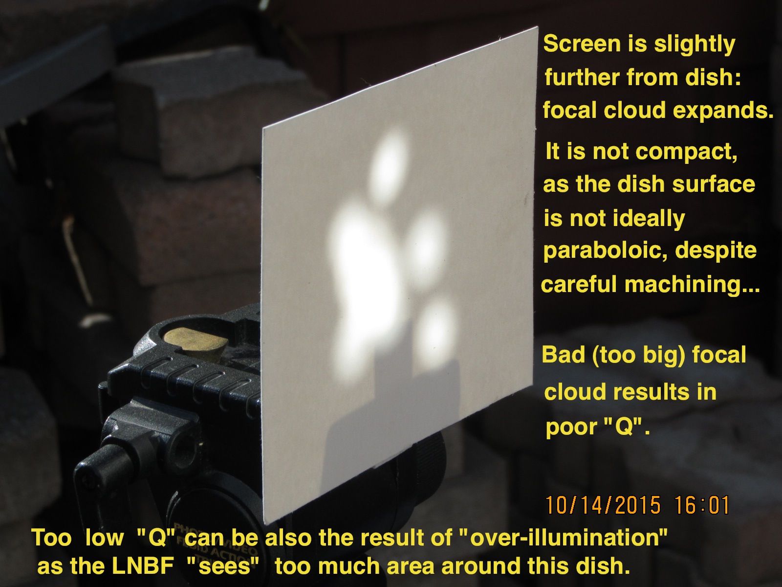

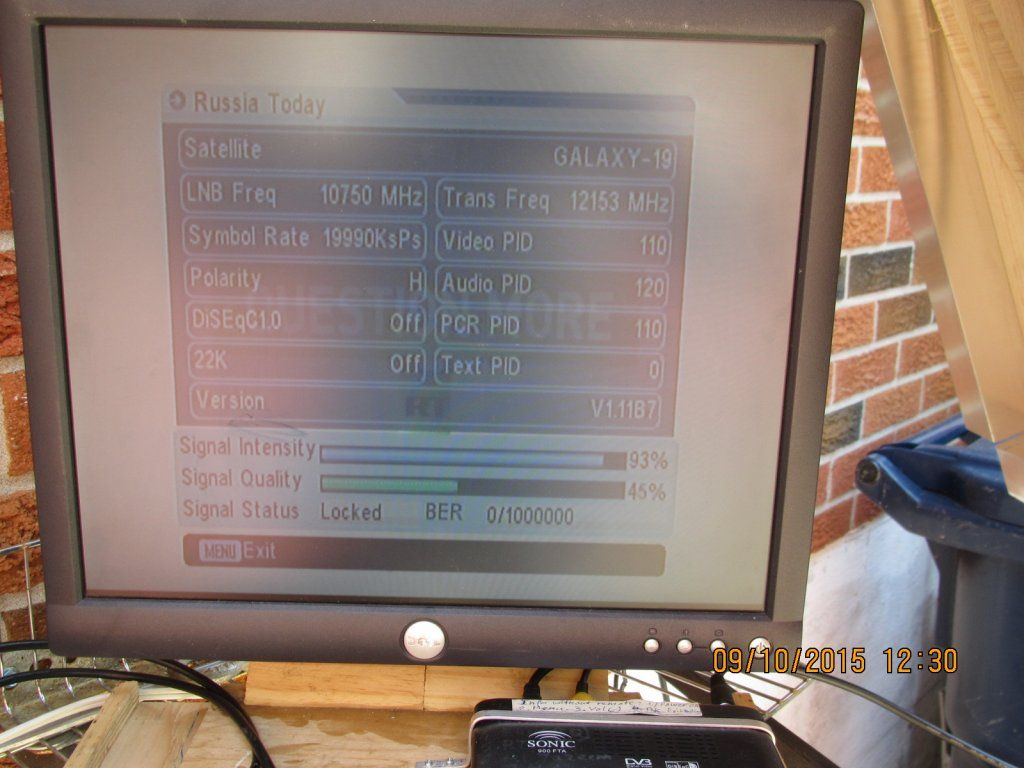

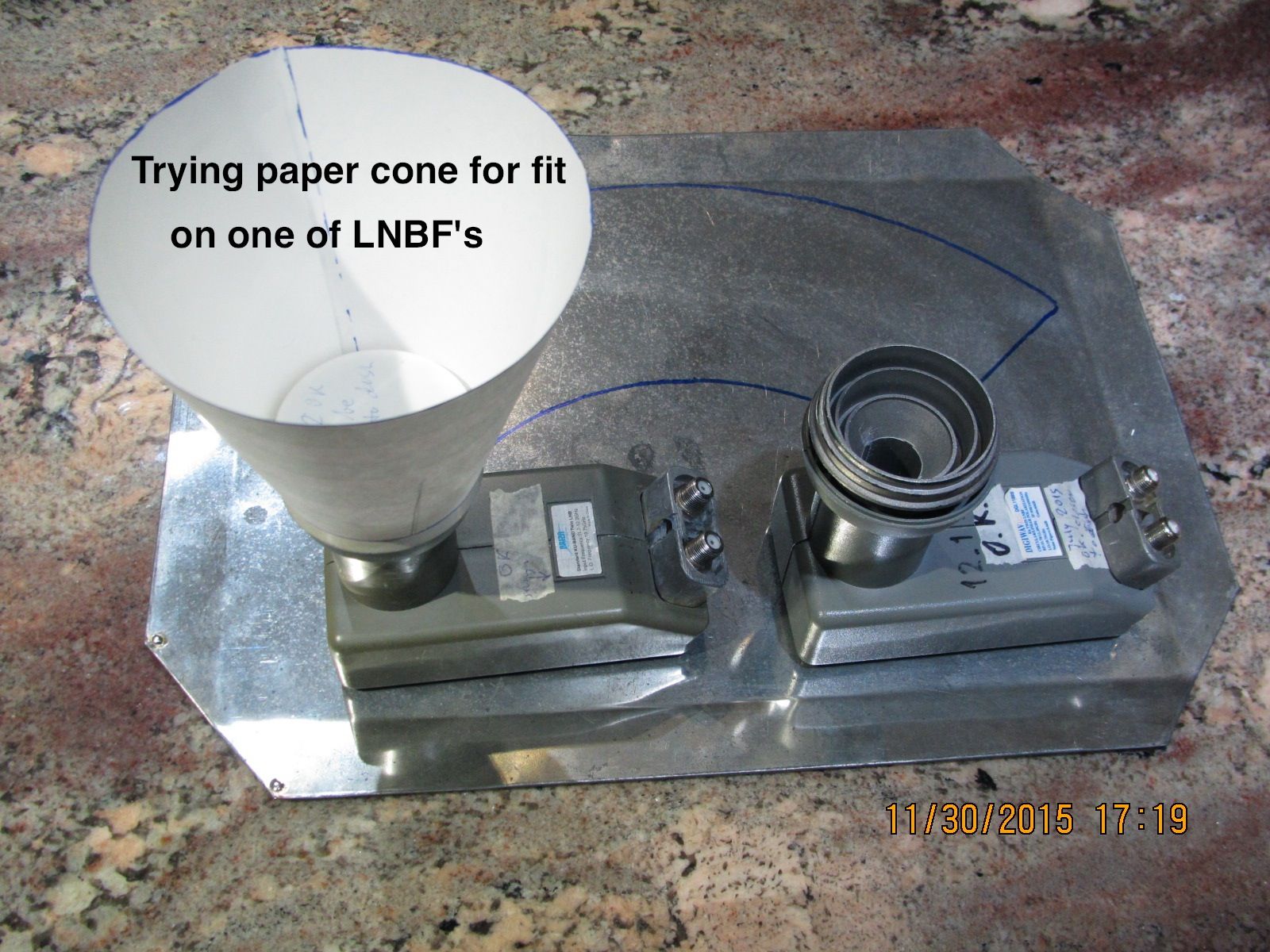

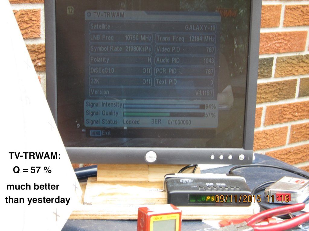

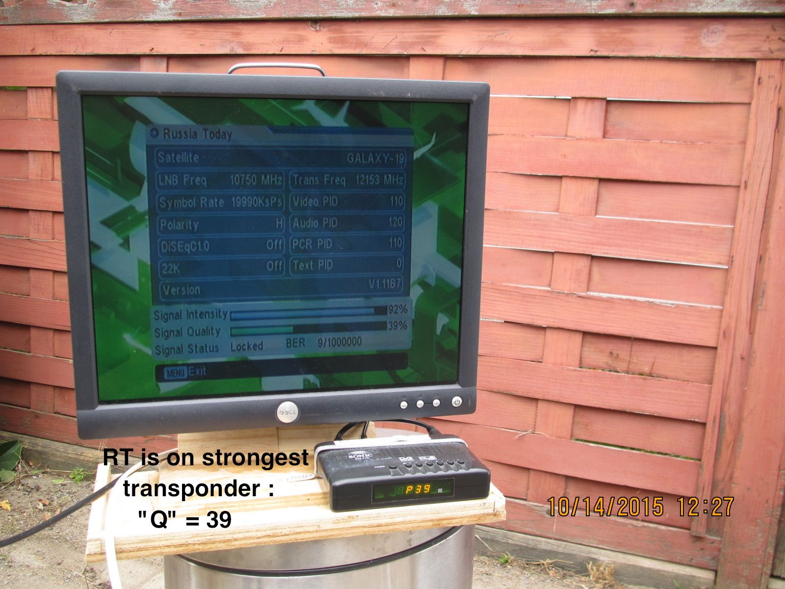

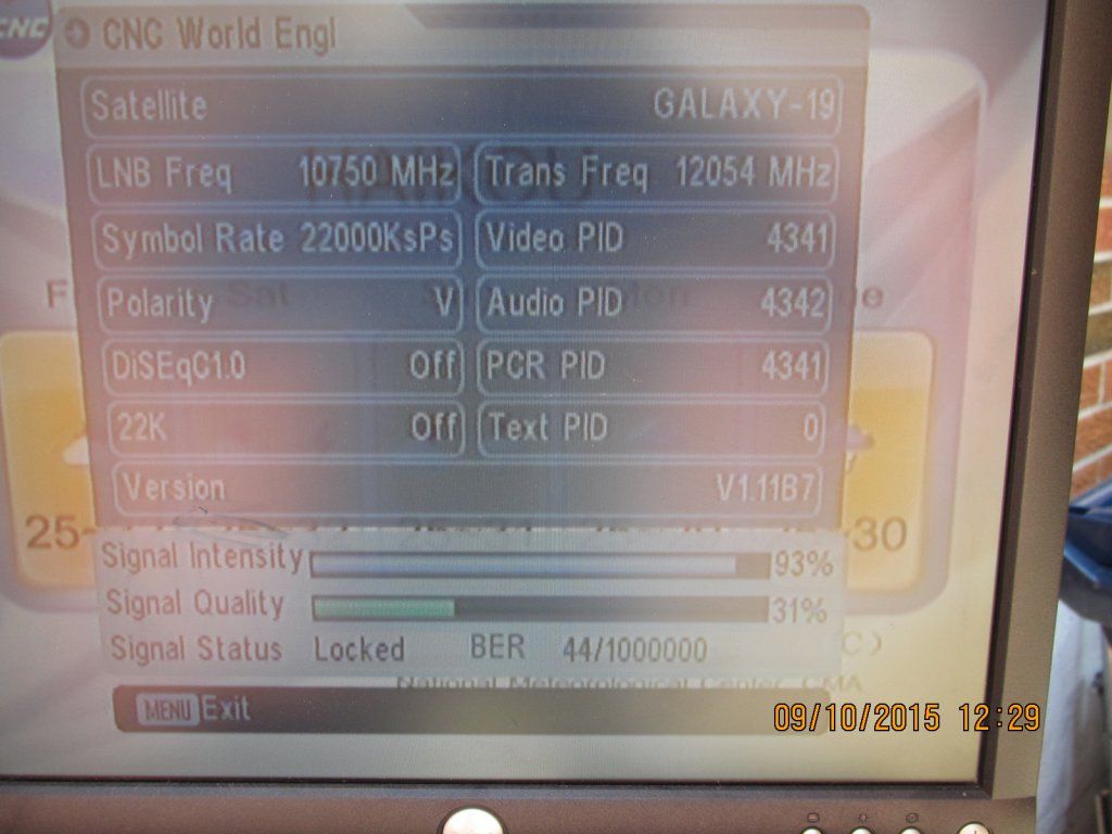

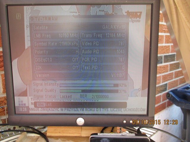

Looks like you need an adjustable scaler and feed horn for these long focal distances. Extending the feedhorn (tube) in front of the scaler would possibly accomplish this.
Also have you tried checking the alignment when the feed-point is off-center such as if using multiple feed points? Might be some areas where the reflections might be a bit tighter...
Reactions: polgyver

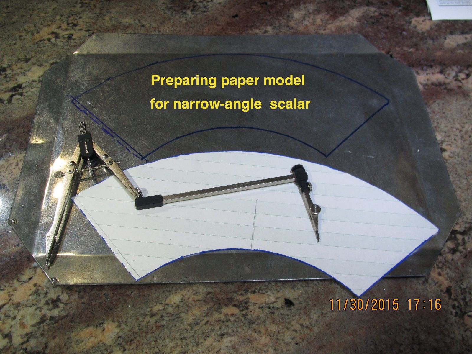

Agreed on the need for a specialized scalar. The current f/d .5-.6 LNBF is likely illuminating 300-500%+ including the side of the house! :D
I had posted some papers on scalar design and calculations in an old thread. Will try to locate the link. Should be able to cut off the existing scalar and fashion scalar rings based on the extreme f/d.

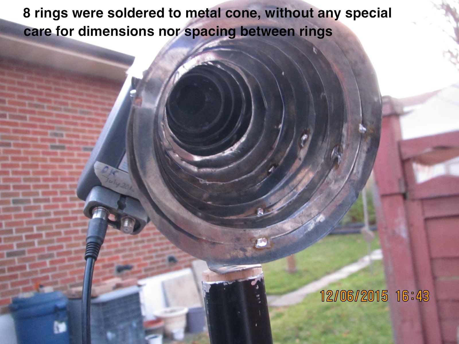

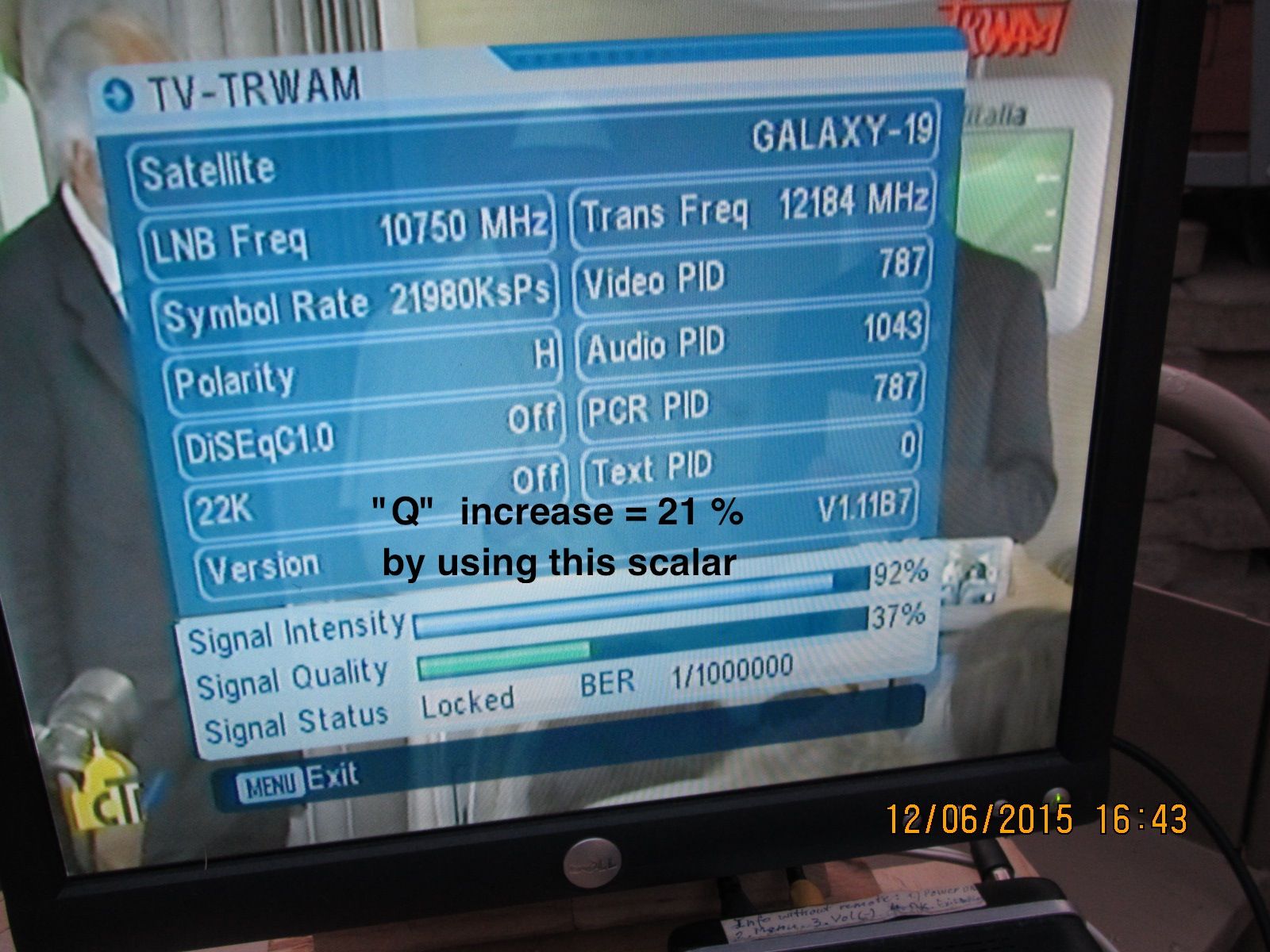

Sound advice, in posts 30-32 Thanks, Cham and Titanium...

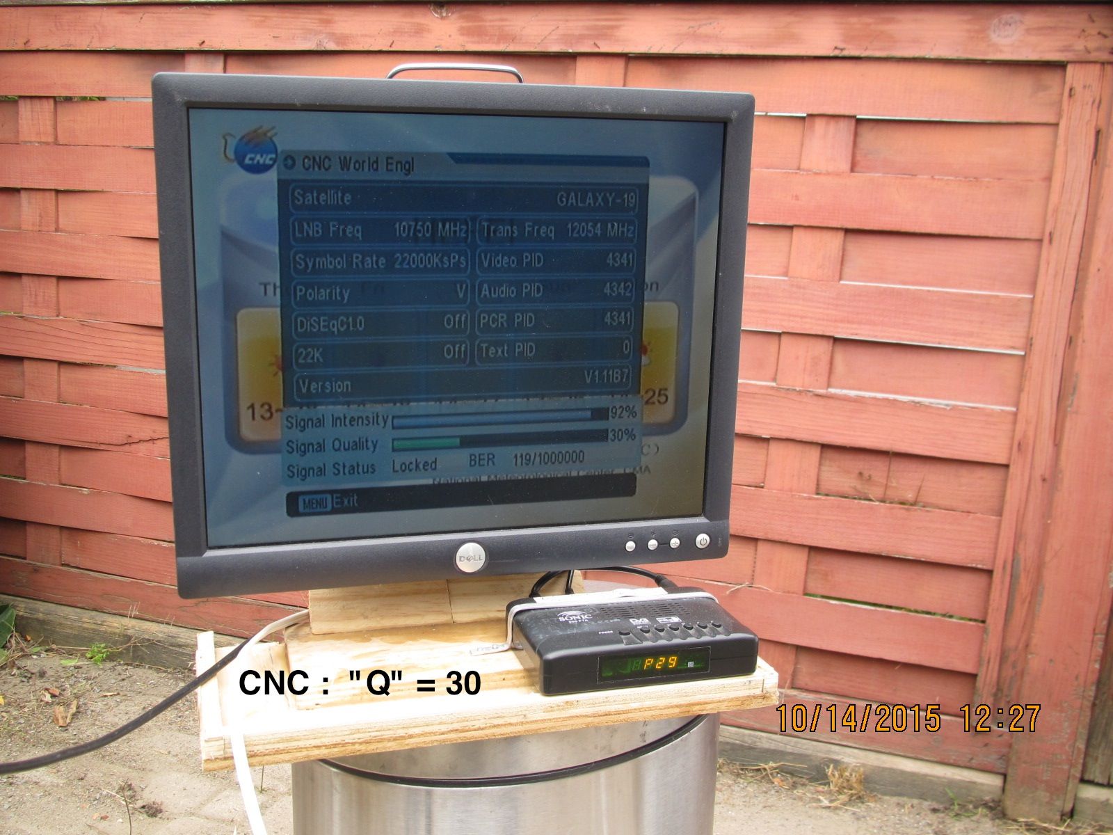

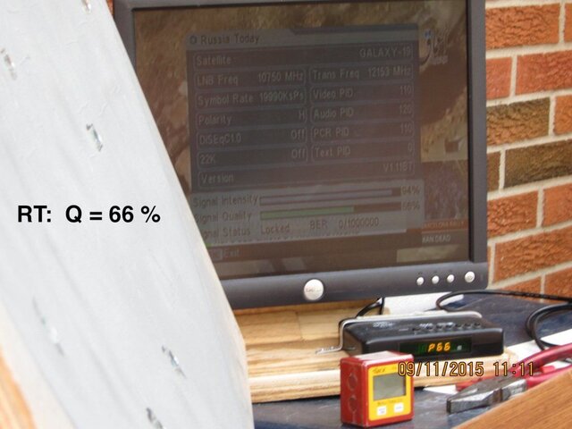

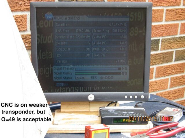

The scalar I made is -surely- shabby, but it helped with reception.
I wish I could learn more about designing such scalars, instead of trying intuitively with parts...
IMG_2786.JPG IMG_2788.JPG IMG_2789.JPG IMG_2815.JPG IMG_2816.JPG IMG_2817.JPG IMG_2818.JPG IMG_2819.JPG IMG_2820.JPG
Amazing polgyver, and a beautiful piece of woodwork. You definitely think out of the box. Good luck in perfecting the dish. Beautiful pictures too.
