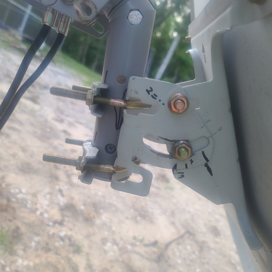

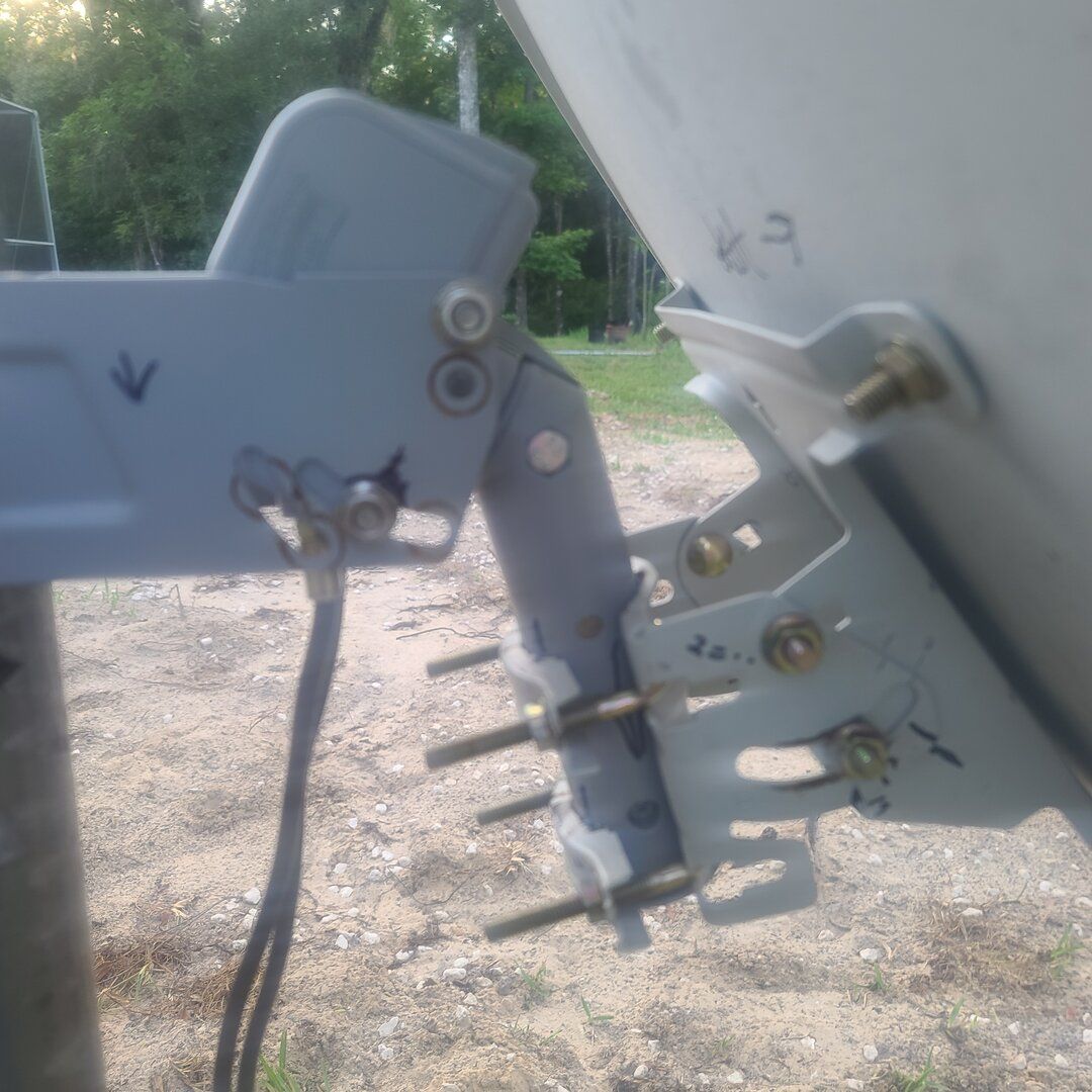

I just moved everything on the pole to west
Just scanned 97 west got 97 west just did 99 west got 99 west. I tried 87 west again found transponder but failed getting any channels same with 89 west got transponder but failed to get channels
You're getting close. Perhaps try moving the lnb slightly by moving it in or out a tiny bit while aimed at 87w
I moved the everything back to original (I marked everything marker) then I turned only the dish I got 87 west a little bit I got 1 channel DC channel and FLCH
Move west more?
I'm right on the verge of getting 87 w just a little to much each way moving dish I need to be more gentle. I was a heavy equipment mechanic for better than 40 years.Retired now It's not like torque a head on cummins....

Draw a pencil line on the post, to the dish mount. The thinness of that line is about how far you make moves... Having a line there for reference helps you a lot.

I think I've got it or super close now.
I took it apart centered then re aligned the stab to south best I could.. then I found there's a tab sticking out on the dish to hold it on top of a pole.. I cut it off grinded it smooth. Put everything back on started scanning and I'm getting a bunch of satellite now, and the ones I don't get it's picking up the transponder but no channels. And one I don't get at all it goes real slow scanning as opposed to before it I zipped straight through 0 to 100% in a second.. that's what I've picked up so far and still scanning.
And it's getting the correct one's 97 west is 97 west etc. 103 is a fixed dish the rest are on the stab

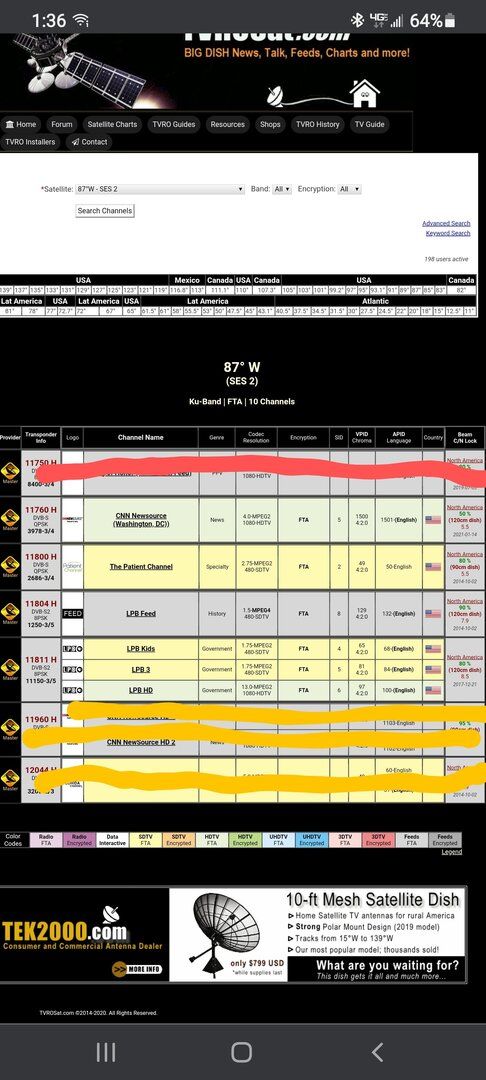

I just scanned 87 west only got DC channel so I'm still off need more west or more elevation on dish?
At 10 total satellite
I did some changes in elevation did re scan got all but 3 of the channels 87 west .
Patient channel real strong... got all but these blanked out

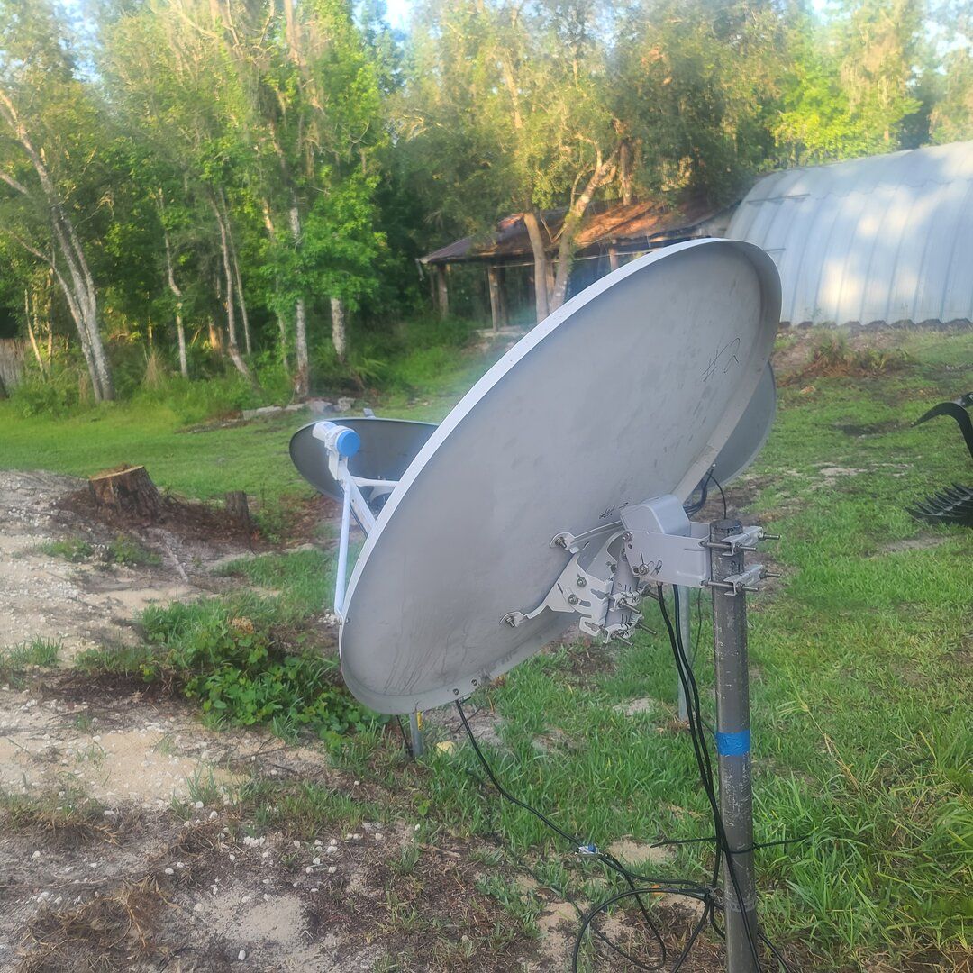

Same issue lose signal between satellites. Took off switch ran direct same problem..

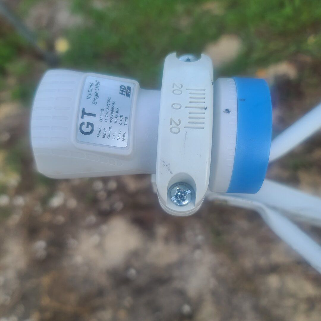

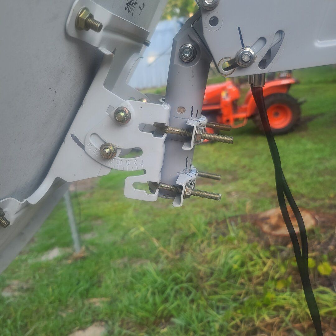

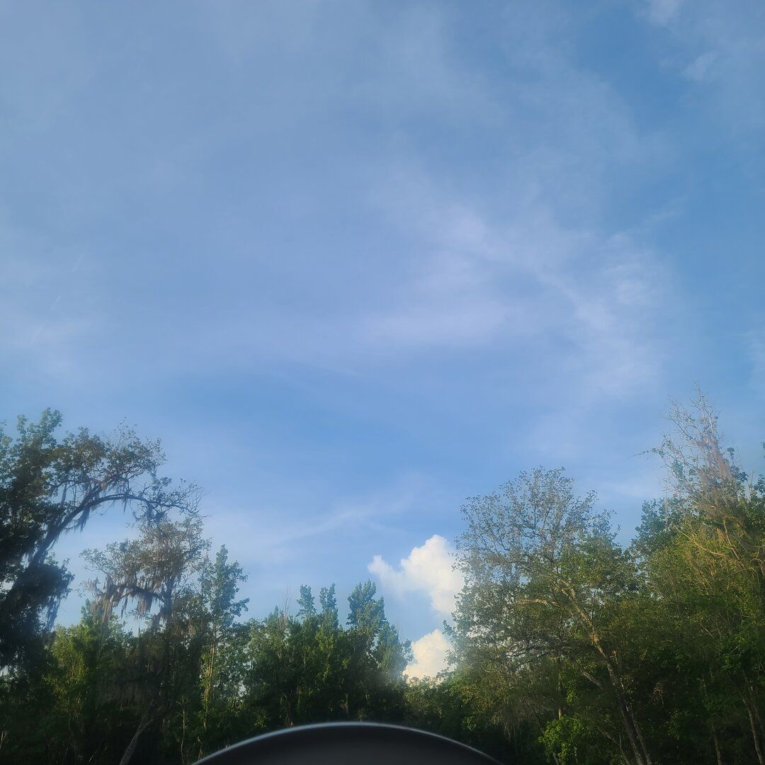

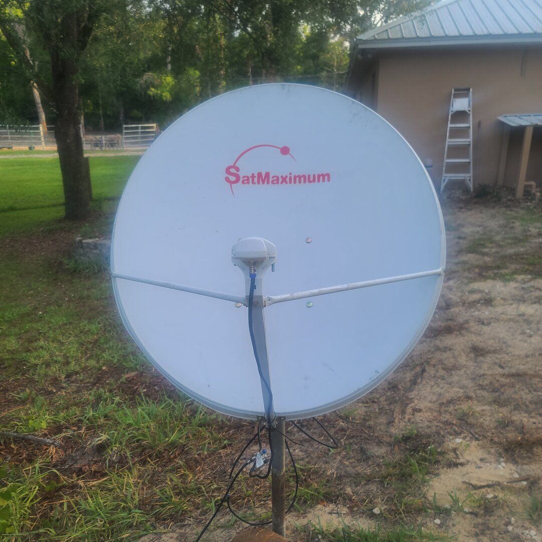

Below is pictures of the setup I have also clear skies see pictures.
Don't know what to do..

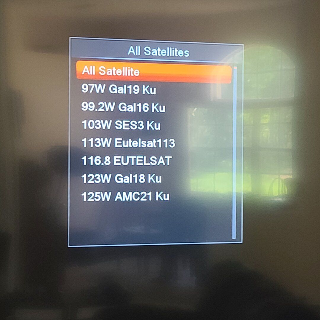

Sa.e as before scans fine good signal good quality pictures. Go to next satellite gone no signal. Do the set up for re scan and same thing it comes back???

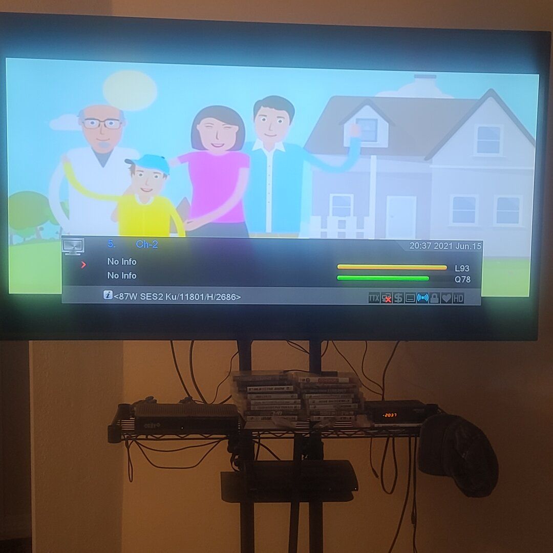

Good signal ....see picture 87 west patient channel....

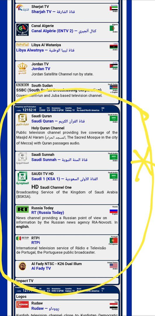

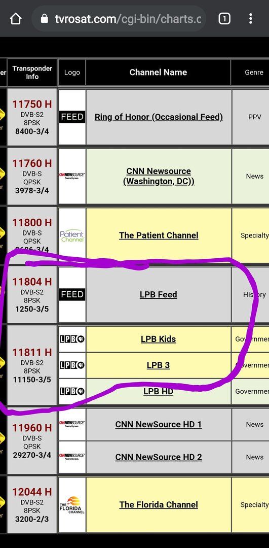

This is what I get in 87 west manual scan . So am I to far west or not enough west or elevation? I get 3 of 3 PBS channels
So where do I need to be more elevation or more west or east? Also picture is what I get on 97 west manual scan. It seems like I'm right in the middle..

I'm about 96.5432 % certain my signal lose was what I said. I have switch hooked up and 2 dish on the switch the stab and a fixed dish. 0 issue going back and forth since I didn't do any blind scan
But I know I'm way off. Just need some guidance on how to finish lining everything up

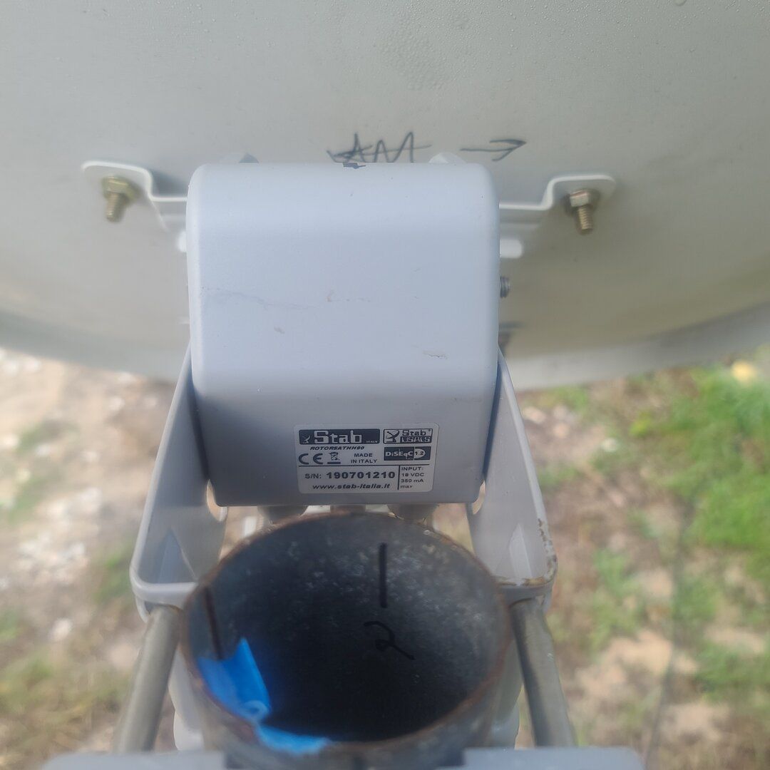

Is your dish aligned straight on the motor shaft? I had a problem with that once.
Reactions: Moosebiker
It appears to be . I just realized in reading online that you need to point stab to TRUE South not magnetic South. I did it with a compass magnetic South... found this online makes me 6° off true South
Use this to find TRUE South, find your exact coordinates on Google maps, and use that. Under the "satellites" drop-down, there's a setting for TRUE SOUTH / TRUE NORTH, find it. It'll overlay the map right on your property, and you can find True South by matching up landmarks for aiming the dish. I then used a long yellow cord and stake, and laid it out from the dish to out in the yard. Makes it easier, as it's a good "sight line" to true up the dish aim. DishPointer - Align your satellite dish
