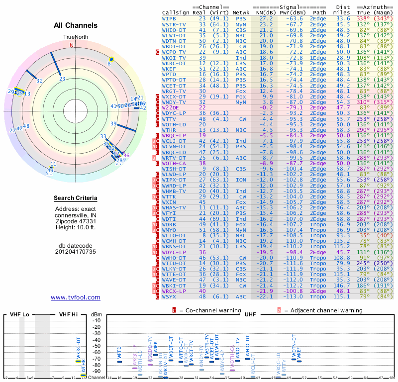

here is the tv fool report for about 10 feet off the ground.
A good 4 bay as high as you can get it should be enough for the Dayton stations. Cincinnati has a VHF-hi station that would require a larger antenna with that capability.
