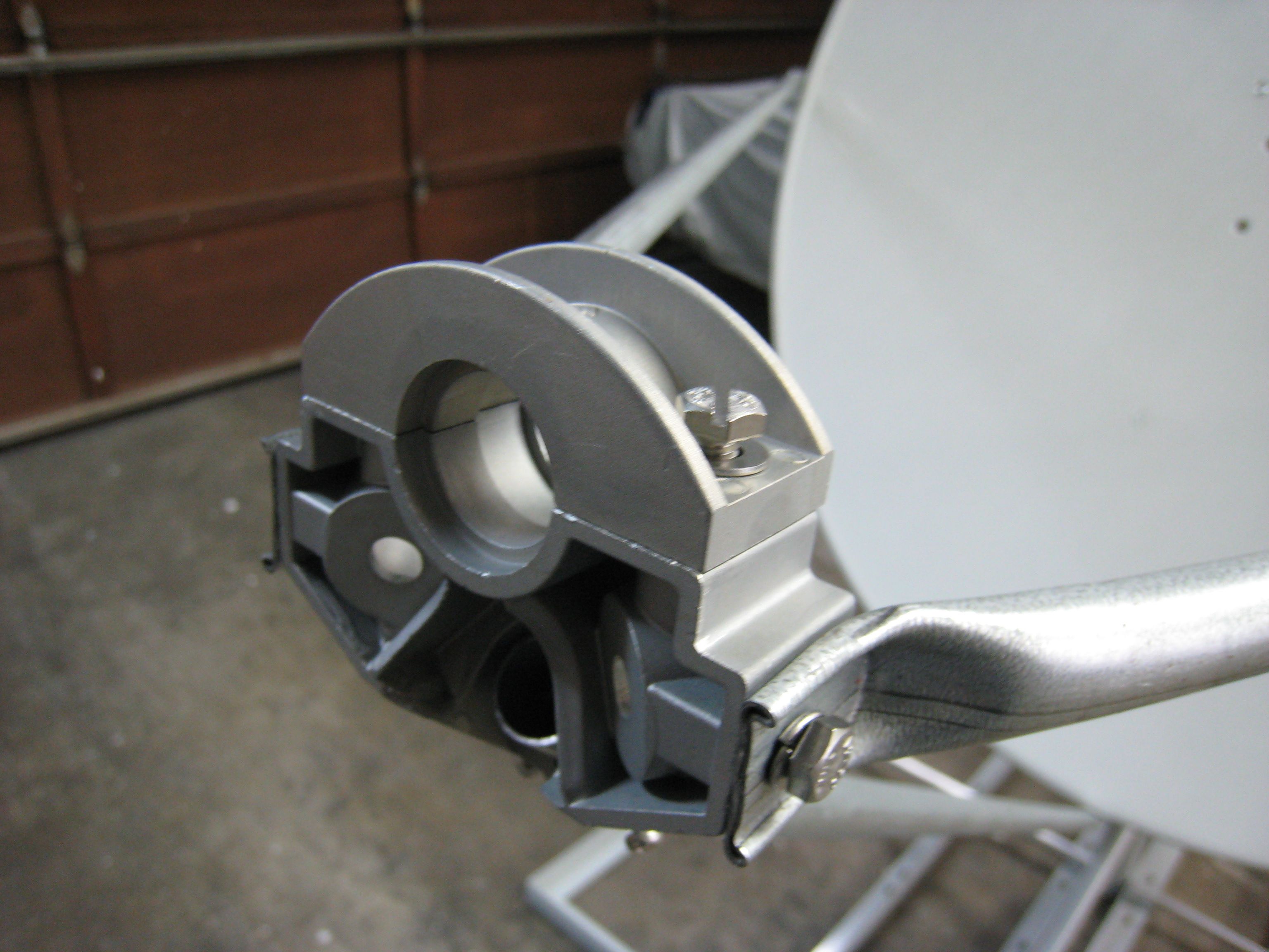

I am putting together my first FTA system and need some help picking a LNB and motor for it. I have a Andrew 1.2 meter offset fiberglass dish and Pansat 3500SD. The dish came with a Andrew Ku feed horn assy. What types of LNB's can mount to the feed horn? And how to switch between them? I have also noticed other LNBF's BSC621 or BSC621-2 and the Invacom QPH-031. Not sure which one if any would work best for my application? I'll take whatever band's I can get Ku linear / circular , C. I also need help picking a motor. The dish is mounted to a 2-7/8" pole via a az/el cap mount. How do I attach a motor to the dish and mount?
Sounds like a primestar dish, by the description, or very similar. Post a pic of the mount , and feedhorn assembly if you can, somebody can give you some ideas. If it's like the old primestar dishes that a lot of us use, there's sev ways of making it a moving dish. Search for 'primestar dish & motor' and you should turn up some threads. Usually it involves removing the heavy metal mount from the dish, making a flat alum or other light material plate, then mounting that to the dish. Then it's a matter of mating that to a dish motor.

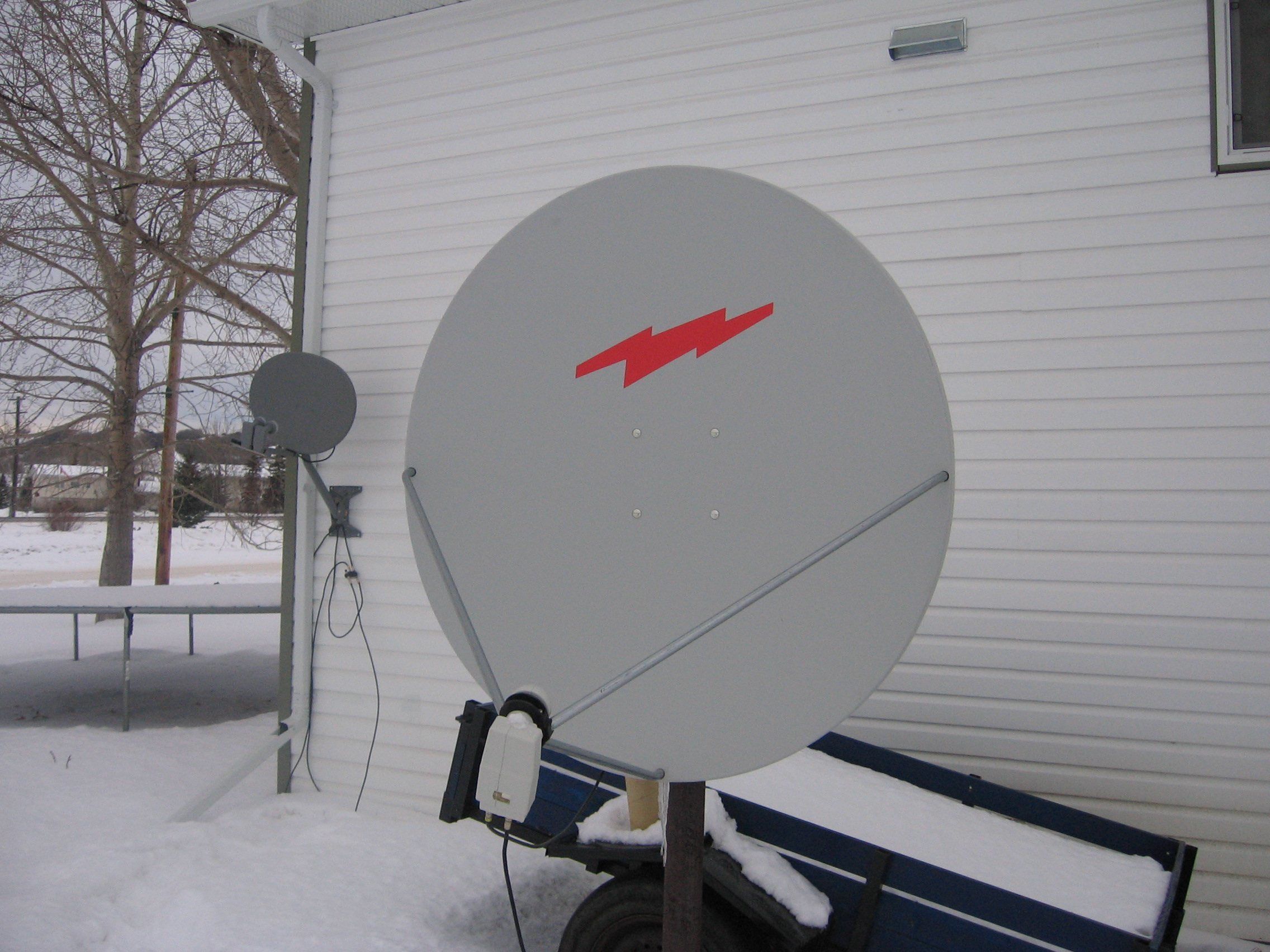

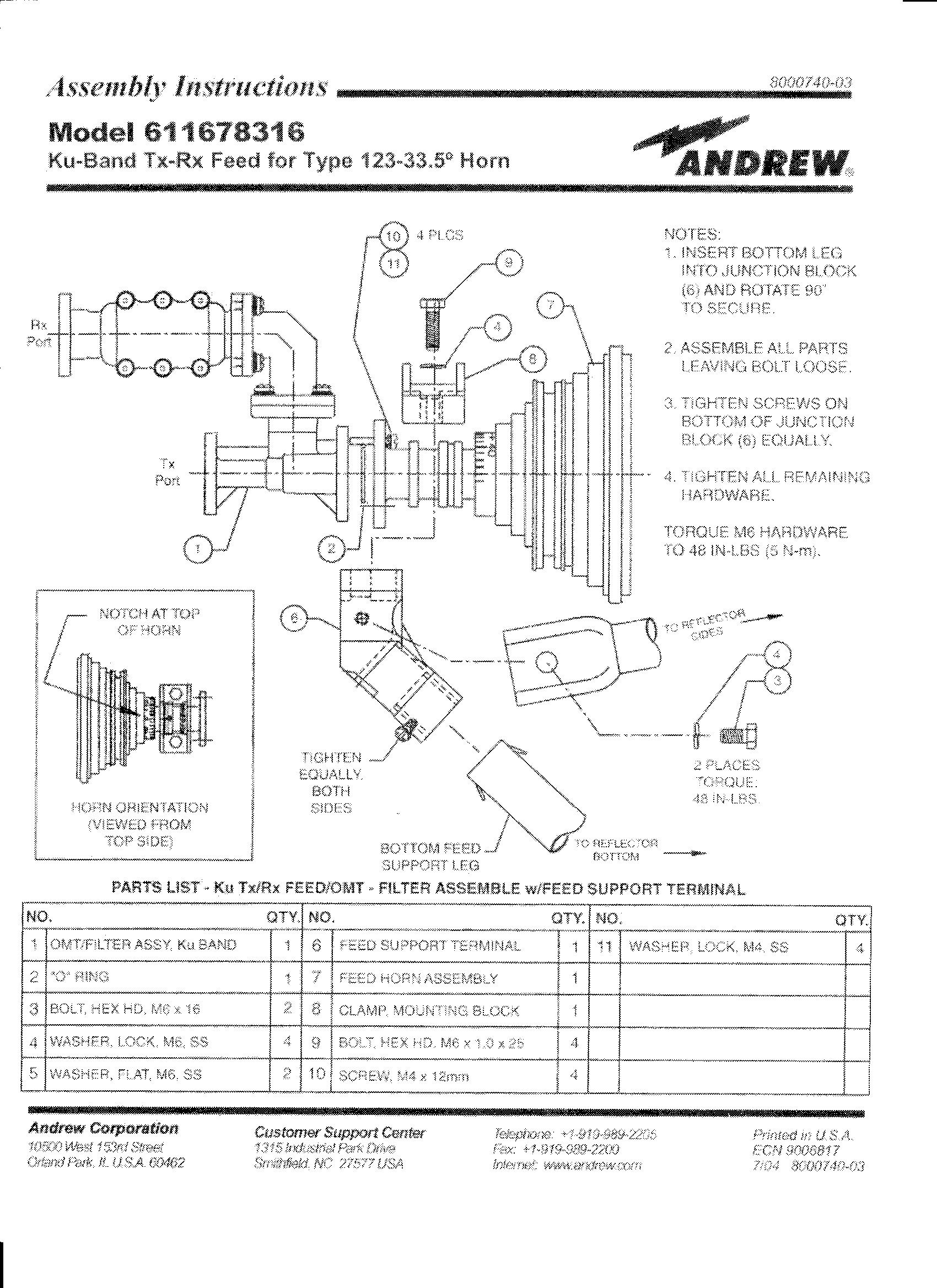

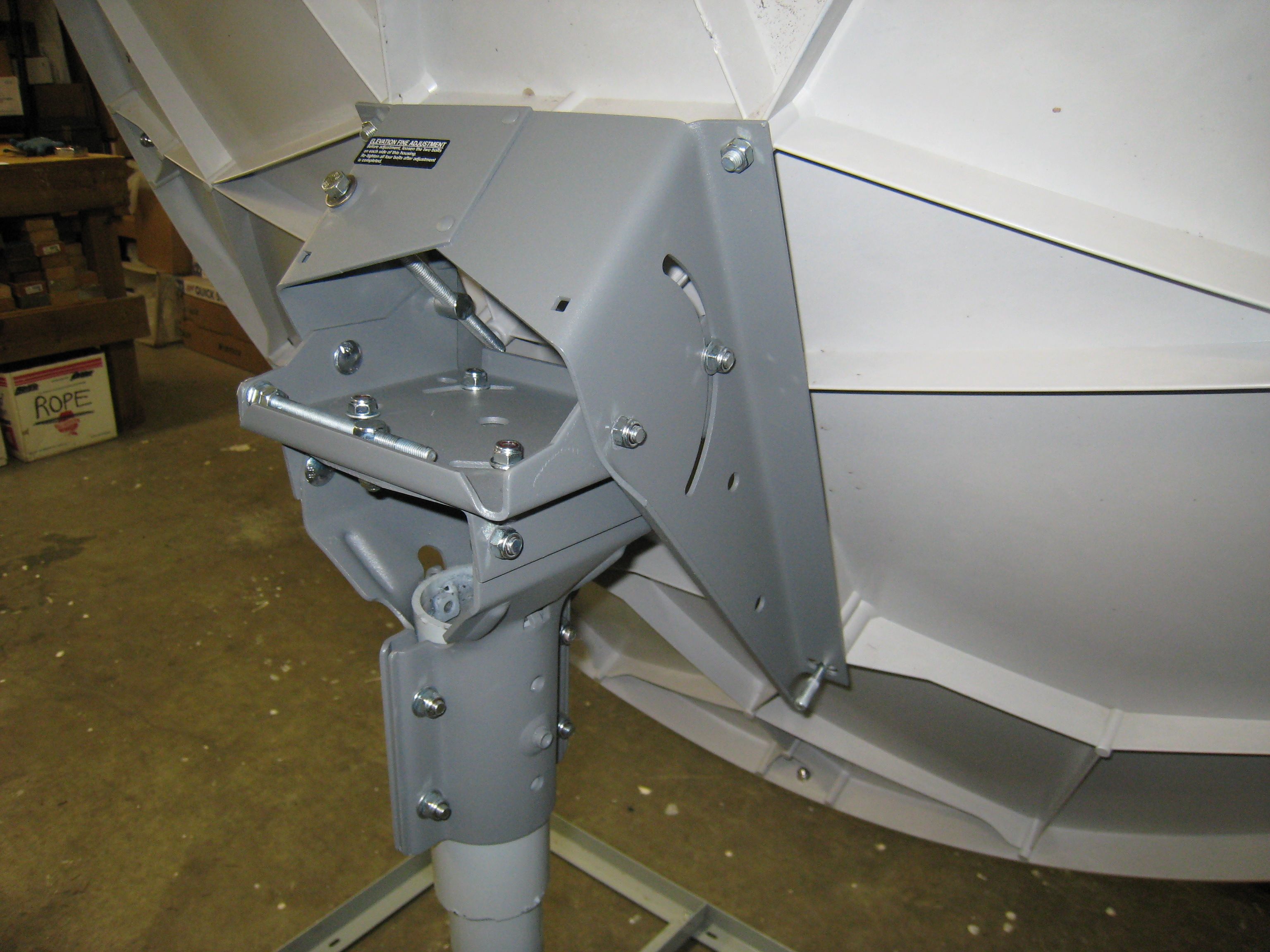

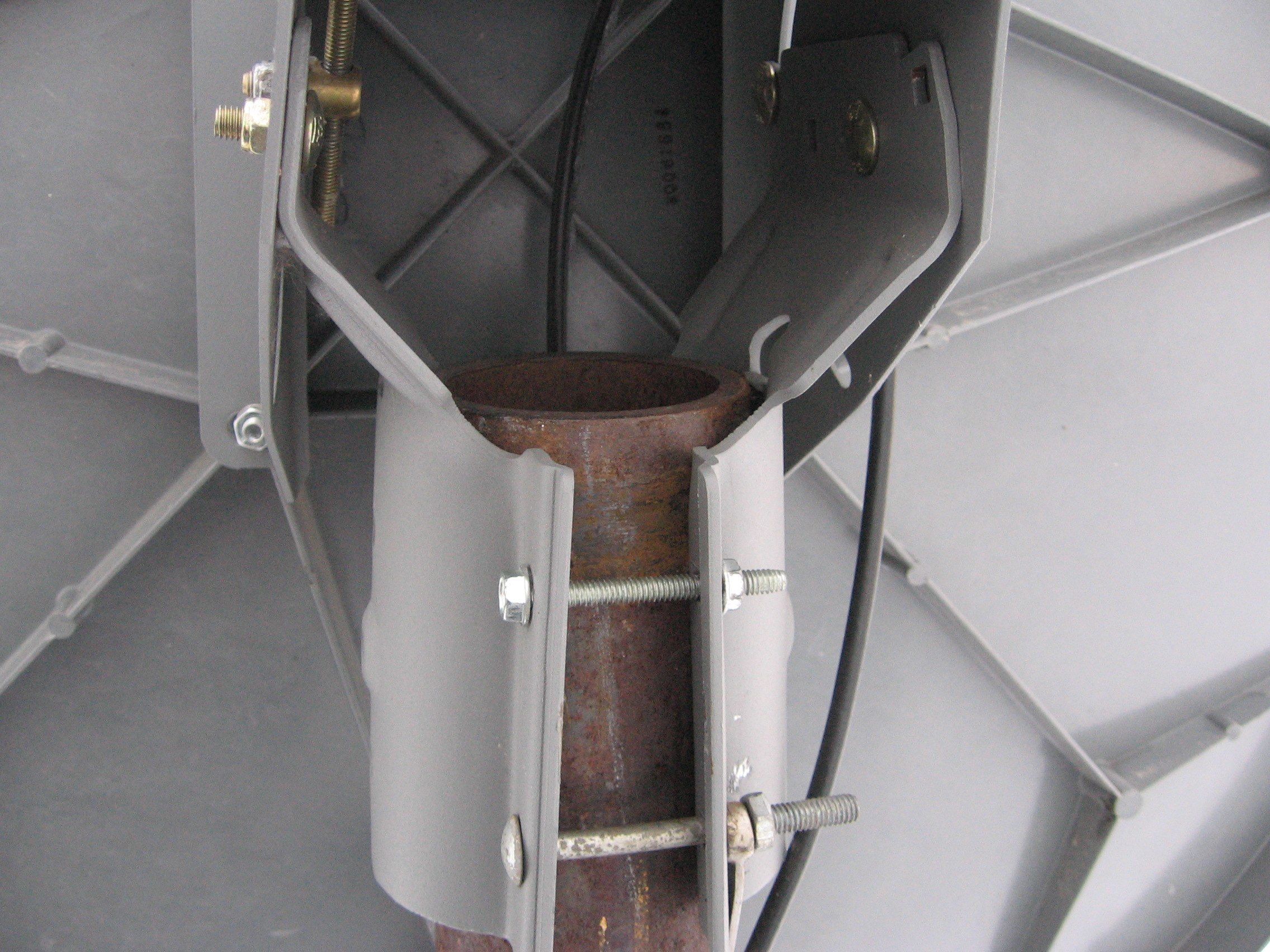

Here are some pictures of my dish.

Good looking dish, the lnbf-mount looks just like the old primestar 1m. I think you can get sev models of lnbfs to work in that, if the neck is too small to fit in the collar I just cut a piece of black plastic pipe, split it down one side, slip it over the lnbf and then clamp it down. Sorry i don't know what mm size that is called but that part is easy.
There's sev ways to do the motor, but most involve removing that mount from the back of dish, and replacing it, to lighten the load on the motor. I put a 1m dish like it on a polar mount for a c-band dish, and move it with a regular big=dish actuator so my riggings prob wouldn't help you. I wasn't worried about the weight that much with this big dish motor/pole.

Turbosat, thanks for the link, great motor mount info! My LNB clamp is 1" fully closed (think it is considered 30mm). I am thinking on getting the BSC621-2 c/Ku LNBF and rig up some way to mount it.

For the BSC621-2 LNBF, we have a holder that will work with it. It may need some tweaking to fit it on your dish.

I have an old primestar dish. I switched the mount up-side down and added a SG2100 (from Sadoun making sure I got the additional motor shaft size 2 1/8") to move it. I had to add about 12" of radiator hose over the motor shaft (yes I said radiator hose) to take up the gap and to allow for the the difference in 2 1/8" shaft on motor and 2 7/8" shaft housing on the dish.
I have pics posted here if you'd like to see them thenetbuilder.com: Free To Air Satellite
If you have any question let me know...I'd be glad to elaborate.
It fits perfectly...and it won't slip.
I'm really pleased with how it turned out...and it doesn't look too cheezy :)

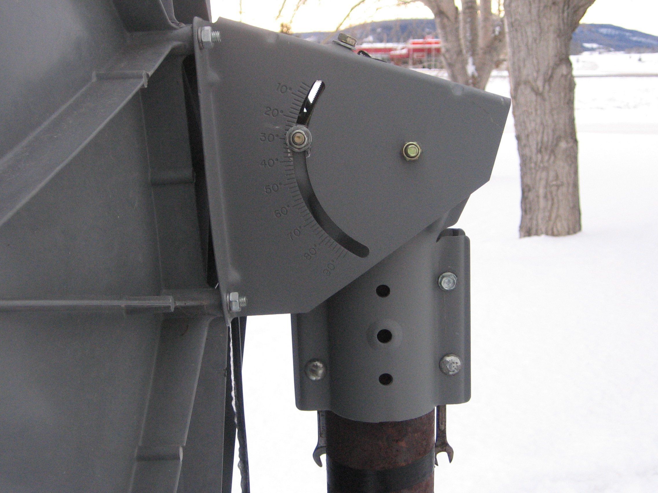

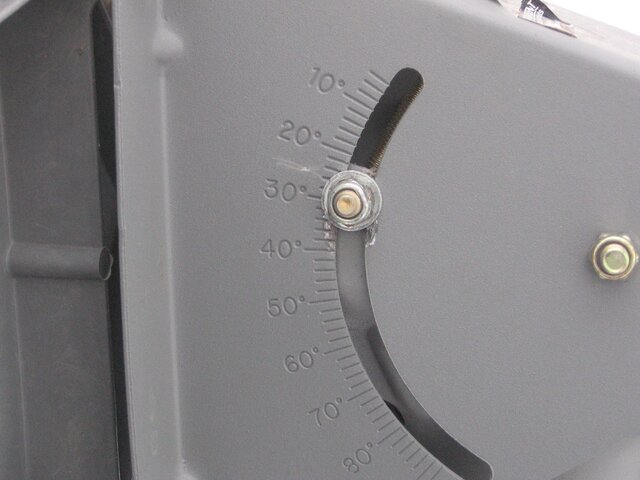

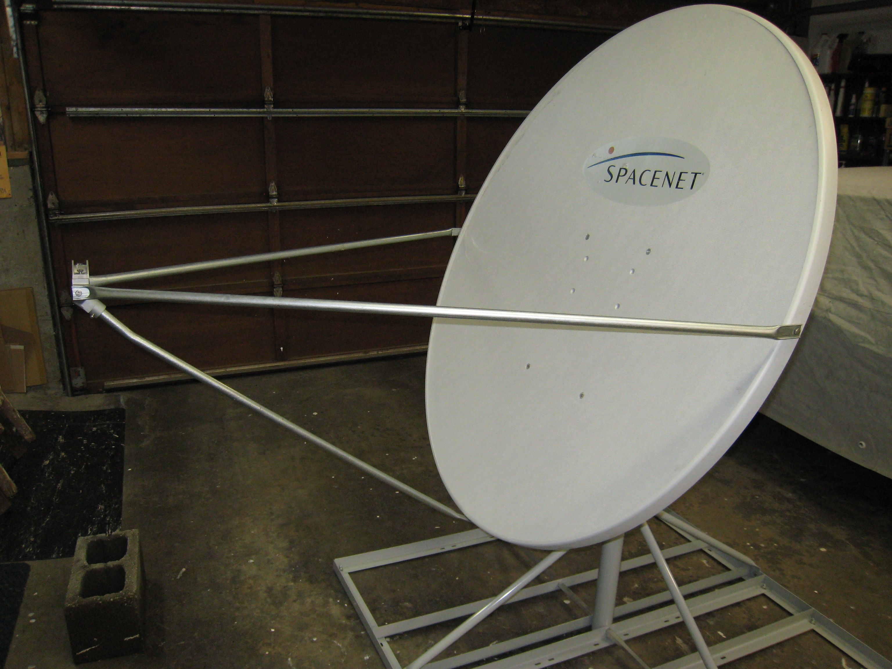

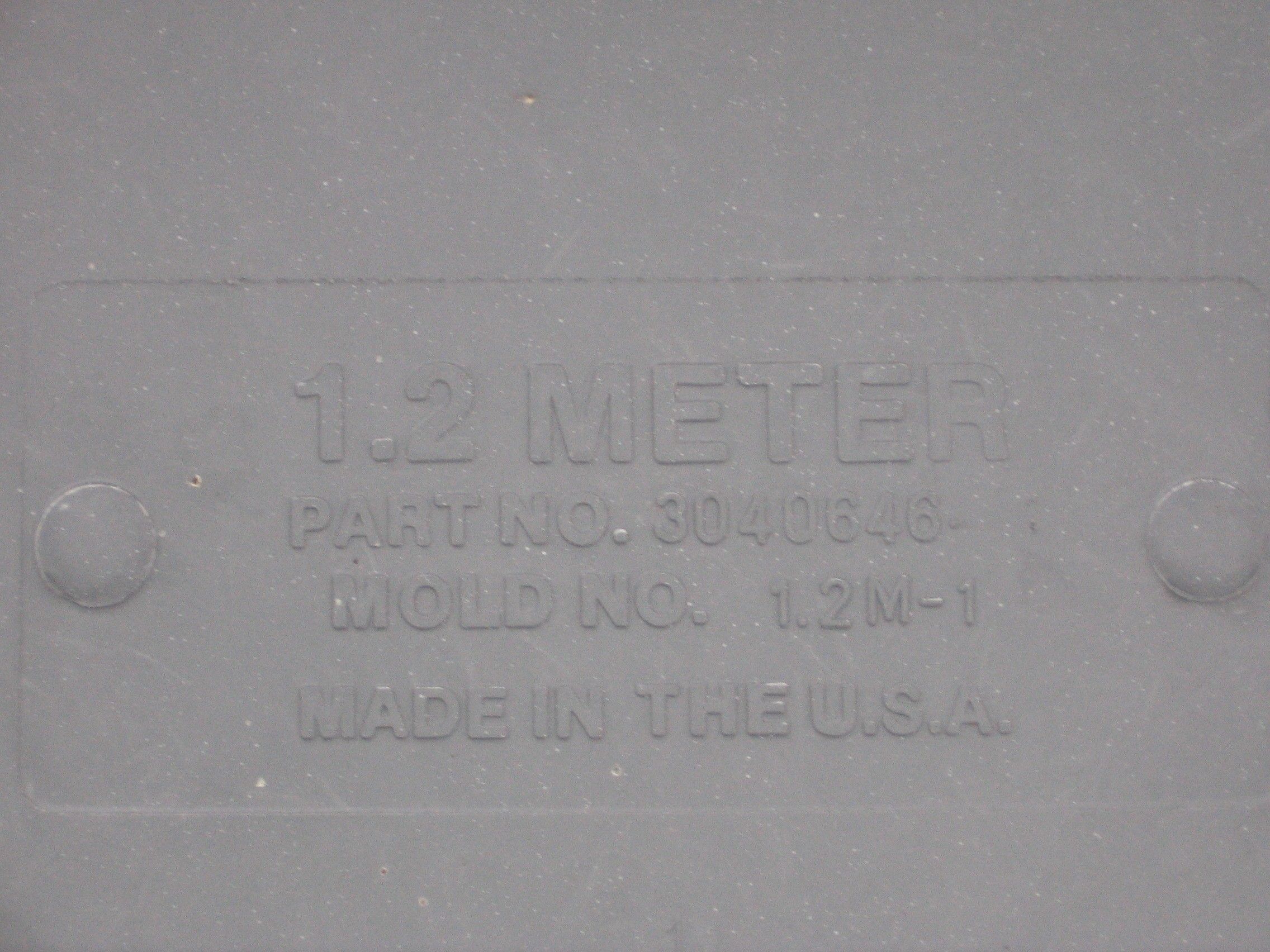

I am not sure if I can post in this thread but I have a similar situation.

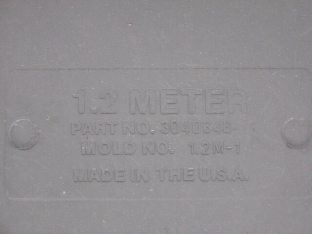

I have a 1.2 Andrew and a staab hh120 motor. The andrew dish is way to big to put on the HH120 without mods. Has anyone done this?
Here is some pics of how I have it set up right now. And the hardware that this dish comes with. The HH120 has a pole OD of 2".
I can also mount the dish on the original wall mounting hardware that it came with.

Ottobus - you really need to check out my setup, i'm sure it would work for you if you turn the mount up-side down on the dish and add the radiator hose to the 2 1/8" motor adapter which allows almost a 3" dish mount (depending on the thickness of the radiator hose).
Netbuilder, thanks for the radiator hose idea and pictures, very helpful!
