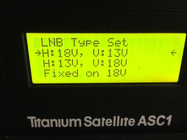

Example: The arrow on the right side of the LCD is pointing to H: 18v V:13v, indicating that the LNB voltage is the correct setting for powering a LNBF.

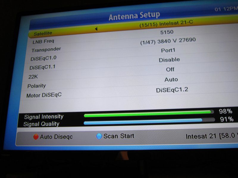

I have attached a picture of the settings I use for each
C band satellite.
Diseqc1.0 for C band is set to port 1.
Diseqc1.0 for KU is set to port 2.
Diseqc1.1 is always disabled.
This differs from your previous message and I don't know
if it is a typo or I am programming the settings incorrectly.
I will await your response before going further.

I see great Signal Level and Signal Quality on 58w. C-band on port one must be working fine. Does C-band work on other satellites? If you switch to KU and port 2 on 58w, do any of the KU transponders show Signal Quality? Sky Mexico is on the KU side and you should scan many active transponders with several FTA channels.
If the switch is DiSEqC 1.1 type, the switch type should be set to DiSEqC 1.1. If it is switch type 1.0, then set to 1.0. In the DiSEqC protocol, the switch types 1.0/1.1 should be interchangeable, but in reality, sometimes the DiSEqC switches are not.
The wiring for this diseqc switch was set when I bought the Titanium Asc1
and up to recently the settings I used seemed to be working fine. I have
not touched the wiring since then.
C-band has been working on many other sats from Intelsat21 to Galaxy23.
The Diseqc1.0 is set to port1/port2 and not 1.0/1.1????????
As you can see I am still confused.

It is like windows. You have XP/ vista or Win7 Diseqc switches are 1.0/1.1 or above? Ports don't matter as far as picking what switch you have. That has to be configured later. If your switch is diseqc 1.0 then you are fine and ports are configured properly
