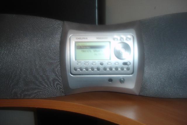

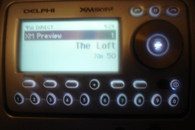

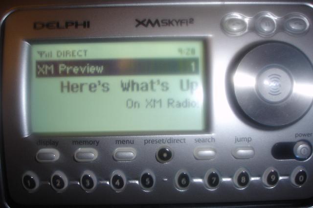

Hey guys, earlier tonight I went to Circuit City and was surprised to see that they had SkyFI 2 units in stock (they had about 7 of them) so I picked one up.
I just activated it about 10 minutes ago and havent had much time to play or listen to it.
I don't like the screen that much, lots of streaking is seen through the words and bars.
I will write up a better review when I have more time to play with it. But here are some photos of the unit. :)

The Display on the unit is terrible, while the pictures don't show it the images on the display is a bunch of smears. Very poor contrast and even when you adjust the contrast via the settings menu it is still bad.

What is the major issue with the display? Does it somehow differ from the Roady displays in some big way? That's disappointing that they went from a display that washed in the sun to a display that's bad all the time.
Its hard to discribe the screen on the SkyFI 2, its washed out in places, and dark in other places. Little black lines going through it, the blacks have a lot of white in them, etc.
As I said its hard taking a picture of the problem, you really have to see it in person to understand it.

From what you're describing it sounds like what happens when torque is placed on an LCD display as if there's a slight twist in their mount or pressure is uneven on the corner mounting screws. You can get the same effect but slightly pushing or pulling on a corner of a laptop LCD panel. It sounds like Delphi has some quality control issues on the manufacturing but that's not a surprise. It wouldn't be the first time they've released an XM product with problems.

I had read several posts about the streaking on the display and mine
has always been fine, it is a bland lifeless display, but no streaks or
anything perfectly clear
I had to go read the post http://www.xm411.com/phpbb/viewtopic.php?t=7697
and it is obvious at a glance he has the brightness turned up too high,
out of curiosity I turned the brightness and contrast up all the way
and sure enough it looked just like the picture
now the point of the story, when I set the brightness/contrast back to where
they were supposed to be .. I still have a little streaking in the black bar :(
I kept adjusting and reduced it somewhat but there is still some streaking

My brightness and contrast are set low and am still having streaking problems, and when I have the stock ticker going the streaking actually moves across the screen with the stock ticker.

Just wanted to chime in here. I just picked up one at CC ($99 still) today, and while I see the streaking problem, as long as the contrast is dialed down to 2 bars it's not that bad.
It is definately a flawed LCD design, with the vertical signal bleeding through even on rows where the horizontal line isn't energized. But all in all, I think it's a flaw that I can live with. The screen clarity seems just fine with the contrast set low.
