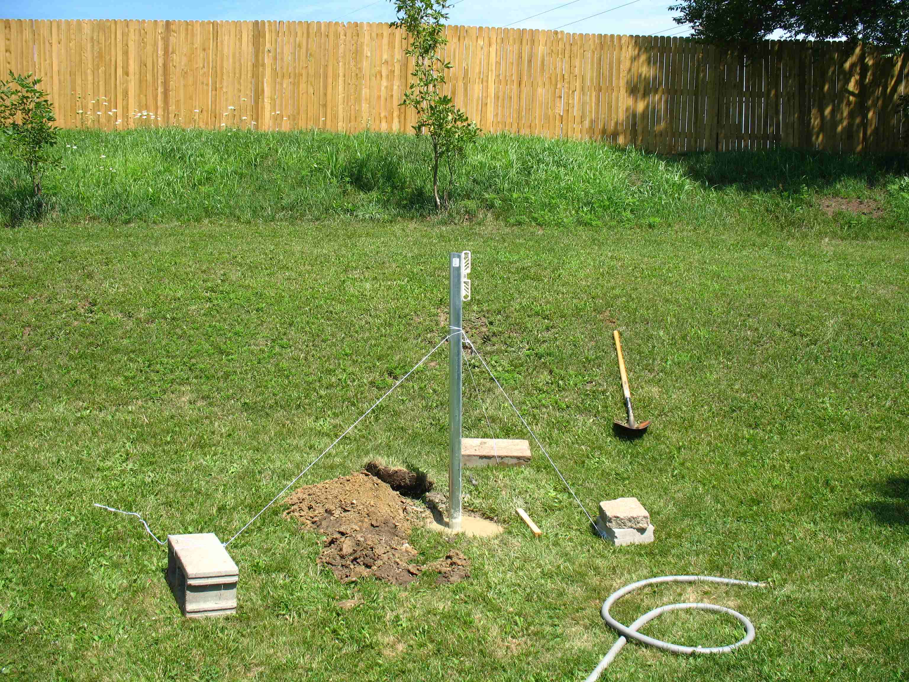

I picked up a 2 3/8" 6' pole at Home Depot, along with 2 bags of quick set post cement for around $20. Nice strong support for the Primestar. You will like the elevation adjustment :)

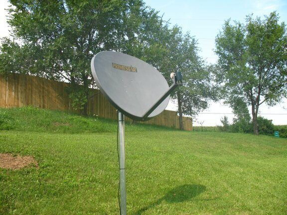

In case you didn't see my other post, here is a pic of my Primestar install - aimed at IA5. I have the Fortec Universal LNBF on it.
Nice set up there iafirebuff!!! :up Did you find the two new christian channels on IA 5?

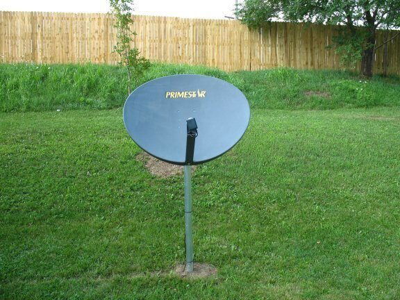

At our Home Depot a 50 lb bag of quick set for post is $5ish. It took 2 bags for the 6' post. Here are a few more pics.
