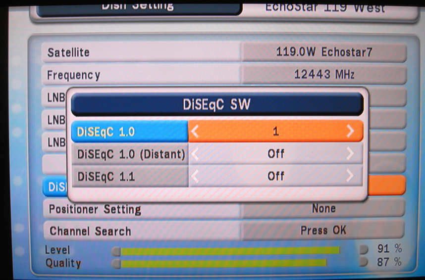

I have tried to set diseqc 1.0 to 1. Please see my menu settings attached. I have these choices and I can set numbers for each of diseqc from 1 to 4. And for 1.1 I can set it up to 8.
With diseqc 1.0 set to 1 I can still get lots of scrambled channels (53 TV channels, the same as before) but no FTA.
I have 2 choices for LNB type - single and universal.
Universal (default) has 2 choices 9750/10600 and 9750/10750
Single gives default choice 1060 and an option for 22 KHz on/off
All LNB frequencies I can alter manually except 22 KHz fixed on/off option.
And I tried 1.0 distant too, set it to 1. And it goes through all frequencies, from lowest (122xx something, below NASA channel) up to 12516, all polarities. Blind scan or auto scan - it's the same. Finds scrambled channels, no FTA.
lnbf type single
Change 1060 to 1125
DISEqC to port 1.

lnbf type single
Change 10600 to 11250
DISEqC to port 1.
These settings worked. I got NASA, Ion and Angel.
