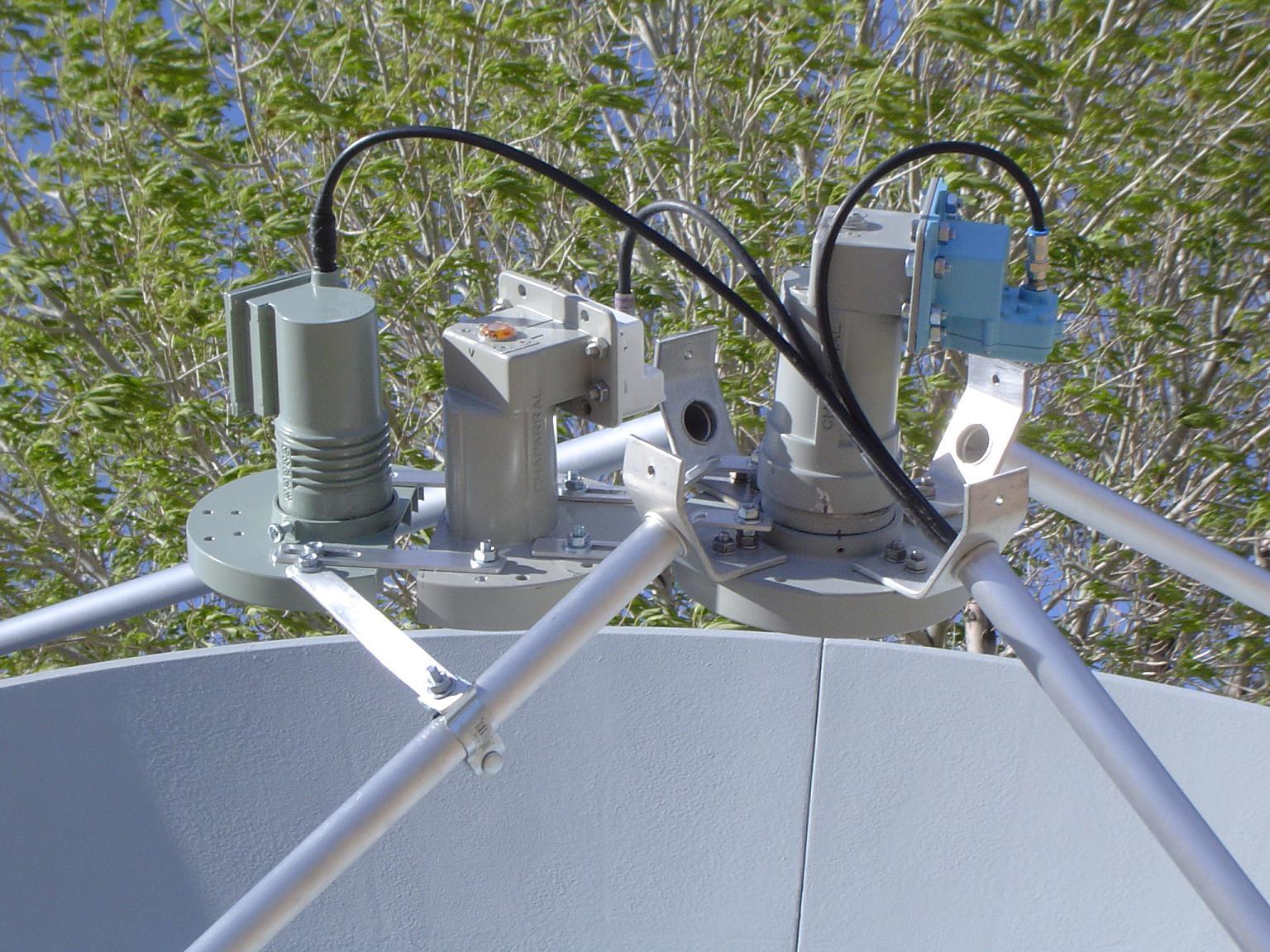

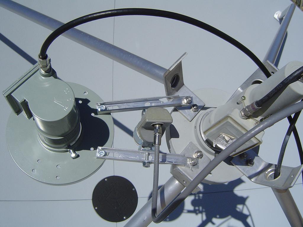

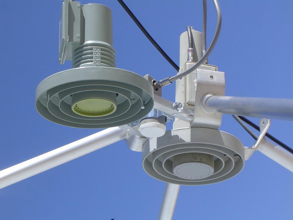

Not exactly a kit, but some pretty neat mounts fabricated for multi-LNB and LNBFs in Post # 269, found here:
http://www.satelliteguys.us/xen/threads/pics-of-the-dish-farm-post-yours-too.131140/page-11
I assume you are talking about these:
005-jpg.50096
006-jpg.50097
At least they have the right idea of using plenty of supports:
008-jpg.50099
Words fail me on this one :eeek:
011-jpg.50102
These pics (well, at least the top three, and especially that third one) are definitely more along the line of what I was thinking of, it's too bad there isn't a pre-made commercial solution like that!

Those are the photos. To me, McGuyver's multi-LNB setups in the photos appear to be well thought out, neat and simple yet sturdy using inexpensive parts (flat aluminum stock, aluminum channel, electrical conduit clamps and a few nuts and bolts).
If you don't find a ready made multi-LNB(F) holder, at least there are workable alternatives.

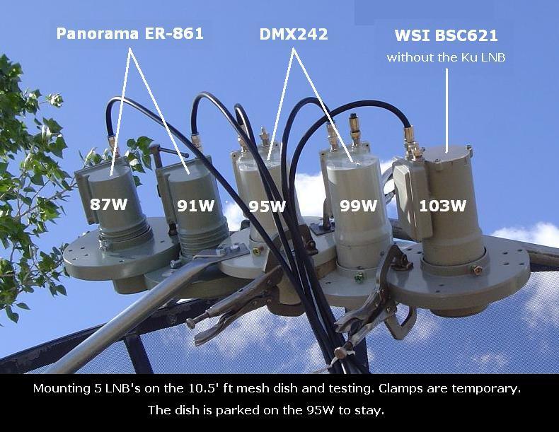

ok i'm no expert at it but did get the chance to play with multi lnb's on one dish for a few hours last year . I don't get a lot of time to play with my dishes since i work out of state. this link shows several lnb's in a temp setup using conduit hangers.
although they are flimsy and shouldn't be used for anything more than playing / testing (for length of something more sturdy) mine only got 91,99,105 in testing so your mileage may vary :) its a project i hope i get more time this year to play with some more :)

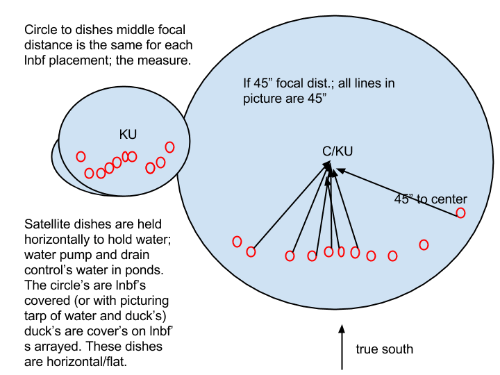

Here is the directions for multi-c band. They did not write directions for using a satellite dish without shadows after the cable companies put fences up to hide their dishes. Here is a picture of the design I have used which is offset for elevation accrued using the middle of a c band sized dish; for c or ku band sized dishes used my hands on the lnbf; from behind the dish to southern exposure; holding the skew and the stable aimed point using a bracket is easier. The problem is if the assembly moves a 1/4 inch; it stops working; so static bracing is required; and very good switch; and all lnbf's must be isolated from the mirror (satellite dish and associated ground; diseq sw is half of the assembly. Plastic or glass are the only materials for the isolation factor removes the dish from "electrically being ground as it is actually id's making an amount of electricity the lnb". The switch used only powers dc one lnbf at a time.
http://richtv.net/picsir.png
How it is done today using a ku dish is the AZ/EL mount that uses its "offset" design to give you one satellite at offset using the middle of the dish; and the marked elevation for when the pipe is a vertical. DBS dishes do the middle of the dish iused for one satellite the middle lnbf receives and skews to the 4 satellites it receives. The other satellites are aimed at using the assembly (dish toroidial feature built-into the dish; accruing aim of each. The picture from my link is when a dish plate is horizontal; the offset is the lnbf aimed to the middle of the dish from each offset; using offset as both AZ and EL from the true mirror and amplification a satellite dish has available to it (both angles) from the center of the dish. Motorized dishes were designed to move to all that is offset today; they only needed one lnb (then $1000) and the shadow was small because of only one lnb. Offset dishes upsidedown and backwards have no shadows to ANY OTHER SATELLITE FROM THE PLACED LNBf's onto the assembly. This is the same as taking a glorystar dish and using it upside down (; from where i live the lnbf is almost vertical because of itheir offset design (; with a re-movable offset their brackets..+24 lnbf's and is about $240+12 brackets for the ku band only assembly. They just do not write their instruction book for its use. Many parts on the dish; like the lnbf bracing are shadows to many lnbfs. The shadow is minor with only 1 lnbf. Keeping the assembly from shadowing each other is why it has to be offset; and if you look at directv's lnbf why 2 degree spacing is really hard to accrue. The lnbf's today are not designed for 2 degree spacing as the "bump into each other" unless they are cut and isolated from each other like directv's ku band lnbf as an assembly; or for FTA uses.

offsetting LNBf's from a center focus designed for one lnbf shadow only; means that the more lnbf's you mount, the more each cause shadow to each others direction it receives from. The DBS type is around 8 degree's also because of the shadows at aim for their spacing of the satellites; and ku band is small area of shadowing (nlockage of signals). Just like a c band dish needs the entire dish to reflect an entire satellite; always the middle of the dish is aimed at. Notice DBS dishes do not aim every lnbf/eye/cavity at the middle of the dish (C Band LNBf's must aim at the middle to achieve optimum signal gathering of the energy reflected; SO EVERY LNBf must achieve its "aim" using the middle of the dish. The offset for elevation sets the elevation of the lnbf aimed; the az is set with the middle of the dish at the same time for full satellite signals without any shadow/blockages by the other lnbf's mounted next to it. Then the entire dish can actually receive every satellite the plate can be aimed at; using offset for elevation AND AZ! The assembly looks like this picture
now look inside dtv's 3 satellite offset @ 2 degree's and that really is one feed; 3 satellites; ku band satellites circ. polarity; no shadows; 3 gig = 1000+ channels stacked and right on down the cable to their receiver; prefectivly. In Alaska; a satellite dish almost has to ne mounted upside down and sideways.
In the old days, while the concrete hardens; pipe/post/pole for polar mounting; I would take the assembled c band dish W/O mount; and point the dish straight up; then using my hands holding the feedhorn; i would plug a hdtv in next to the dish; and watch channels by aiming the lnbf at offset and AZ; across the middle of the dish
AND WATCH TV; you can too; to get every satellite at 4 degree's the scalars need to be cut physically to fit; and the dish must be mounted po nting straight up; and to get both c and ku the ku or whatever collector you mount must all aim at the middle of the dish; and curve; or follow the arc of and skew if any; of and with every lnbf; without shadowing each other the Design is already a fact!!
