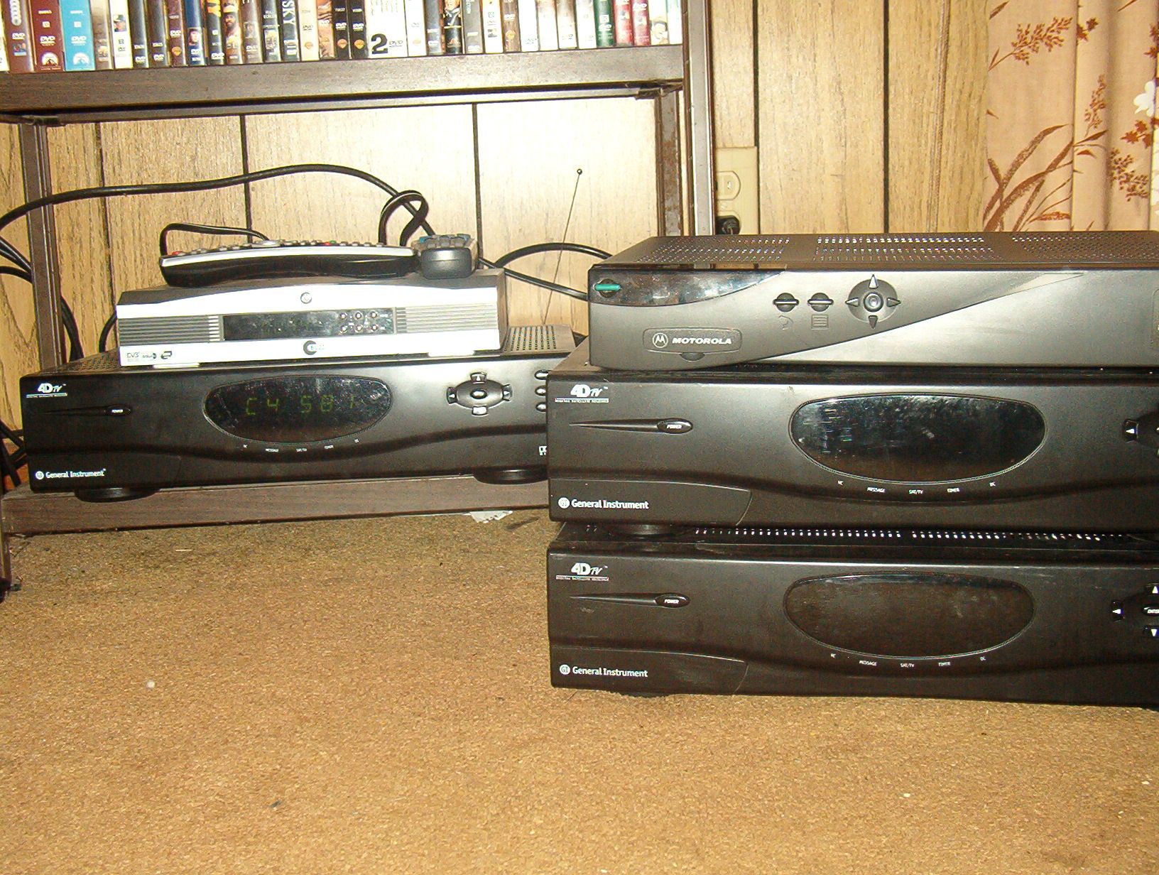

Hermitman no the recevier did not have G1 in Program Satellites menu at all. That does not matter now because the recevier downloaded the channel maps on C3 in about 30 minutes kind of slow compared to G1 which took about 5 minutes.I am a very happy camper as I now have 4 working 4DTV receviers.
