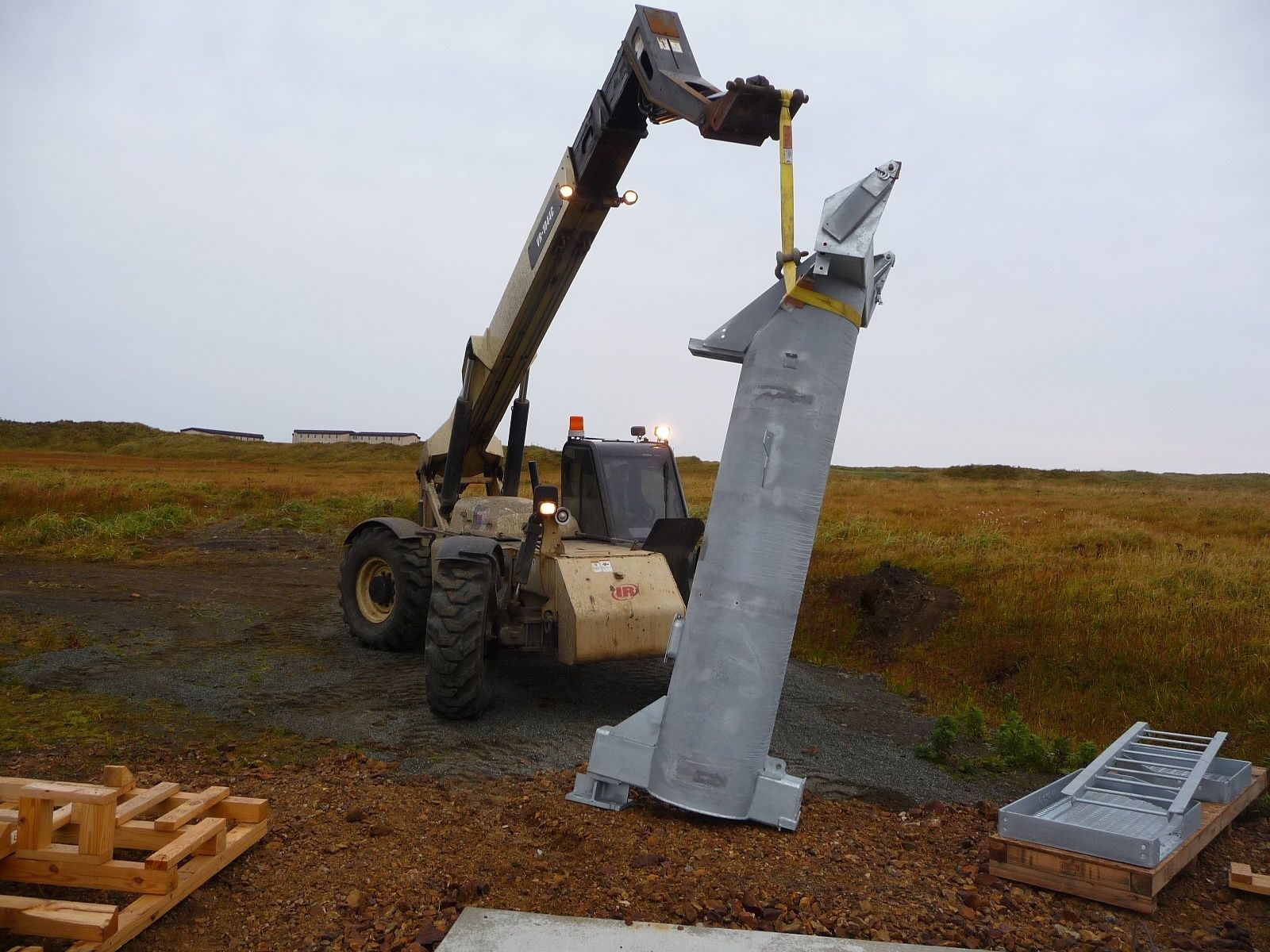

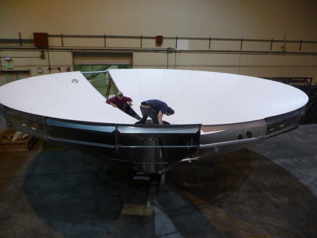

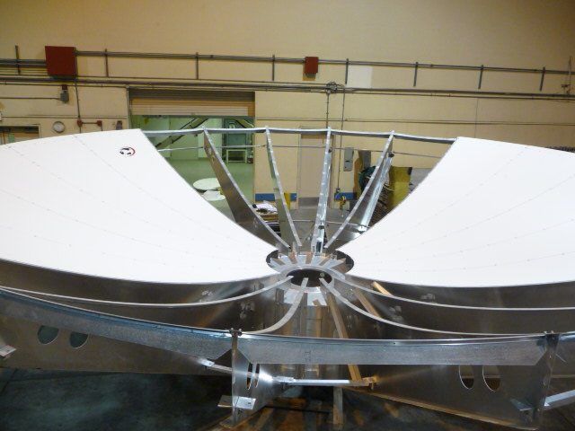

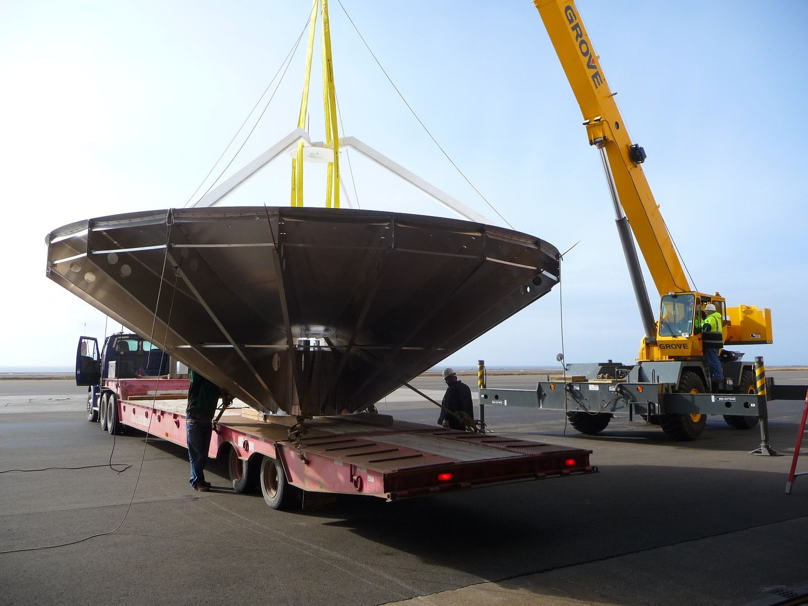

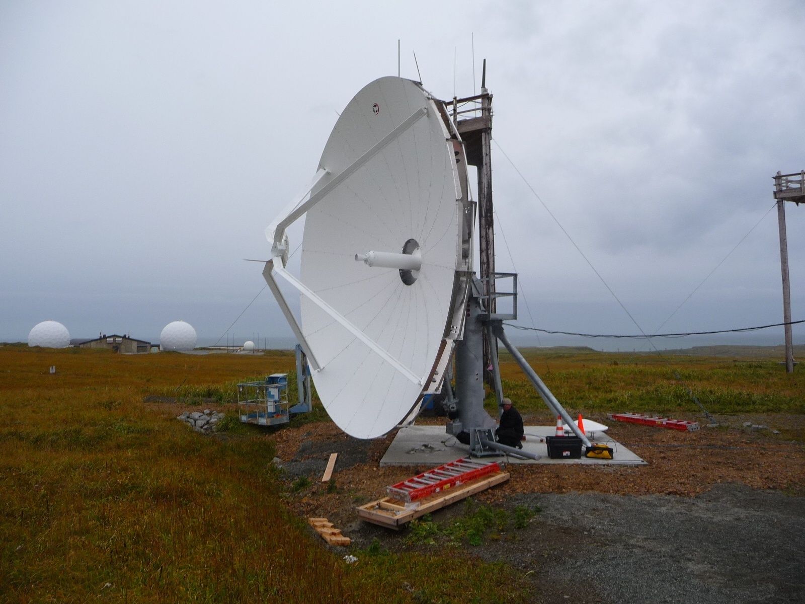

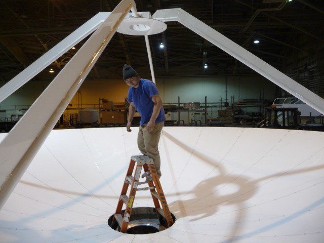

Thanks for the reply's! When we installed the 7.3 meter last year and when I was peaking it in could only get a decent signal on the 129, when I swung it over for 119 I could see a small bump on the Spec Anz but the recievers would not lock up, There are some old water tanks in the distance around 4 degreess which I suspect is the reason and since the dish is a prime focus feed we had to go with the 129 bird which has about 40 dishnetwork channels (mostly all HD). We are getting a 57 in signal quality from the DN install screen. Not much rain fade at all, but when the thick fog mixes with rain it happens but not as much as the snow, we could'nt afford the extra 20 G's for a heater so we have to scrape it off the face because it sticks so much to it. Your right about the 110 being below the horizon...I guess we are lucky to get what we have!
I'll try to atach some photos.....
Here are some Pics on the Install of our 7.3M it came together pretty good with the help of Satellite Alaska out of Anchorage.

Wow. Some people are really serious about their TV.
And I'm not going to a$k. The answer might hurt me, just to hear.
Maybe you could run a spare coax to those white balls in the background and ....
