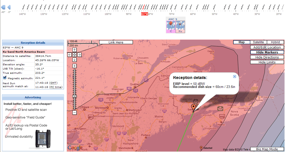

Ctktcmt,
I cannot say how much reality there is to this, but from the footprint map available on Satbeams site, it shows that you have the identical power level in St. Johns as I have here in Omaha, NE USA. This is 50 dBw and they are recommending a 60 cm or 24" dish antenna at minimum. Here near Omaha, I get it fairly well with a 75 cm dish and even better with a 1.2 M dish.
From the same source, SatBeams, they are showing 46 dBw for CornerBrook where AMC1 may reside and recommending an 80 cm or 32" dish antenna.
Well, like I mentioned, I cannot vouch for the accuracy of this or the "real world" application scenario. But, it should give you a clue to at least assist.
RADAR
Attached is the EIRP map from SatBeams for 83°W for your area, St. Johns.
RADAR

Acwx... I believe you are thinking of St. John Nb not St. John's NL as Newfoundland is only partially shown on your map and the st.john's area is not even shown.

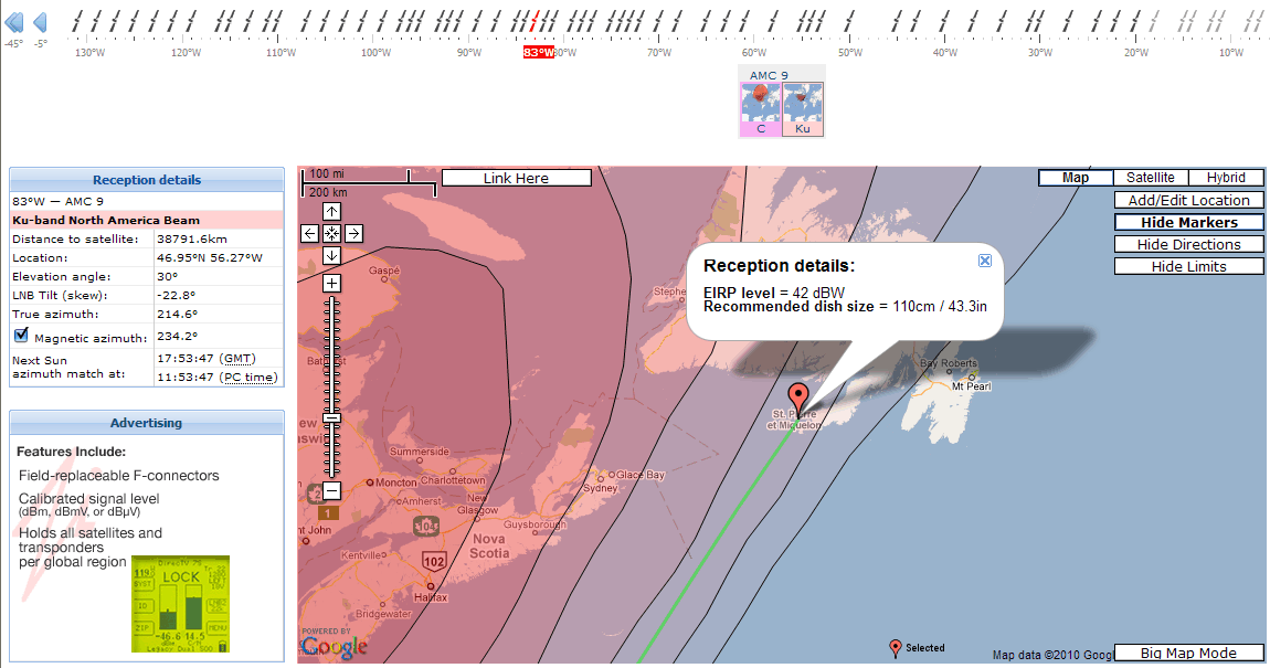

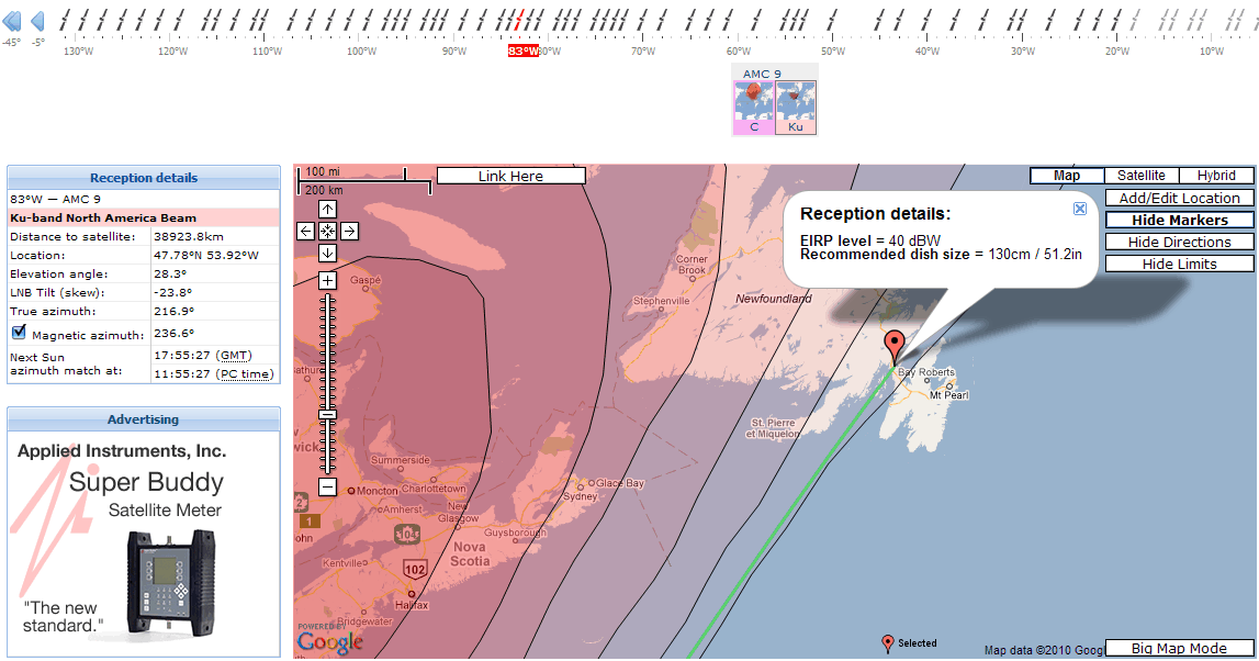

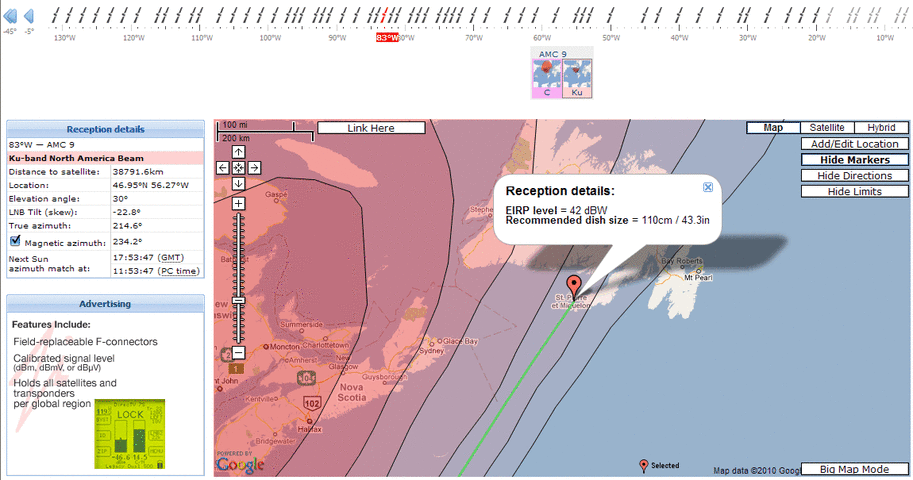

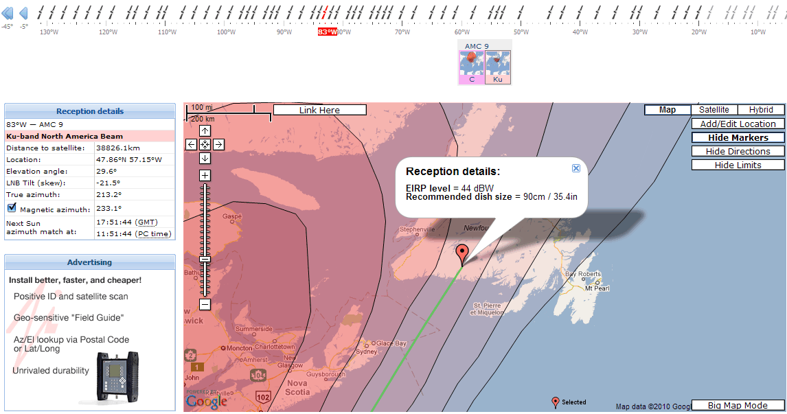

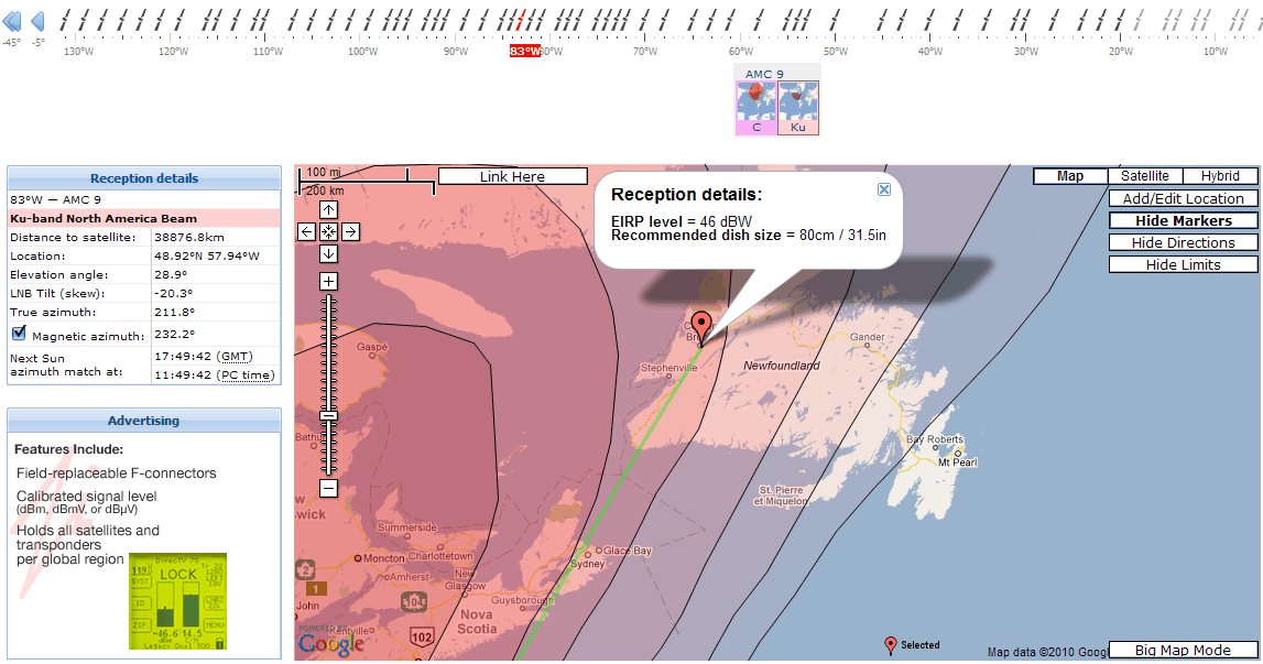

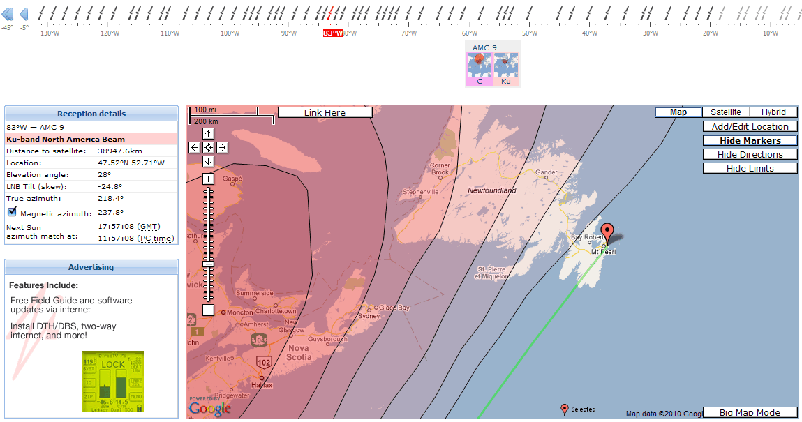

Ctktcmt,
You're right, I saw the city names of Saint John's and Cornerbrook and just got confused of where I should have been looking. Saint John's, NF doesn't display on the map from SatBeams, but I located it on Google Earth.
Satbeams does not have any EIRP data for your location at all. Personally, I would have to say that you woud be out of luck for 83°W Ku.
The signal drops off fast as you go east. Attached are the EIRP maps of 83°W for the proper areas starting from Cornerbrook going east.

For anyone else who's NFLD-challenged, and was just reading along like I...
St John's is just north and a little east of Mt Pearl.
So, AcWx's last map shows the bad news.
If ya can't get 83°, maybe give a try for some other satellites.
But best wishes on your quest. - :up

Actually, Mount Pearl is literally surrounded by St. John's. My wife, like most of those in Mount Pearl believe in this weird conspiracy that St. John's didn't want Mt. Pearl to get any bigger so they annexed everything around it. They have done this because St. John's knows that Mt. Pearl is better so to keep them from being/getting better they had to keep them from growing.
So my wife claims, anyway.
She also says that's why Google Maps shows Mt. Pearl, and not St. John's, at that zoom level, even though St. John's is the capitol.
And you can't tell anybody from Mount Pearl different either.

I notice the satbeam map footprints shows fairly good coverage on the c-band for this area , but as mentioned shows a cut off for this area on the ku. .. so i guess the c-band is the only hope perhaps...
