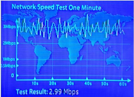

I don't have the buffering problem and I've had the IPTV service since its beginning. Please don't blame Sky Angel or Neulion for a problem that isn't theirs. What is your STB speed test results?

Can you attach a photo of your STB speed test on this site?

Have you been able to view my digital photo attachment from yesterday evening? Click on the thumbnail to view a larger image. I would like to view the results from other forum members. Maybe Neulion needs to add additional servers and more locations?

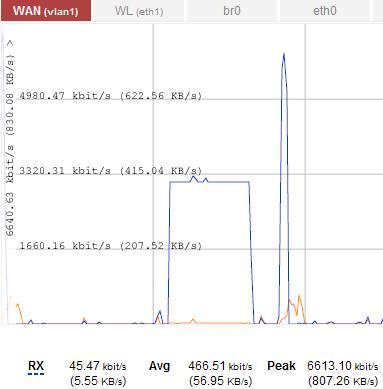

The below image is from the bandwidth monitor in my router. The first blue hump is the one minute long speed test initiated from the SA box. The second shorter spike is from the Dallas Speedtest.net server (since my SA box is using a Dallas server) initiated from a computer.
You can see that my internet connection bandwidth is much greater than the maximum that SA uses and the amount used in the SA speed test is much higher than what a streamed SA IPTV channel requires.
My SA box speed test looks very similar to the way yours looks but I don't have a digital camera handy. Test Results 2.99 Mbps
