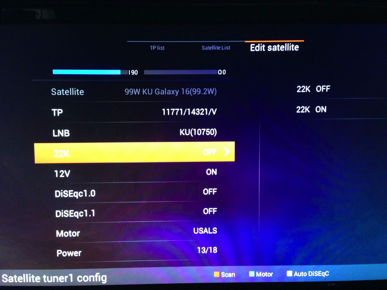

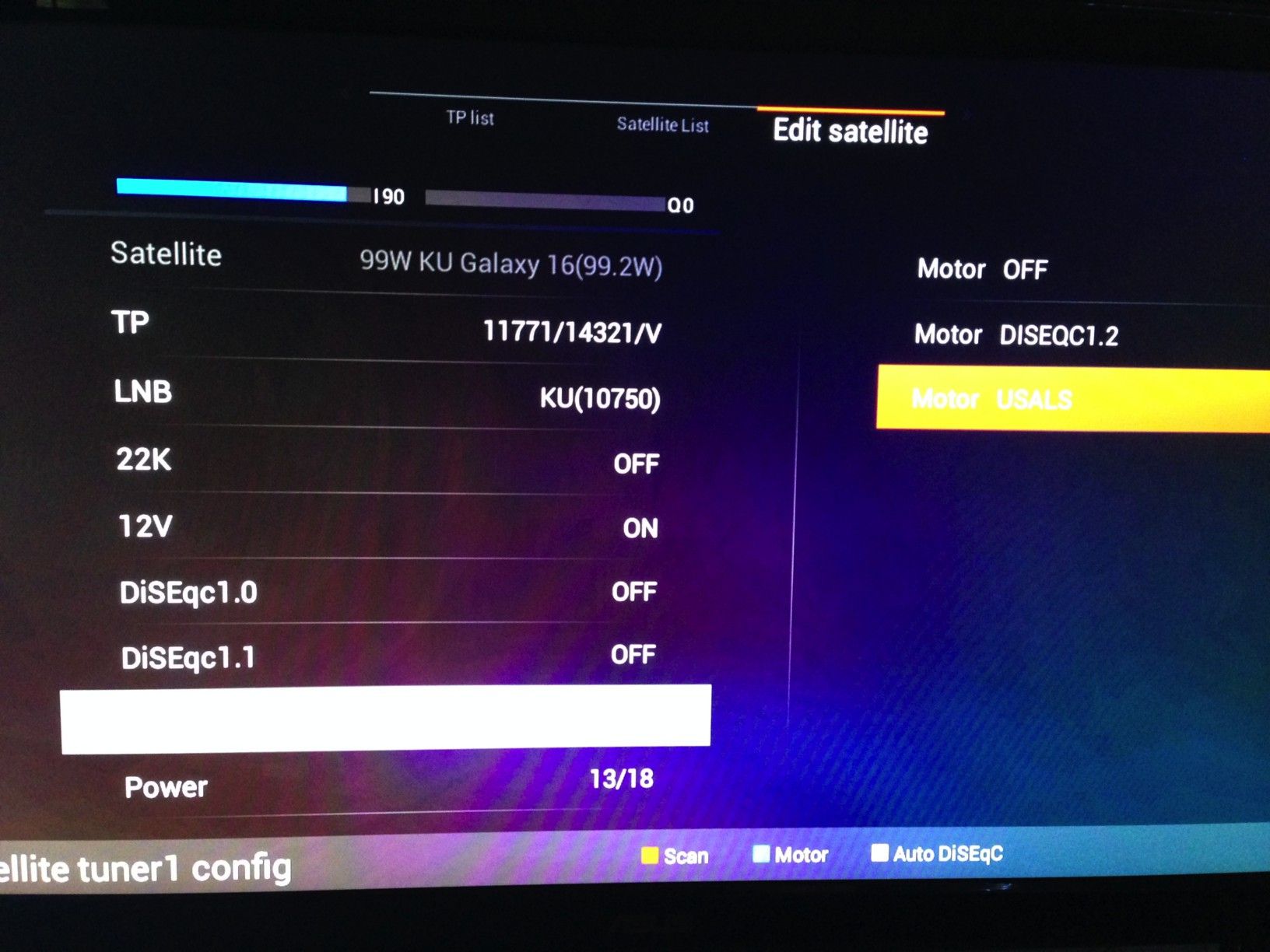

Another thing I've found that is rather annoying is that when I try to select things in the configuration screen, I highlight them then press OK and it blinks and returns me back one level but does not actually change the setting. Sometimes I have to try and retry 10-12 times before it will actually change the thing I'm trying to change, such as 22khz on or off, motor type, etc..
I could be wrong looking at your screencaps Dee_Ann but looks like it is in the follow through and commitment.
Let me try and duplicate your screens...
Your first picture shows this on 99W C-band.
What that shows is absolutely nothing other than the current set-state.
If I arrow over then select 22K ON like in the below screen then press OK key on the remote, it changes 22k from "off" to "on".
(Arrowing over one line then selecting ON)
(22k on left now says ON)
Even since the first factory production sample software this has always worked. I've tested extensively with Amiko Universal PLL set to 10600/22k "on" so I know for a fact it works. Never had to tell the A3 more than once to do it.

Joe, in a little bit I'll set up my big camera and record a proper video where I can demonstrate what is happening. I was just being lazy and taking iPhone photos.
When I do arrow over to the right side where I can change the state between off or on, highlight one of the options then press OK, the screen behaves as if it recognizes my pressing the button but it does not change the state over on the left side. It very often takes me many repeated attempts before the state actually changes.
