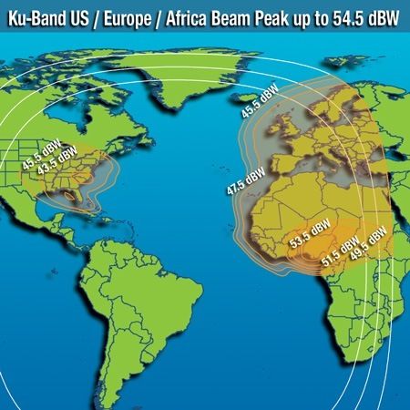

I am using a 76 cm dish with motor and the Openbox S10. I can't find a map that shows the American footprint of this satellite. Does anyone know what my signal is supposed to be in dBW?

Lyngsat maps didn't have a coverage map for this satellite, and I was curious what the signal was. This seems to be the cutoff point for my 76 cm dish. The picture on that channel is pixelated, and barely comes in. I'm sure a 90 cm dish would help to get it reliably, but I don't really care to watch anything on that. I was just wondering what the cutoff signal was for my dish.
Lyngsat maps didn't have a coverage map for this satellite....
This is the coverage map for Intelsat 14 at 45W.

It's not the signal on the receiver... If you look at that coverage footprint map a few posts before this, you'll notice that the signal is shown as better away from the North American epicenter, and that can't be right. The edge of the footprint cannot possibly have a better signal. Look at the map.

Andrew and everyone,
There may be problems recently with footprint maps accurately displaying the EIRP values due to something google maps has done.
Read this from Satbeams:
News - Website
Wednesday, 09 November 2011 09:18
Dear all,
Many of you have reported that there is an issue with incorrect EIRP reported on the map. The issue is caused by the limitation of 125 dots per polygon that was introduced in Google Maps API V2 without any advanced notice. As a result all the most precious maps are reporting wrong values despite the fact that all the data is correct in our Database.
To eliminate this issue we need to urgently upgrade the footprints page to the latest Google maps API. As we need to port a lot of functionality, it will probably take some time until the issue is completely resolved.
We will keep on posting the updates on the issue.
Thank you very much for your understanding and passion!
This might affect any EIRP map that utilizes Google Maps, but I don't think that it should affect the map that was posted earlier (I don't think that is a Google Map item). I see the error in that map (the EIRP level is higher going outward from the concentrated area of the beam). You are right Andrew, that has to be a mistake.
