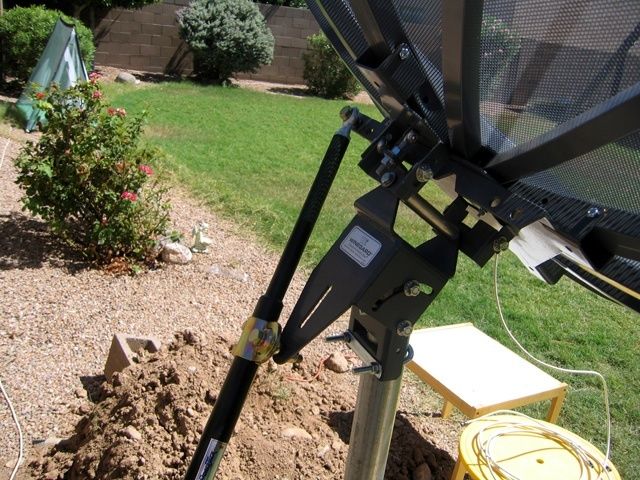

An 80lb bag of concrete mix only does about .6 cubic feet (according to an online concrete calculator). To get one cubic yard of concrete, it would require 45 bags. Figure 4 foot deep, 1-2ft wide at bottom, and 3-4ft wide at the top, and you're at a cubic yard pretty quickly.
I believe my pole for my 10ft dish is sunk a little over 4 feet, but less than a foot diameter at the bottom, and maybe 3 feet around at the top. I have no idea how much concrete is actually on that pole, but I wouldn't be suprised at it being a cubic yard. Of course, I've also put a 7.5 foot mesh dish on a wooden fence post with no concrete (just tamped down dirt), and it worked (for analog c-band) for the year or so that I used it there.

i know there is a lot of talk here about installs and i'm sure it varies across the board but i know when i set my 10 ft odem mesh dish 10 years ago i used 5 bags and the pole is about 16 ft long with 4 feet in the ground. Now where my install differs is I dug 8 inch trenches 2 1/2 feet on each side of the pole (makes it look like a giant plus) so 2 bags went in the bottom of the hole and 3 bags in the plus. I've never had a problem with it.
my primestar mounts i use only 2 bags
The last pole I planted, was a 10'x3 1/2" schedule 40 pipe. I set it 4' into the ground and used 3 @ 100 lb bags of Portland Cement with washed sand and #67 granite rocks. I drilled 3 holes and tapped threads and screwed 3 bolts into it below the surface, to keep it from turning. I did not put cement into the pipe, and don't think it needs it. I let it set for 2 days before putting a 10' mesh on it. So far it's holding up good against the wind, which I think is the only thing that could possibly alter it. Don't know how much wind it resisted, but a tornado directly missed it by about 1200 feet. A tree twisted out of the ground and came down about 15 feet from it, just missing it. Several trees around it had twist damage, but it survived. But I will say that 40-50 mph gust will cause pixelation on the 4dtv. But that is very rare....
