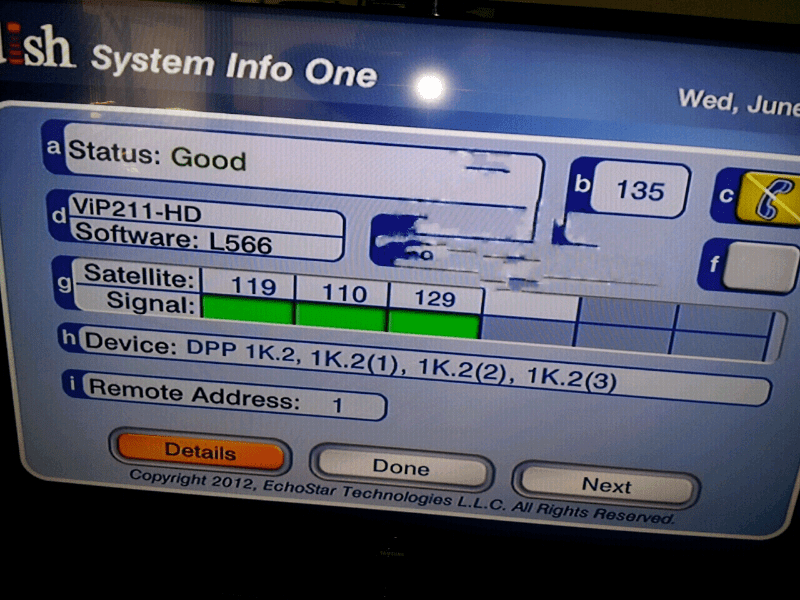

In my matrix 119 in in the middle. I ran a check switch test and I am Transmitting OK from 129 and 119 but not 110. I used to have all three. Any idea of how to get 110 back?
I think your dish is aimed too far to the west (9ish degrees) and the dish is looking at 119, 129, 139. Confirm this by covering the outer eyes w/ foil and you should only receive 129. Then move the dish over 9 degrees (and lower the elevation, I think).
Be very patient when moving the dish. I have noticed the receiver is slow to recognize changes to the dish aim.
A properly peaked dish to the western arc should look like this.
If 119 is in 1st position and 129 is in second position your dish is pointed to the right to far by 1 orbital (bout 10 degrees). Need to swing that Guy to your left a bit (while behind the dish). I know that's the system info screen and not matrix screen, but its the best I could find right now.
