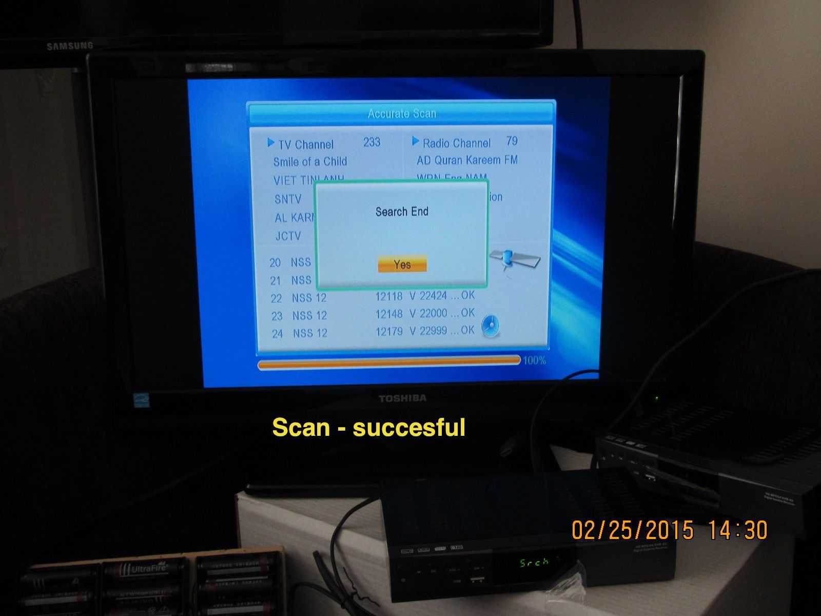

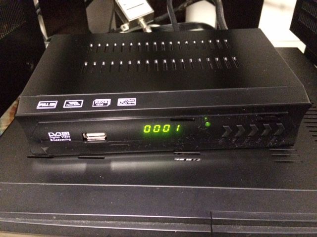

Both of 120 V receivers, ordered a few weeks ago, arrived today.
There are links in posts # 15 and # 20 for ordering. One receiver was sent from Guangzhou, the other from Shanghai. Both from China.
Photos follow :

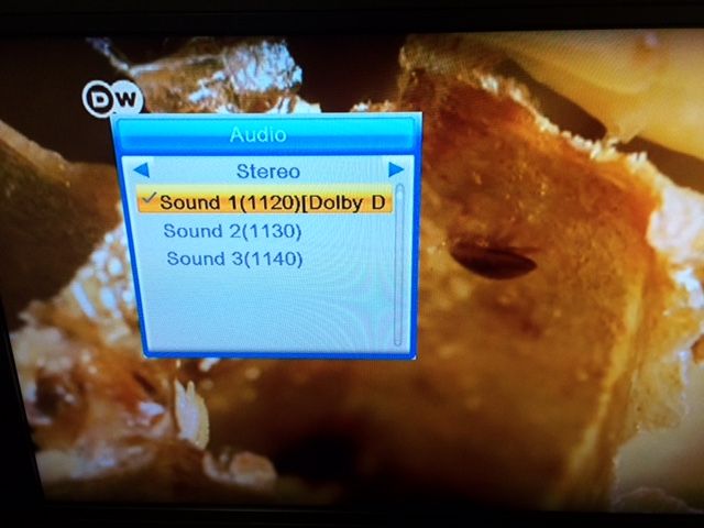

With this new receiver i am not getting any Audio on the ION HD channels on 103 w . I am getting Audio on the SD ION channels, i am using the HDMI cable to the tv. I try DW on the same satellite and the AC3 Audio does not work.
Any help will be appreciated .

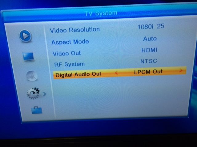

The receiver is set on LPCM still no Digital or AC3 Audio, Does any one else with the same receiver have the same problem. Thanks.

That chipset is available with and without Dolby license. Are other Dolby audio services decoding?

Is the AC3 being decoded by the STB or the TV? If you connect the RCA left/right to the TV, do you still hear the PBS audio? If so, the STB is the decoding device. If not, then the STB is not decoding.
I had to switch to HDMI to get it to work, as it didn't run on the RCA. It goes to a RF modulator so its definitely the STB doing the decoding.

If the audio plays with HDMI connection, but does not play with RCA connection, the STB IS NOT decoding the digital audio.
The RCA jacks carry whatever audio the STB is decoding. If the audio is present on the RCA connection (the modulator doesn't matter) then the STB is decoding the digital audio.

Correct, because these STBs have an on-board Dolby/AC3 decoder. STBs without Dolby/AC3 decoder must pass the digital audio out to an external device to decode. Many inexpensive STBs control the build cost by sourcing the hardware without decoder.

True, you just discovered serious flaw of this cheap receiver.
I scanned 125 W with two 120 V receivers, and found out, that only Montana and another TV has audio, as they are not Dolby.
All other programs, (including Create), which use Dolby, do not have sound on these receivers.
