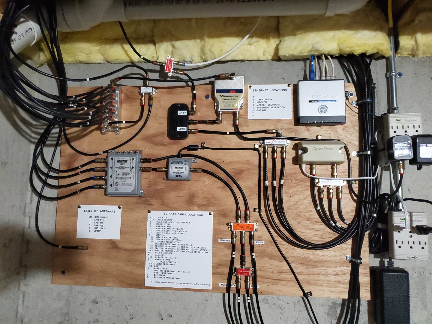

I've used a Duo Hub for seven years now connecting my two Hopper 3s. Works great, no jumper cable needed. Both Hopper 3s can see each other.
I knew someone had done it but couldn't remember who.
