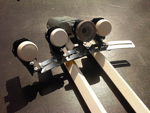

I Thought you had to use the special Alaska Hawaii LNB with that dish to get the focus right?

I'm still waiting on some company to make a seperate KA LNB's with a combiner, they have a set-up available in Europe:

You are right - I am using the Alaska Hawaii LNB like the one shown in your picture, not the sl3 lnb. I costs more but is very easy to mount.
I get the 110/119 channels on a Slimline SL5 dish and have it connected to the receiver no. 1 on my HR23. The Alaska Hawaii dish is connected to receiver no. 2 for 99/101/103 channels. With any other setup I get "channel Guide" issues.
