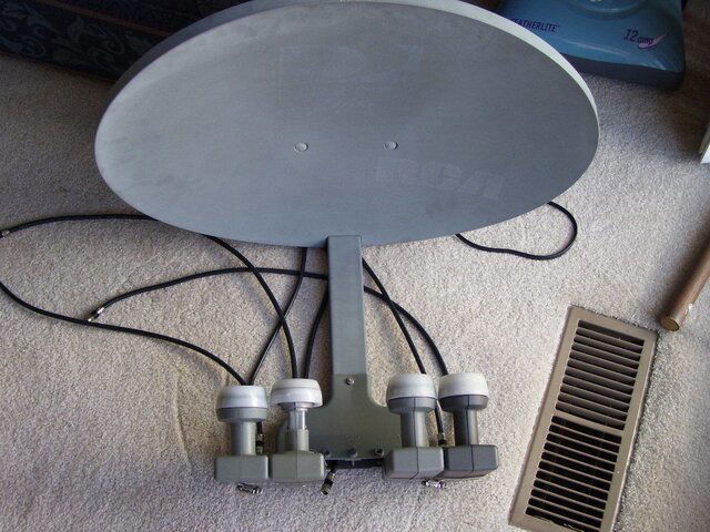

Its the Phase III then, the LNB has 3 "eyeballs" on it.
Phase iii
phase iii @ Icebergs house

Since you have a Phase III then set it up in the sat setup for "3 LNB" (2nd option if I remember right)....then it will see the proper satellites and work fine
menu
setup
system setup
satellite
repeat satellite setup
it says "press - to confirm" then kicks you into the screen
Since I have a SWM setup I cant change the settings so I cant get into that menu to see but I think its 2nd option (1st option is a 18" only dish so its gotta be the 2nd option)
