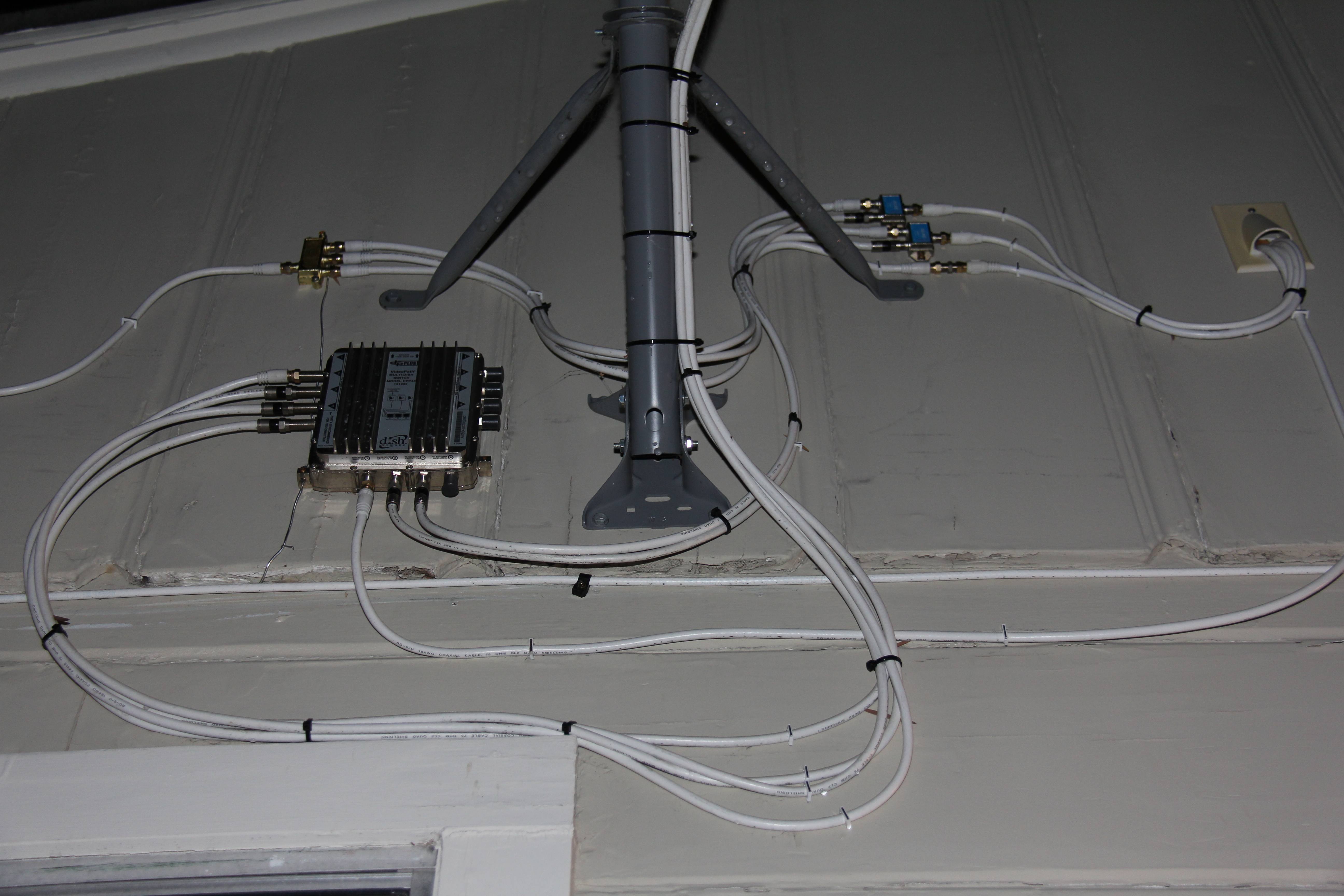

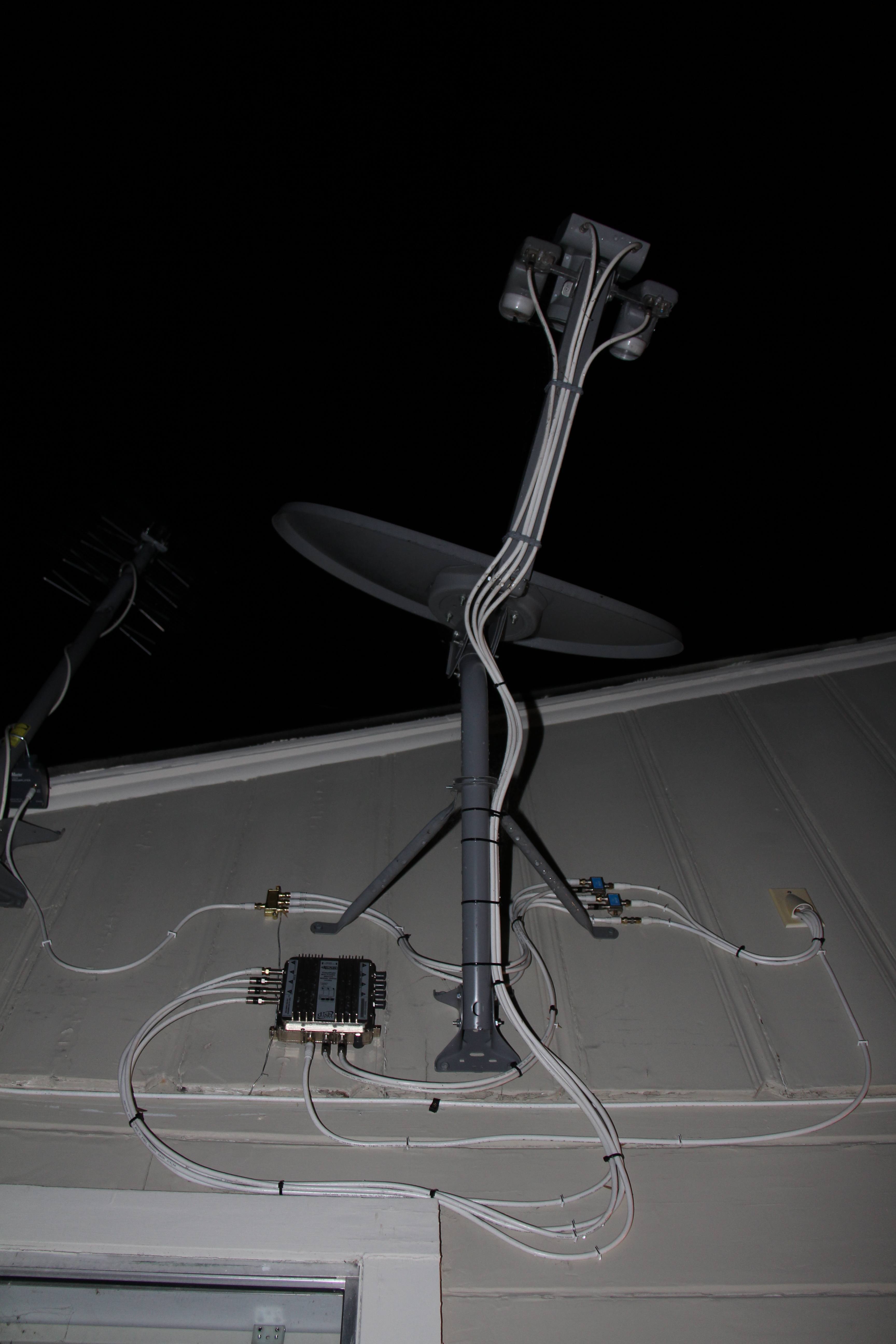

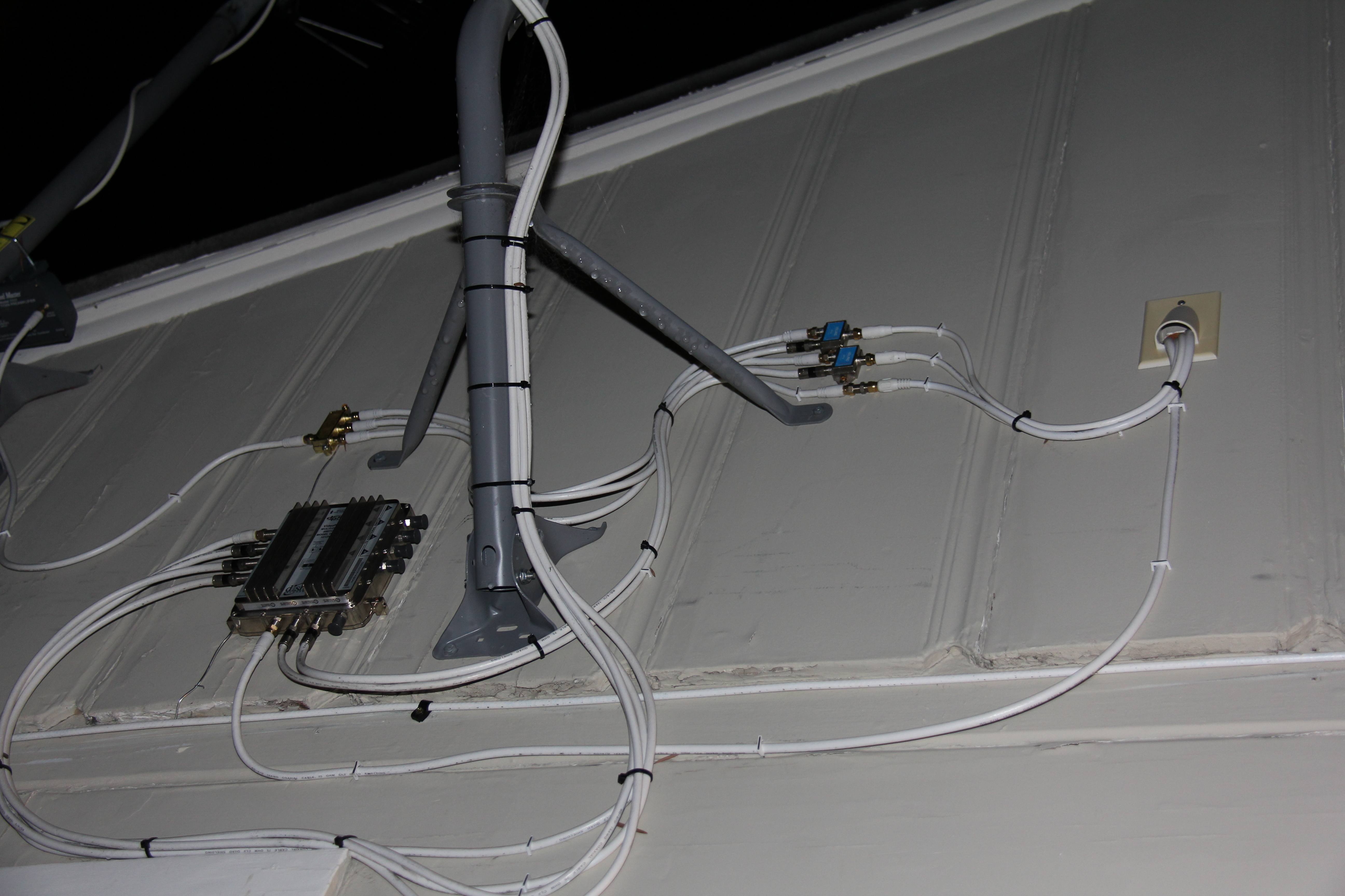

No doghouses in my install. (And, I don't pay for anything upfront. Local vendors just don't do that around here.)
Maybe no dog houses - but it would still fail an internal DNS Quality check on multiple fronts: Only 4 lag bolts in the footplate (this alone is enough to fail, you need 6), improper grounding (Al wire not approved, the shiny DPP44s are not approved GBs so GBs must be installed between dish and switch, the mast/footplate is not grounded, can't verify ground source from pic), non-approved cable connectors (the black/silver PPCs are fine, the pre-made cable ends are not), some picky QAS might hit you for no service loops and improper cable clips too, but most wouldn't since there are no drip issues. All-in-all I could have your install up to code in about 30 minutes though, it's not terrible (assuming the ground source is approved).
The noob means well, Gary. However he's not as familiar with people here who install and maintain their own equipment.
No probs. You and I both know it's a perfectly fine user install. I've never lost signal in this, or my previous 3, homes. Good signal strength, too. And, nothing has ever fallen off, either. (If 4 bolts in the base, plus 2 on the tie rods, can't hold it to the side of your house, there's something wrong with your house.)
What's with the premade made coax? No way in hell I would use that for any of my equipment, not even to hook up a VCR.
I use quality premade all the time. Have for years. Works fine. Of course, if I was installing for a living, I wouldn't. I'd be pulling from a box, and crimping, obviously.
<img src="http://www.satelliteguys.us/attachment.php?attachmentid=74188"/><img src="http://www.satelliteguys.us/attachment.php?attachmentid=74189"/><img src="http://www.satelliteguys.us/attachment.php?attachmentid=74190"/>
Change out a few lag bolts to meet spec and a few of those non outdoor connectors and I'd leave this the hell alone. Excellent for a diy.
It definitely wouldnt be a big pita.
just wasted time.

I could get signal using a pie tin if I really put the effort into shaping it... Fact is though the standards are over the top and harm more then they help: they're there to protect you guys. From poor work. If you're too proud to realize it is a blanket standard with little to no exception you are missing the point. We don't enjoy the extra unpaid work. We loathe it; but it still serves to protect your investment. The majority of you do not have the means to tell a length of cable has a fail somewhere in the stinger nor that an lnbf has drift. So as I said; do the installation as you see fit but do not expect a DNS tech to bring it back up to code when he comes out. Or to work on it at all without compensatiion. We do this for a living.
